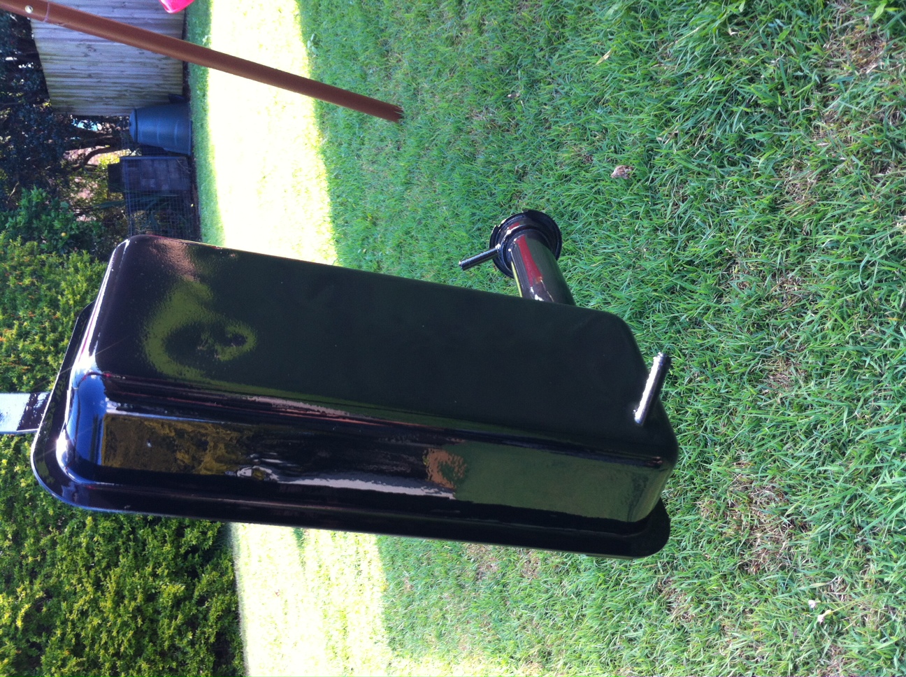

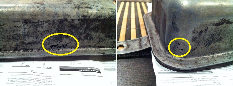

Well I can safely say, soft soldering is not as easy as I thought it would be!! I got there in the end but it too a few hours of prep and practice.
After cleaning it up, these were the sorts of holes I was left with:
I read you could use sand and distilled water to basically wet sand the inside of the tank and remove any rust. I gave this a go and it worked great.
I then rust killed the entire surface and primed the part I wasn't going to be soldering
Then I soldered the many, many holes and grinded/filed back the excess metal.
And lastly painted it up in rust gaurd gloss black. Didn't come out too bad in the end!
Now onto my next task of flushing the radiator out...
