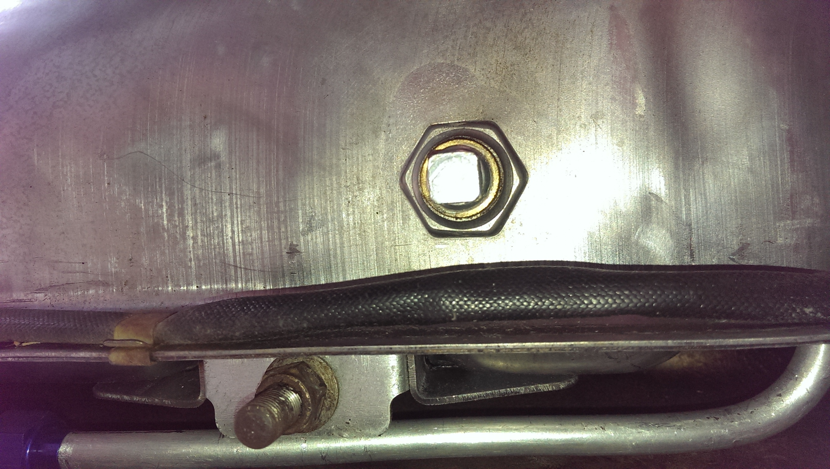

Stop putting band aids on the real problem .. old rusty tanks.
If you actually change out those tanks that are now 30-40+ years old, using replacement tanks gets you one small drain plug. No strainer access nor a strainer but tanks made out of coated modern materials..
Nothing wrong with just getting rid of old rusty tanks every three or four decades... you end up with nice new shiny tanks with no rust... see the photo for the new drain plug.
