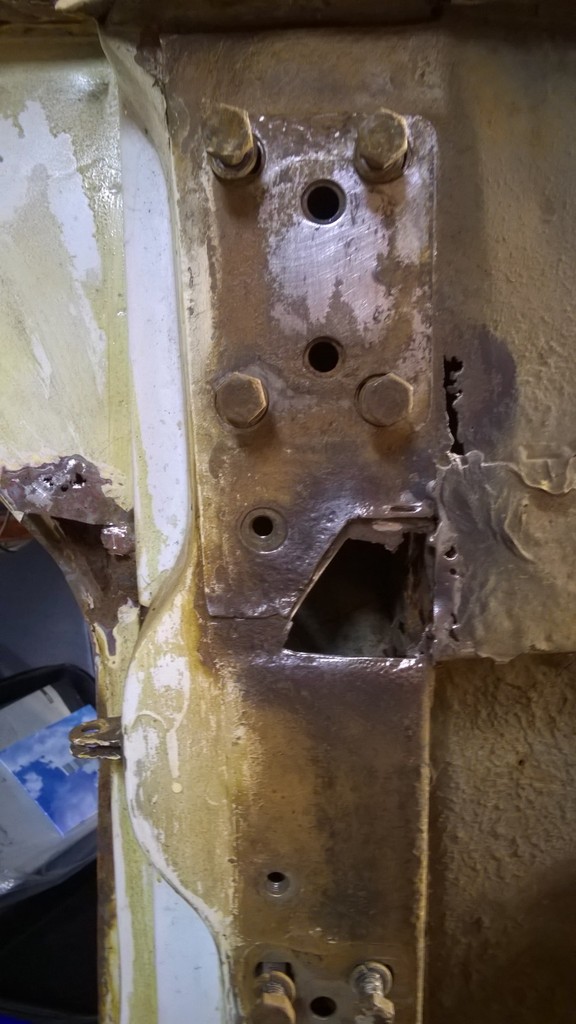

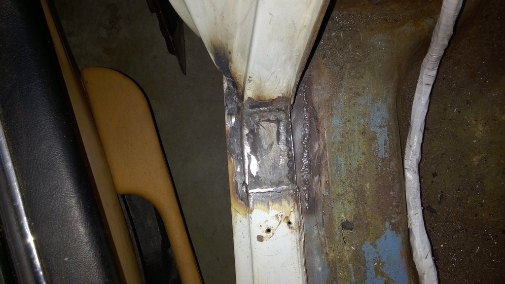

So, lots of progress here, but unfortunately not that many pictures. I have fallen into an extensive restoration of the xj6!
The radiator is back in and wired up. Technically it is driveable. but as I have such a great working place, I decided to do a bit more. Took out the windows and doors, took out the entire wiring loom...
and now I am rebuilding it. Cutting out rust, welding in new solid steel. I love it! I gotta feeling it is gonna be much better than when I bought it. I promise to make pictures next time. For now I have only one of the front pillar. Cut out some rust...
Put some solid steel back in and is finished already. Working my way throught the entire car like this!

Can't open the piccie though.
Old Oct 27, 2015 | 06:38 AM
  #166
Wilfred88's Avatar
Joined: Aug 2013
Posts: 309
Likes: 197
From: Groningen
now?

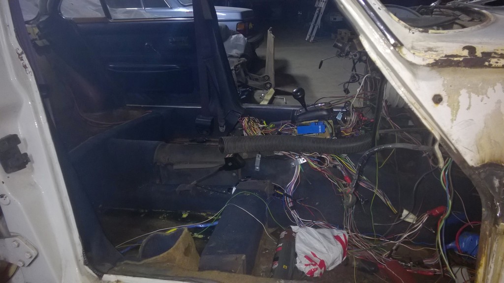

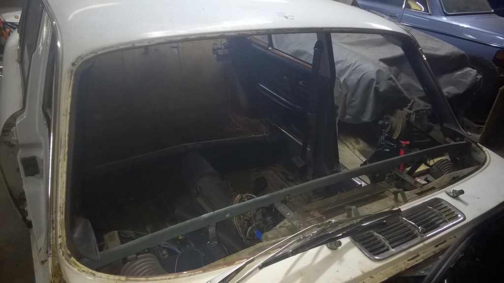

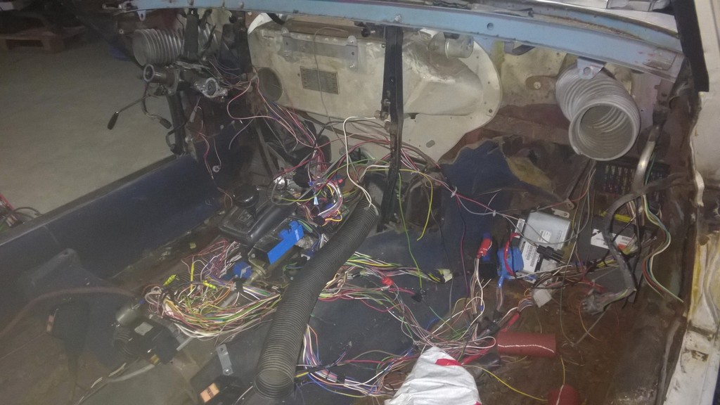

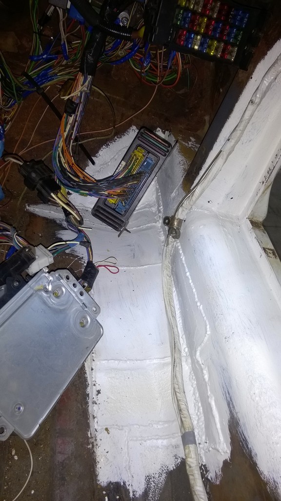

Finally, some updates. See for yourself:
What I did:
- empty interior
- fabricate a completely new wiring loom
- weld rusted spots/holes.
it's work in progress but I'm getting there.

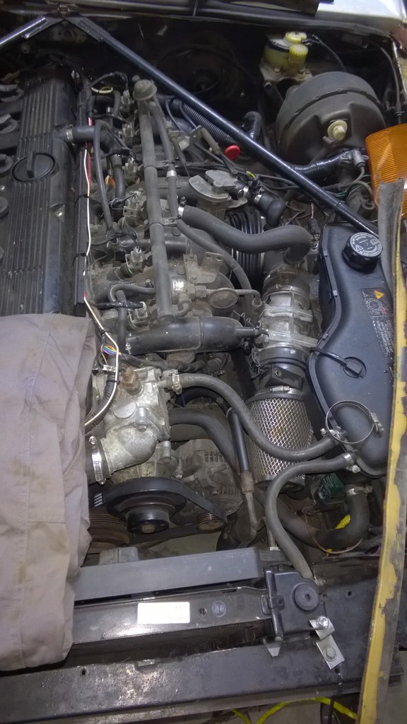

Damn you've got perseverance! Hey find a way to replace that oil cooler with the factory leaky hoses so you won't have oil all over that nice engine bay! Even brand new factory hoses start weeping in short order, and removing old ones from the oil cooler usually removes some of the threads off the cooler making it unusable. I'd love to make some nice hoses and fit an aftermarket cooler, any ideas?

Ah.... the leaky part is coolant. Just a loose clip. Fixed already.
The oil coolers (gearbox and steering) are integrated in the radiator. There is no seperate engine oil cooler...

The wiring loom looks like a nightmare to replace. From experience, the old one is not good enough for any car, certainly not for a car like yours. I'd like to do everything as good as possible on my car because who wants to be that guy that does his job poorly? When finished, you can be proud of the car, I would be.

The wiring has already been replaced. Just needs to be wrapped up but I want to wait till I am sure I got all the wires. Happened way too often I taped it all, just to find out I wanted to add a single wire.

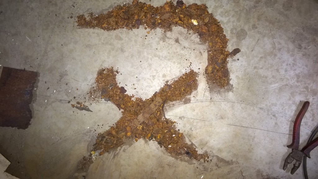

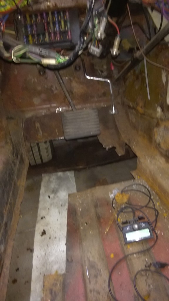

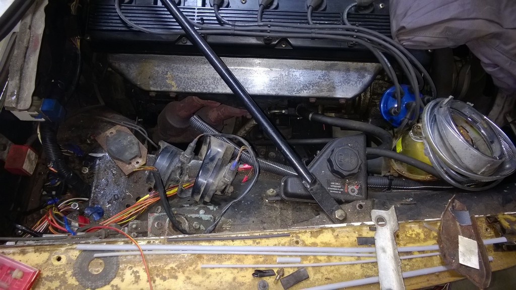

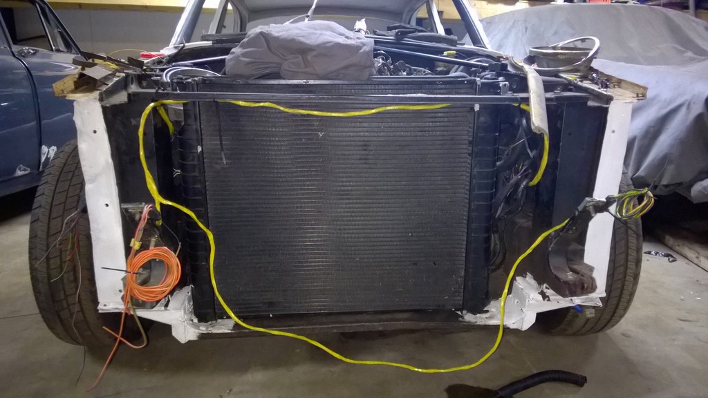

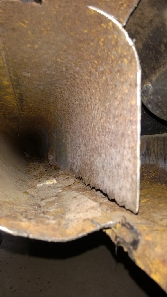

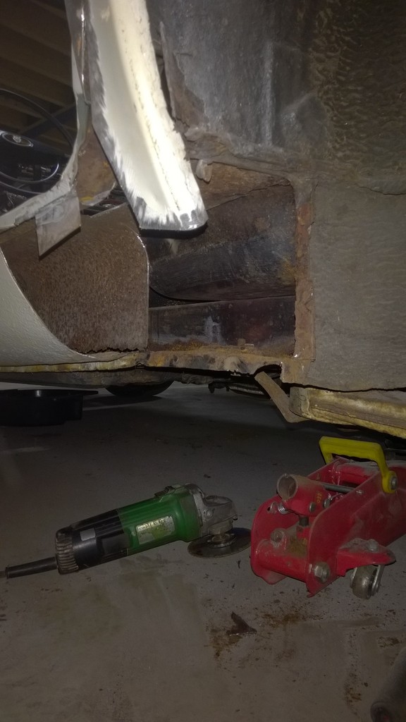

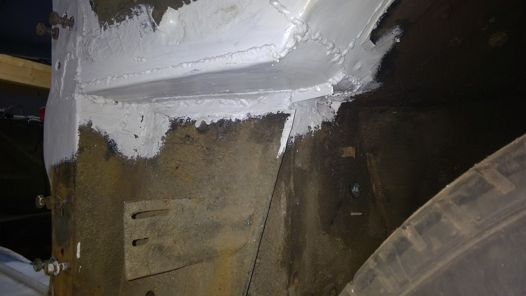

so, the passenger side of the car is solid again!
now it's up to the driverside. Problem points: bottom area of the A and C column.

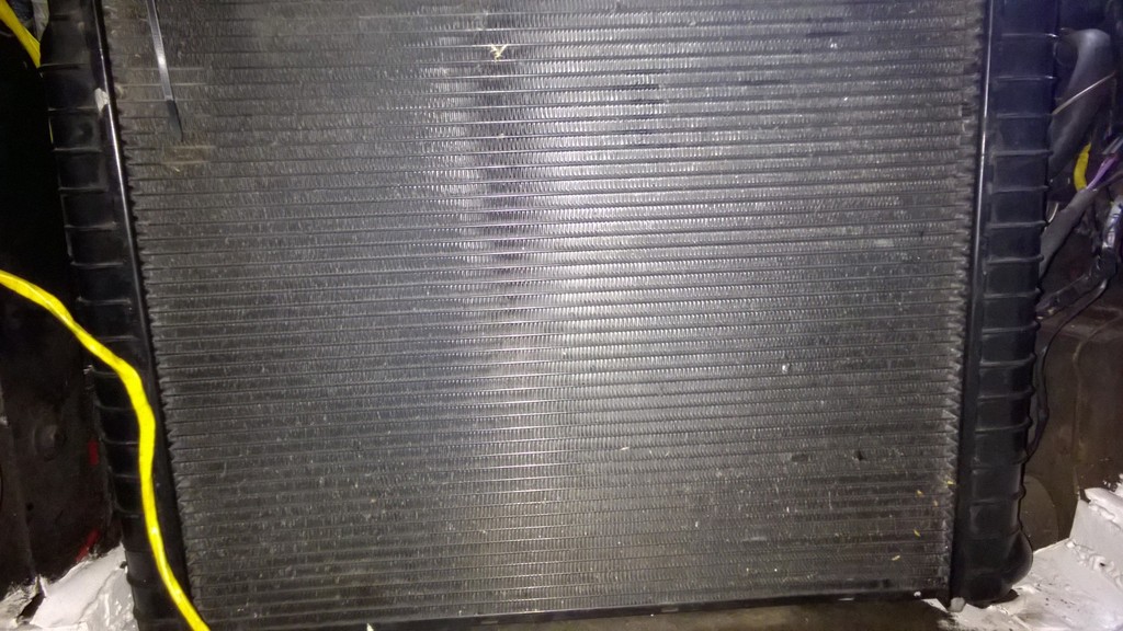

And I removed the airco radiator. I don't like it, was leaking and I could use the room for alternative fans (originals are broken and I dont like em.
