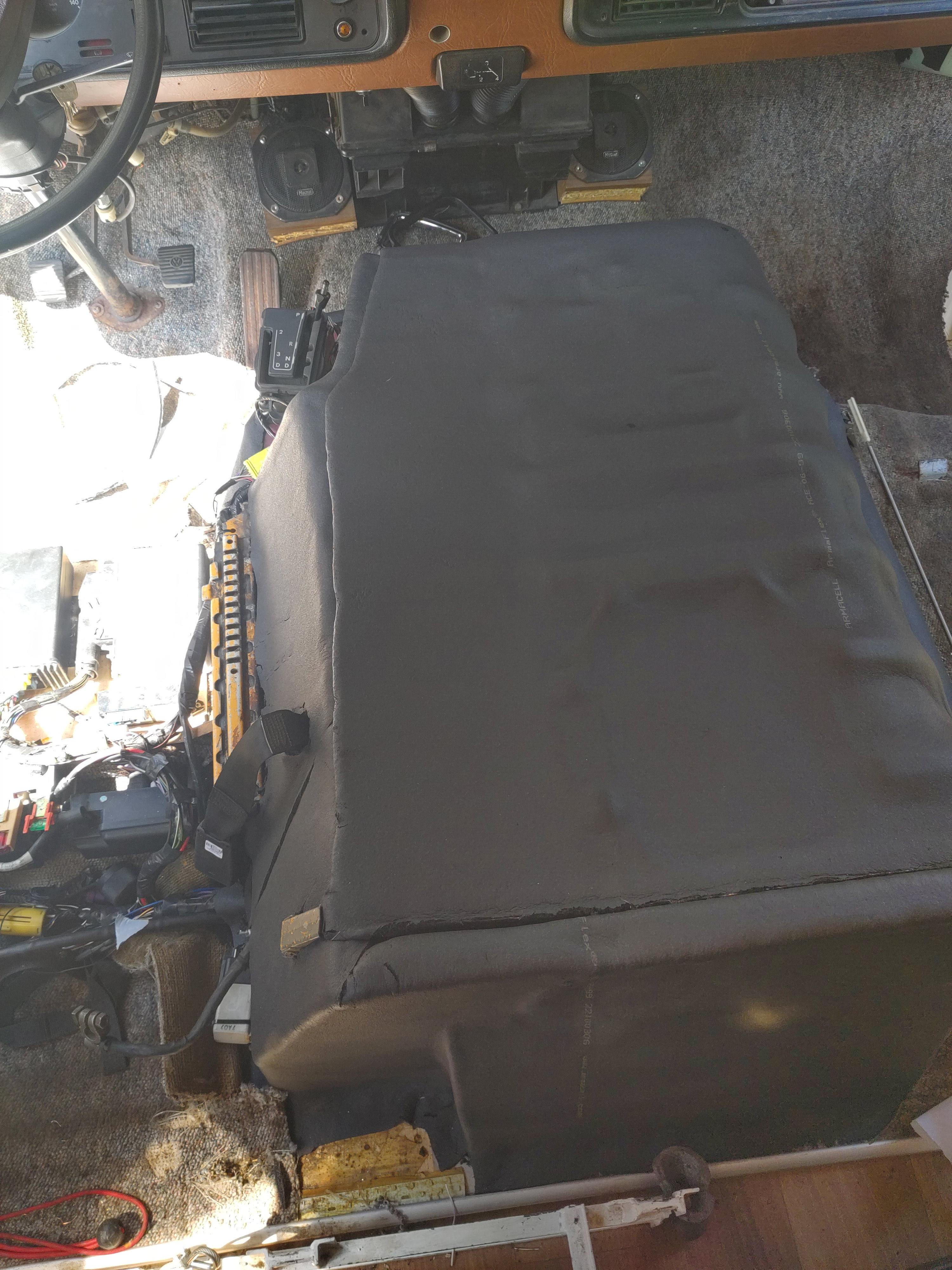

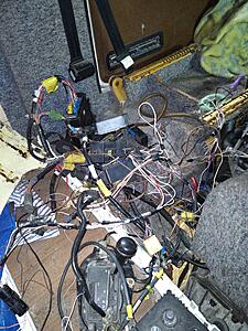

still going well here. Lot of work done, but not interesting to share. Connecting hoses, lines. making brackets etc.
but now all in in place. only wiring needs to be integrated. it does crank, doesn't start as there is no fuel in the tank yet. Hopefully I will have time to get some fuel tonight, and fire it up!

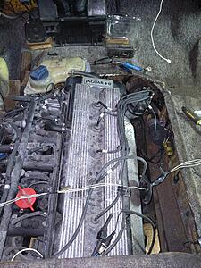

It's alive and drove under it's own (jaguar) power!!!!
all seems well, only the idle is high. 1200 at idle (roughly) and it drops when I put it in gear, but not as far as it should, when in gear. anyway, pictures first:

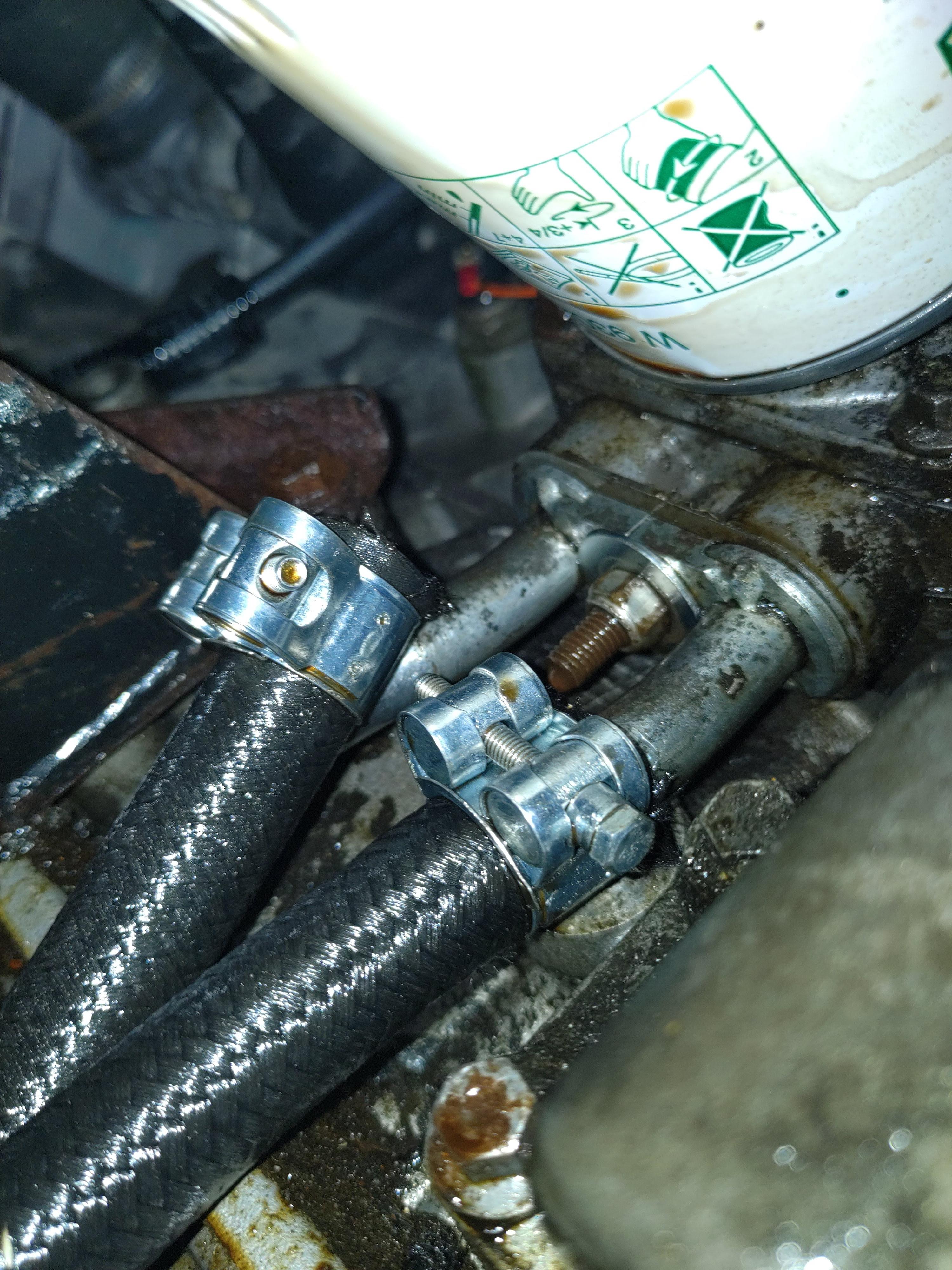

2. The oil pressure light came on... And you may guess why:
yep, the line blew from the oil cooler connection. Why? I simply forgot to tighten the hose clamp.... As soon as I saw it, I was like 'o yeah, that was one of the things I stille needed to check and tighten....'
