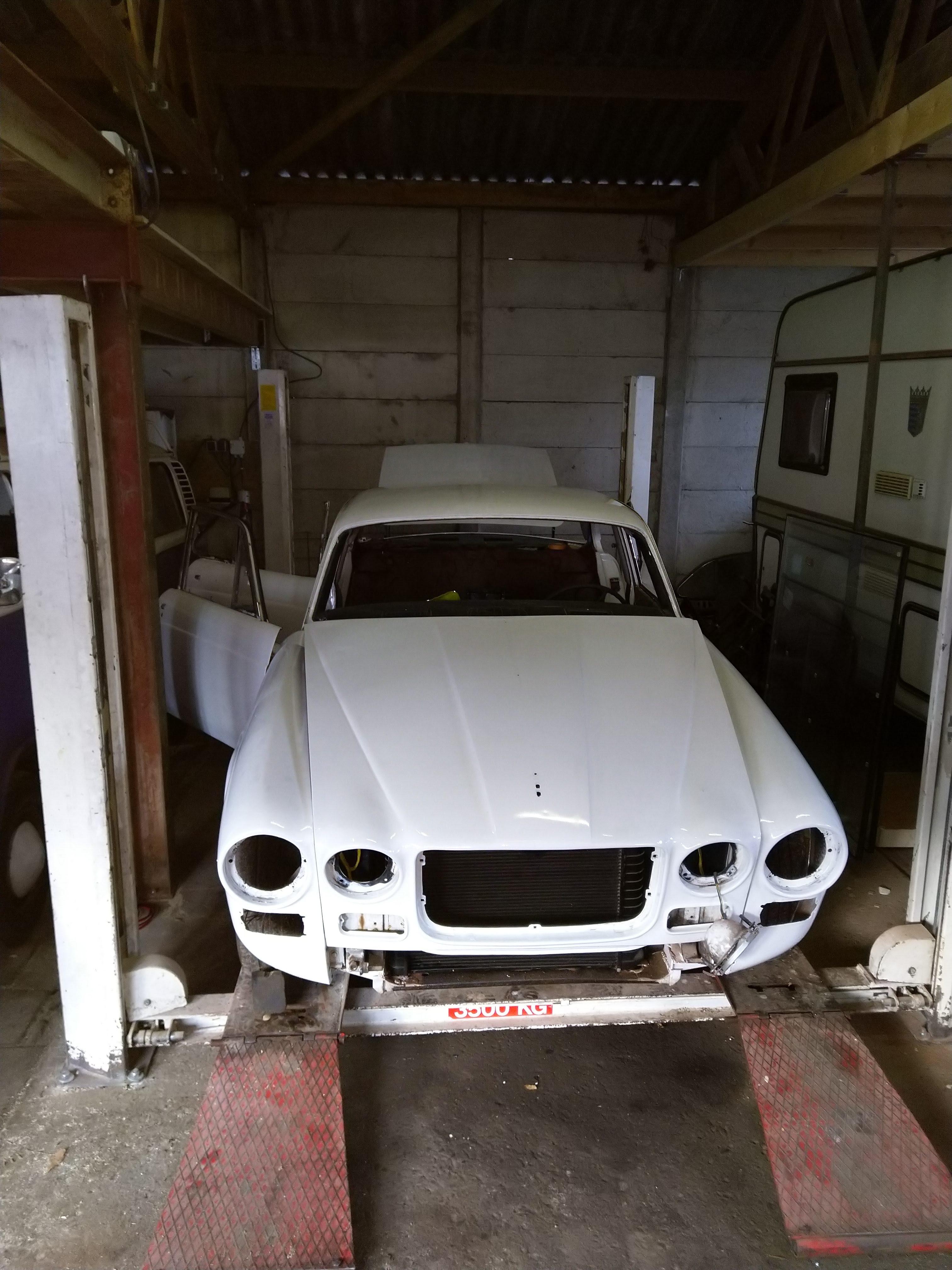

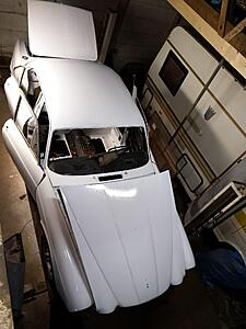

So, thats been a really long time. I quit working on the jag, because I bought my first hous. Which was a ruin, and resulted in 4 years of building. While also having 2 kids at the time and starting my own business. With all that sorted, I really wanted to continue working on the jag. It sat there, as I left it 4-5 years ago. As shown in my previous post in this thread. Although I had moved it to my own workshop, as the house came with a huge workshop! I put a lift in it. And now the time has come...! Get the jag back on the road againn. As I left it years ago, I had welded all the bad spots and completely rewired it. Now what I neede to do, was paint it ant put it back together:
I painted the thing, with a roller, but honestly the result is really good. Especially when considering it's only a few degrees above freezing in the shed, and Paint doesn't flow that good when cold.
This is how it looked during painting:

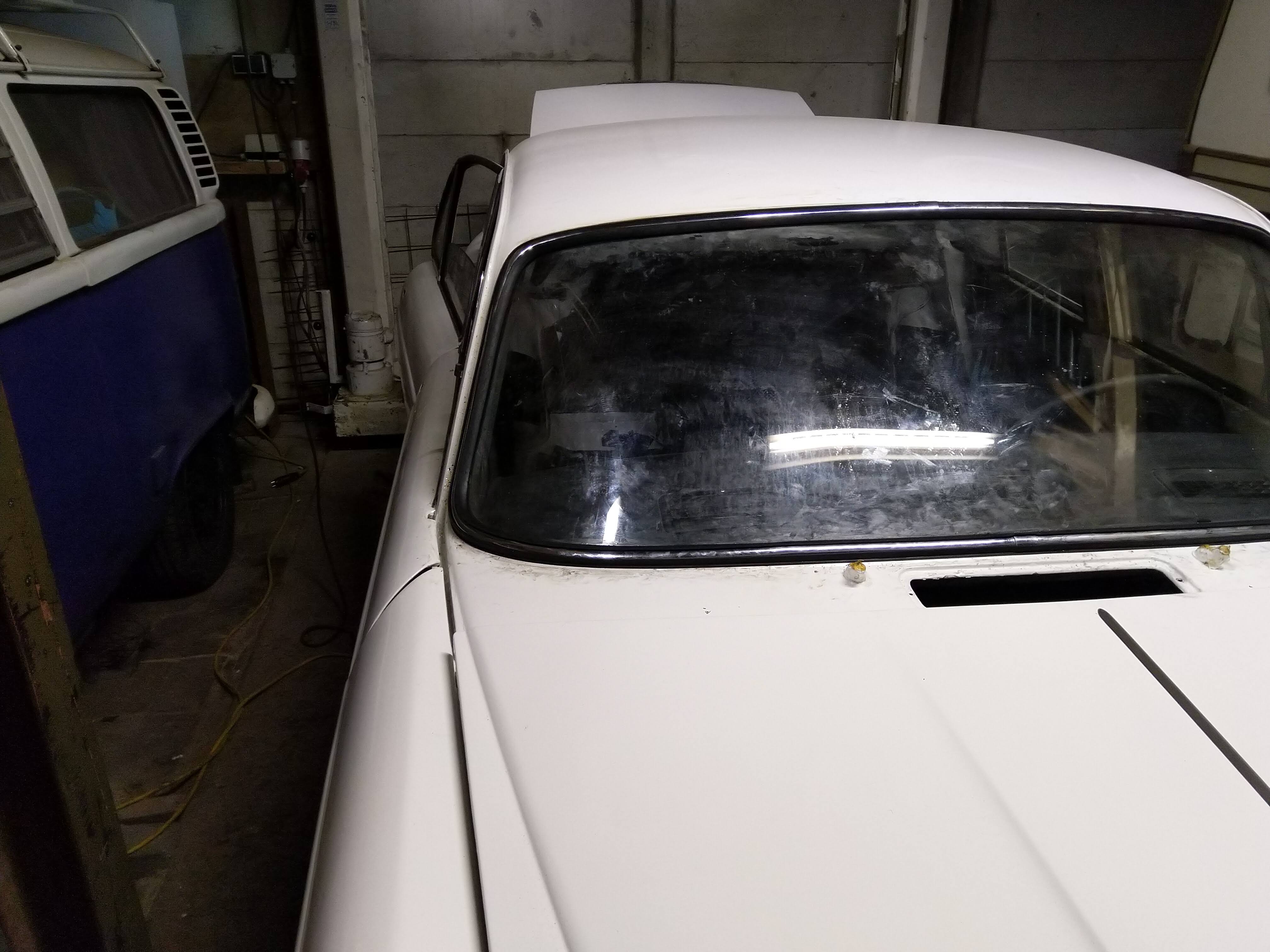

Mounted the windows:

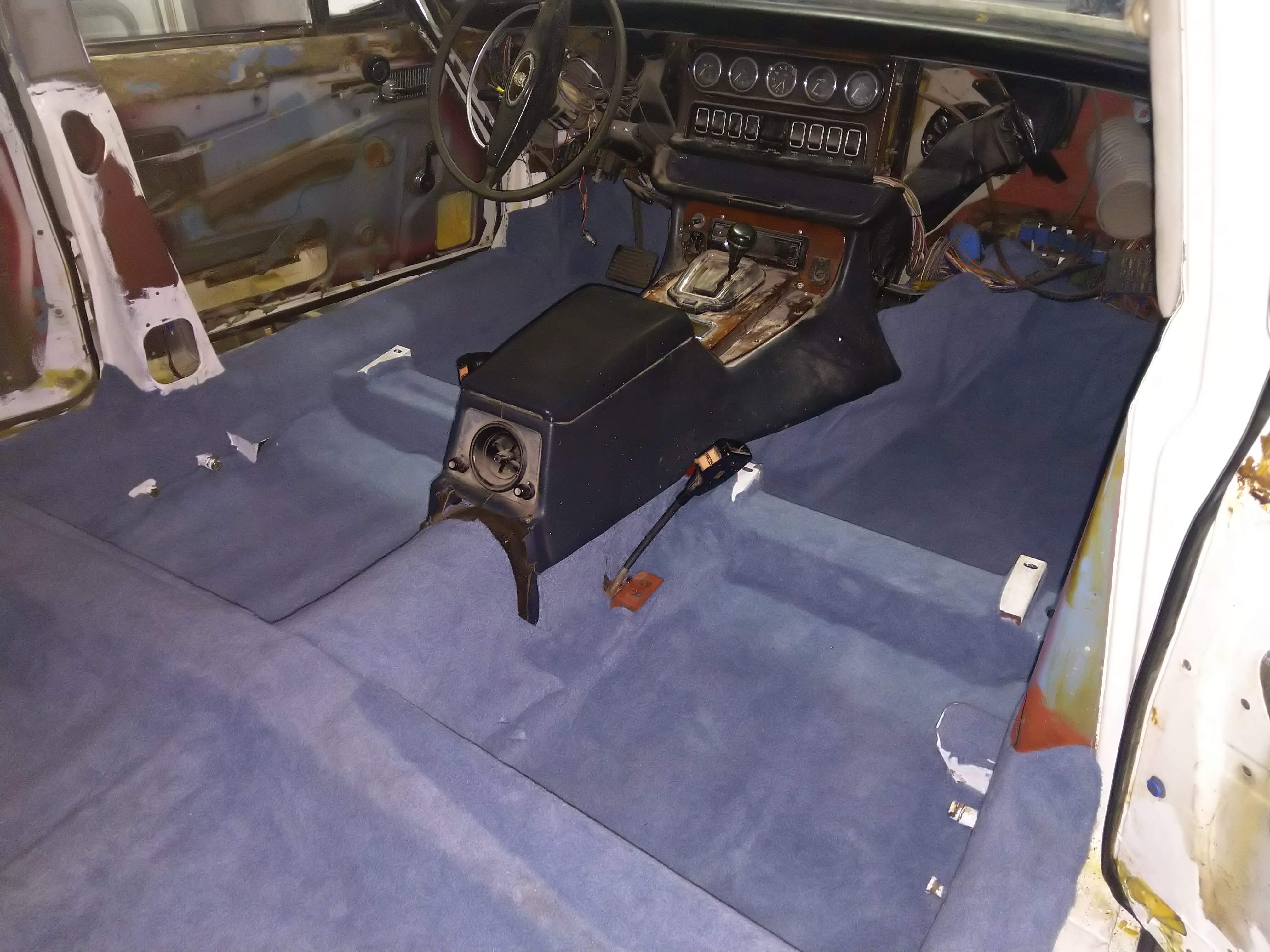

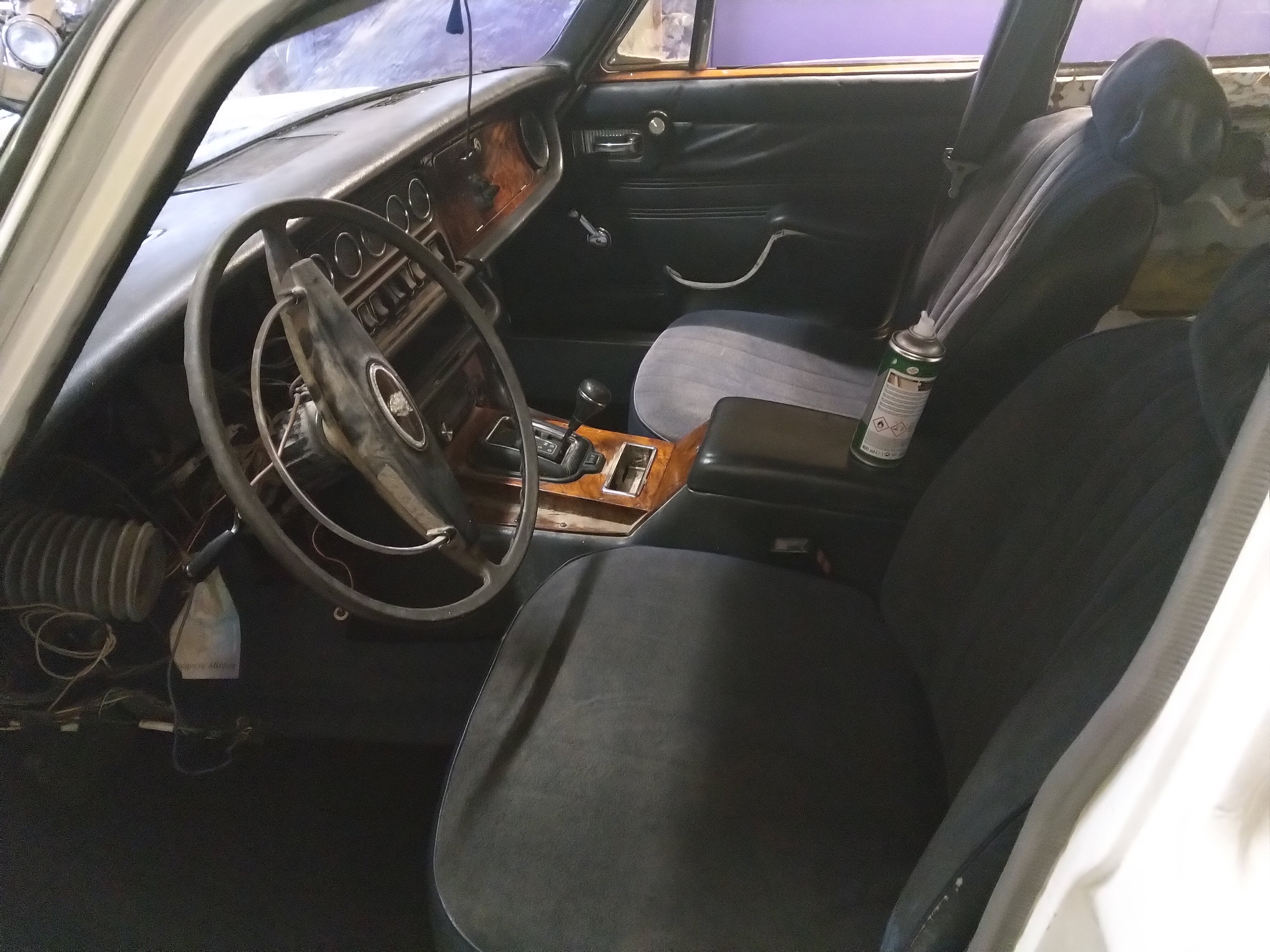

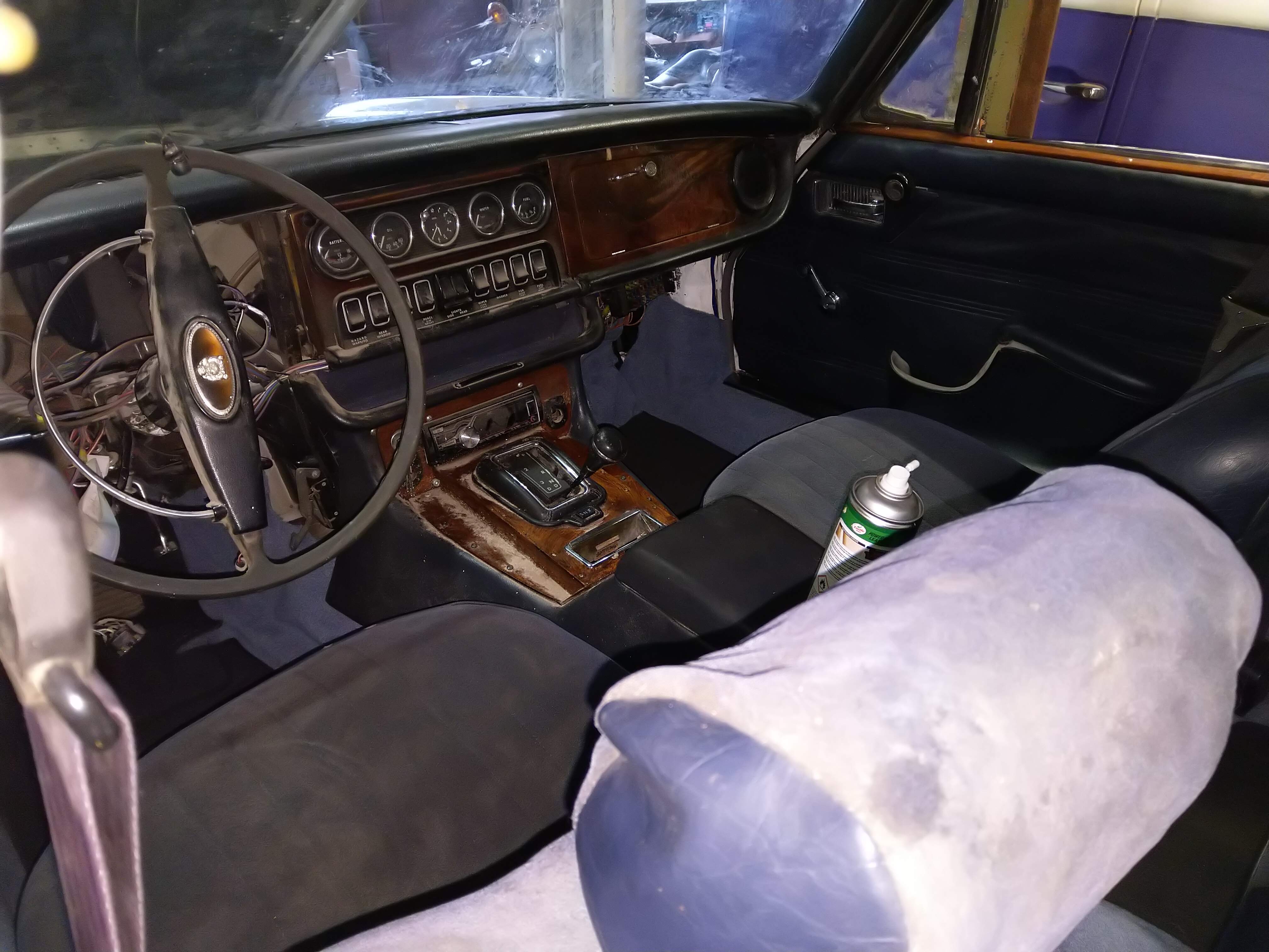

put some carpet inside:
cleaning seats

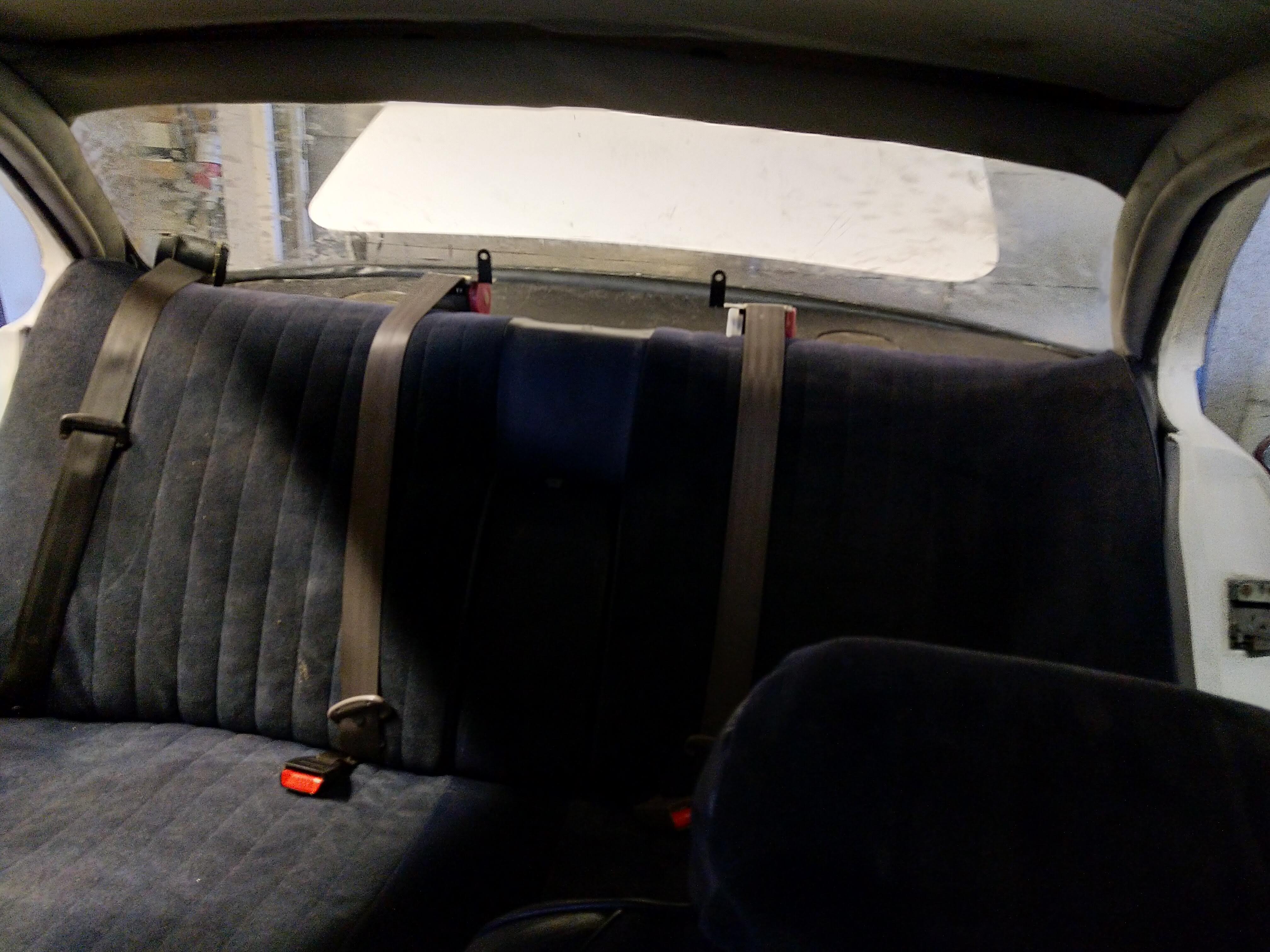

put rear seats back in, AND mounted 3 point seatbelts in the rear, for the kids. 3 belts in total
and started putting everything bak in, inside..

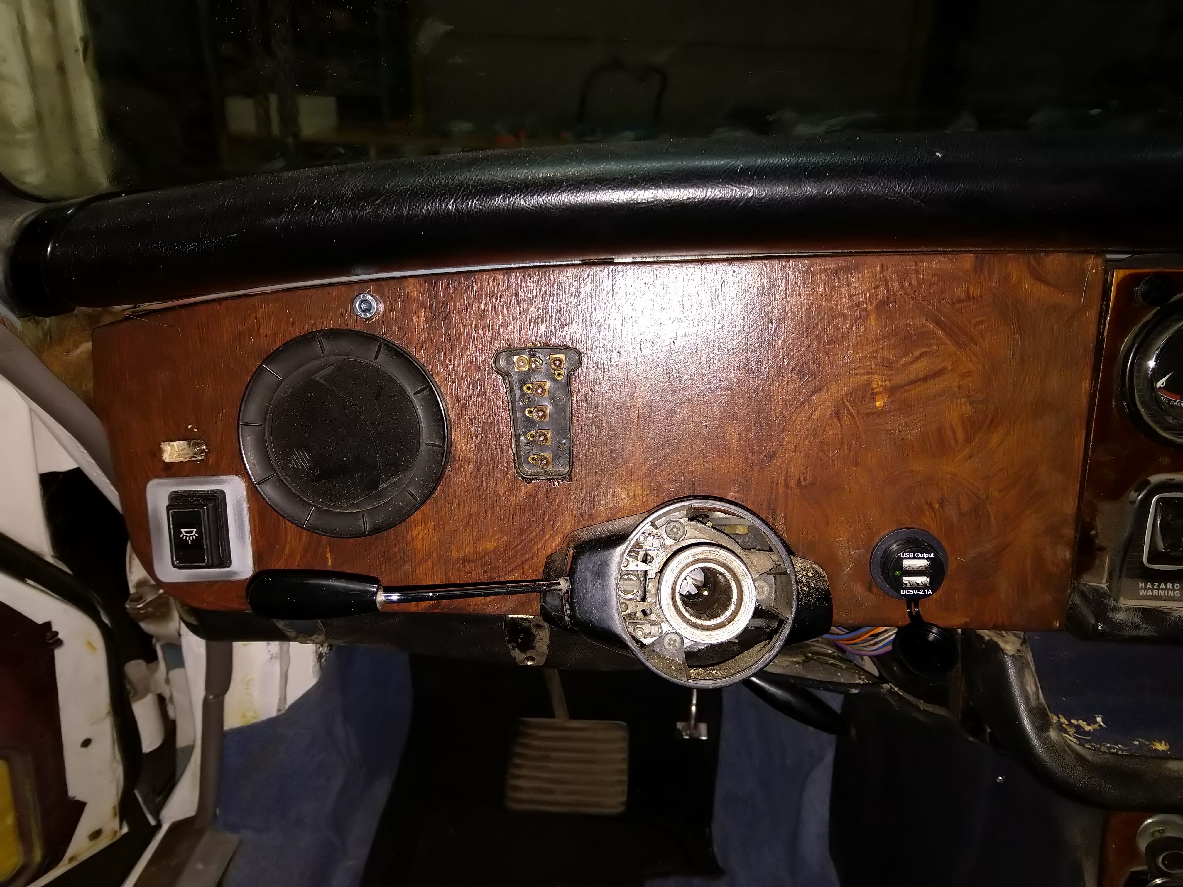

nearly done. Only doorhandels and doorpanels left.
also made a nieuw piece of dashboard, as I didn't want any gauges anymore. only a big screen with speed and navigation in on.
When temperatures get above 0, I will make the first testdrive. I don't want to break down and freeze me *** of... :-)

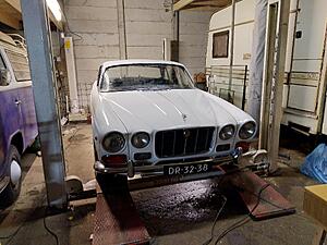

Made the first drive in 5 years!!!

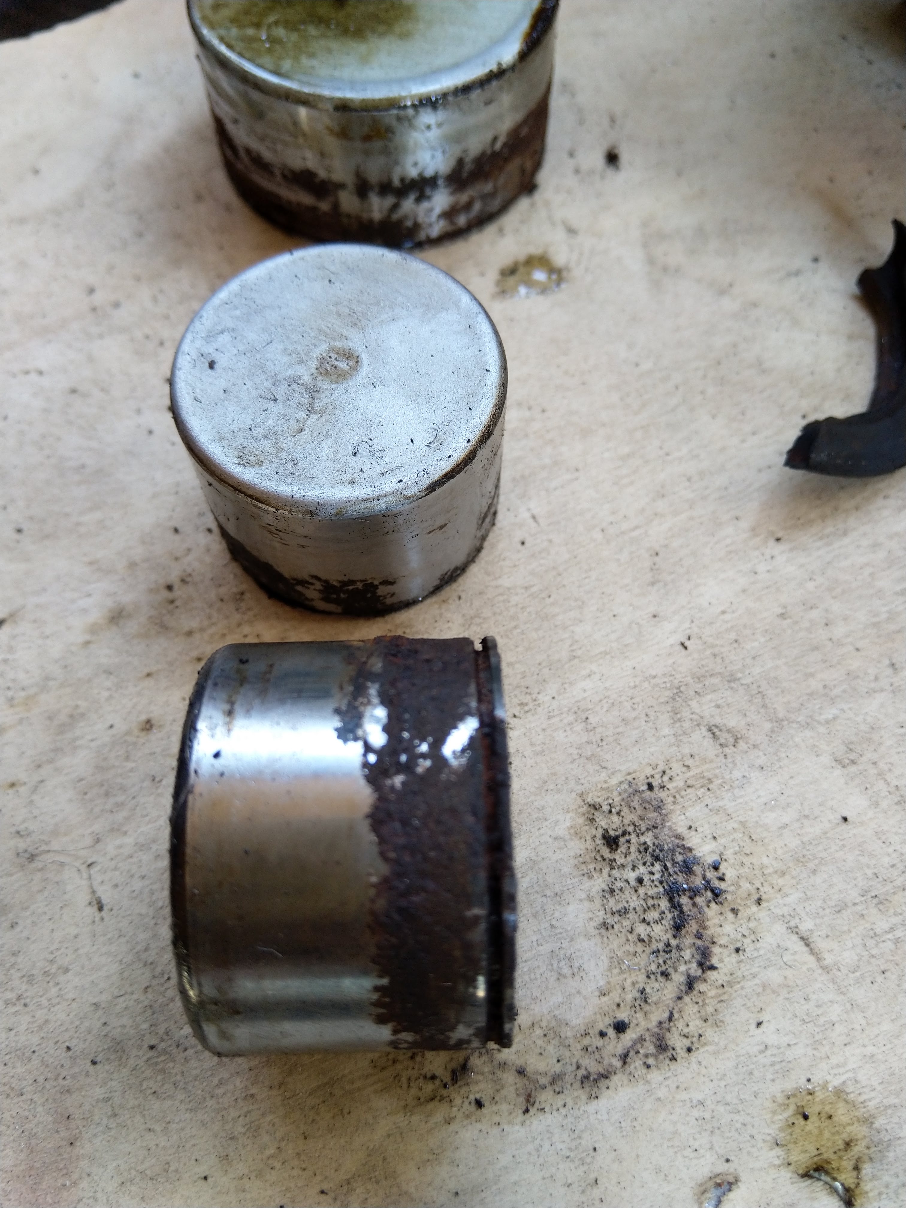

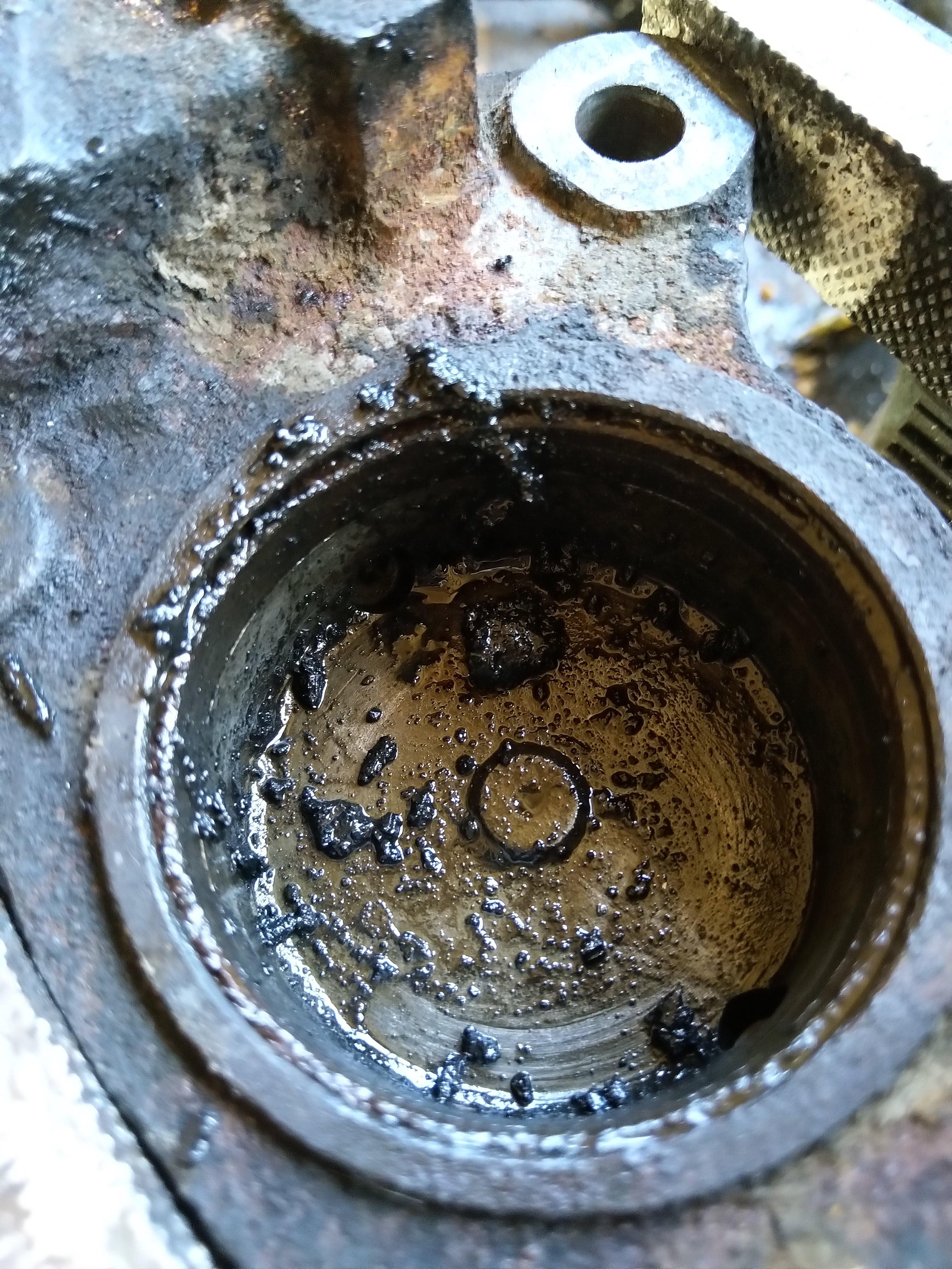

However, I noticed the brakes were poor. To say the least... Turns out the front breaks were locked solid. I even hat to drill a hole in the cilinders, and thread these hole to then turn the cilinders out with a bolt. Oh, and the brake fluid in the calipers was more like a paste. More solid than liquid...
But whet all new seals and new cilinders, the brakes are fine again! Next drive to come shortly
Cilinders were very rotten...
But it all fresh now. And already back under the car and bled.
