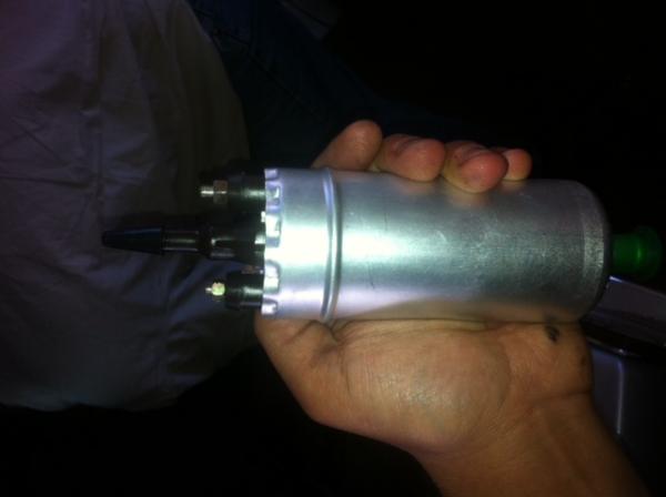

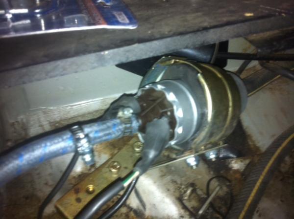

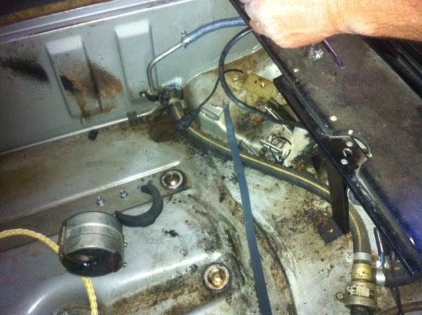

This problem is resolved!
The problem in the end was the fuel pump. Doug was correct, the fuel was leaking from the fuel pump, going through the spare wheel area and pooling elsewhere causing the drip further forward on the car.
I've never seen anything like this, the fuel pump was leaking out the side! Not out of the pipe connections. Shown below in red:
The new fuel pump:
Work in progress:
New pump in place:
