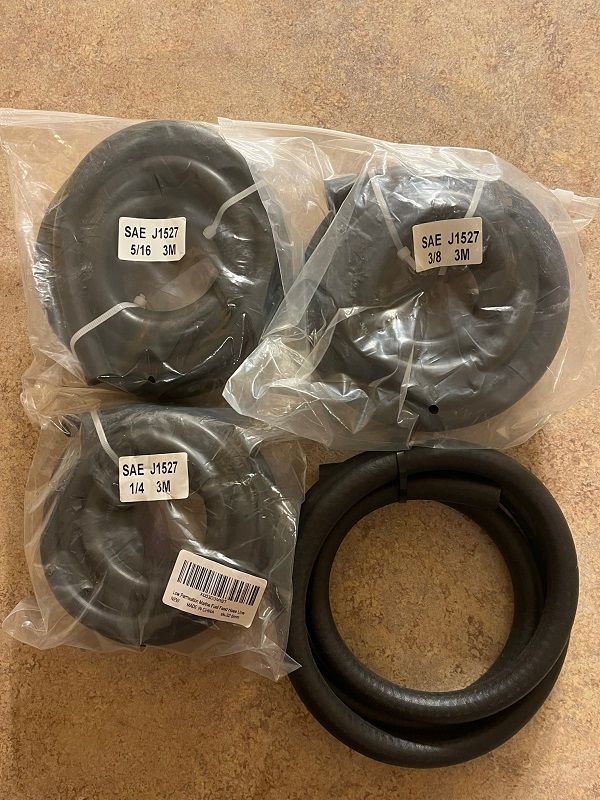

I just ordered all of the hoses to do just this. Buy SAE J1527 Standard A1-15. This is very low permeable hose designed for marine applications where fuel vapors are more deadly than those in our trunks. The 7/16" hose doesn't need to be injection rated as it only supplies the pumps with fuel from the tanks, all the other lines need to be injection rated.
I found all of mine on Amazon. I did have to buy more than what is needed, but still not overly expensive
Amazon.com: 5/16 Fuel Line Hose Rubber 10ft SAE J1527 Standard A1-15 Type for E85 Gasoline, Oil, E10 Biofuel, Diesel Fuel, Lubrication Oil on Boat and Marine : Automotive Amazon.com: 5/16 Fuel Line Hose Rubber 10ft SAE J1527 Standard A1-15 Type for E85 Gasoline, Oil, E10 Biofuel, Diesel Fuel, Lubrication Oil on Boat and Marine : Automotive
Amazon.com: 1/4 Fuel Line Hose Rubber 10ft SAE J1527 Standard A1-15 Type for E85 Gasoline, Oil, E10 Biofuel, Diesel Fuel, Lubrication Oil on Boat and Marine : Automotive Amazon.com: 1/4 Fuel Line Hose Rubber 10ft SAE J1527 Standard A1-15 Type for E85 Gasoline, Oil, E10 Biofuel, Diesel Fuel, Lubrication Oil on Boat and Marine : Automotive
Amazon.com: 3/8 Fuel Line Hose Rubber 10ft SAE J1527 Standard A1-15 Type for E85 Gasoline, Oil, E10 Biofuel, Diesel Fuel, Lubrication Oil on Boat and Marine : Automotive Amazon.com: 3/8 Fuel Line Hose Rubber 10ft SAE J1527 Standard A1-15 Type for E85 Gasoline, Oil, E10 Biofuel, Diesel Fuel, Lubrication Oil on Boat and Marine : Automotive
Amazon.com: PRO 1 Fuel Line Hose 7/16 Inch Inside Diameter X 5 Feet Length NRB/PVCC SAE30R6 : Industrial & Scientific Amazon.com: PRO 1 Fuel Line Hose 7/16 Inch Inside Diameter X 5 Feet Length NRB/PVCC SAE30R6 : Industrial & Scientific

The hoses I ordered off Amazon all came nicely packaged with the hose size marked on each baggie. All except the 7/16" hose, but that came from a separate vender.

Are these hoses all Low Permeability ones? I'm having a heck of a time sourcing these items, especially the 1/2" one. Can you post the amazon links if its not too much to ask? I'm sure lots of us would appreciate such a listing. I have all the hardware - new pre filters, FI clamps, shut-offs etc., but having trouble with the hoses. Ian

Yes, all of these except the 7/16" hose are SAE J1527 low permeable hose. The 7/16" hose is low permeable, but not rated for the higher pressure as required for fuel injection as it only supplies fuel from the tank to the pumps and does not need to be high pressure. You will be buying more hose than you will need as I couldn't find where you could buy each of these by the foot.
