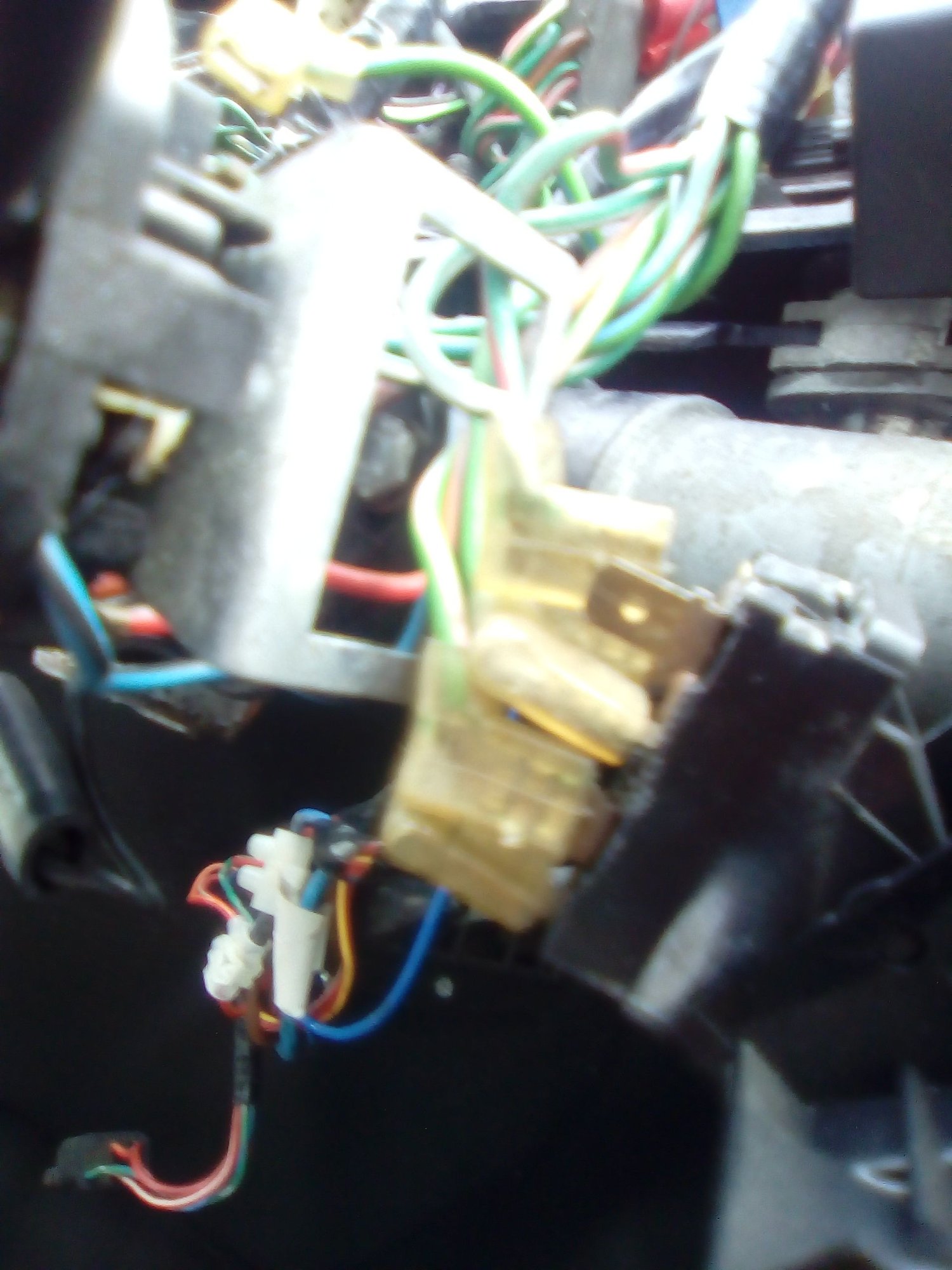

my picture is blown out and so retracing my indicator/hazzrd links is not that easy.
four pins at top of the switch then three below, seven total, i name them clockwise in block 1 A, B C D and then clockwise in lower bock E F G.
my candidate wires green/blue, green another green/blue, green/red, green/pink, green/white and brown/orange

""The final wiring that worked for Ben P., was as follows:
#1-Light green/blue wire
#2- Light green/white wire
#3- Light green/red wire
#4- Light green/green wire
#5- None
#6- Light green/pink wire
#7- green wire
#8- Brown/orange wire
i will try this found on line

pin configure, but Ben's P's advice not certain of pin numbering, altho maybe guided by pin 5 being absent.

back of the hazard switch / indicator ..
i think I have got it , tho not tested. the pin i was fixing's original was still stuff in the plug so following the list i posted from the replaced pin clockwise i think I have the wires back in order.
