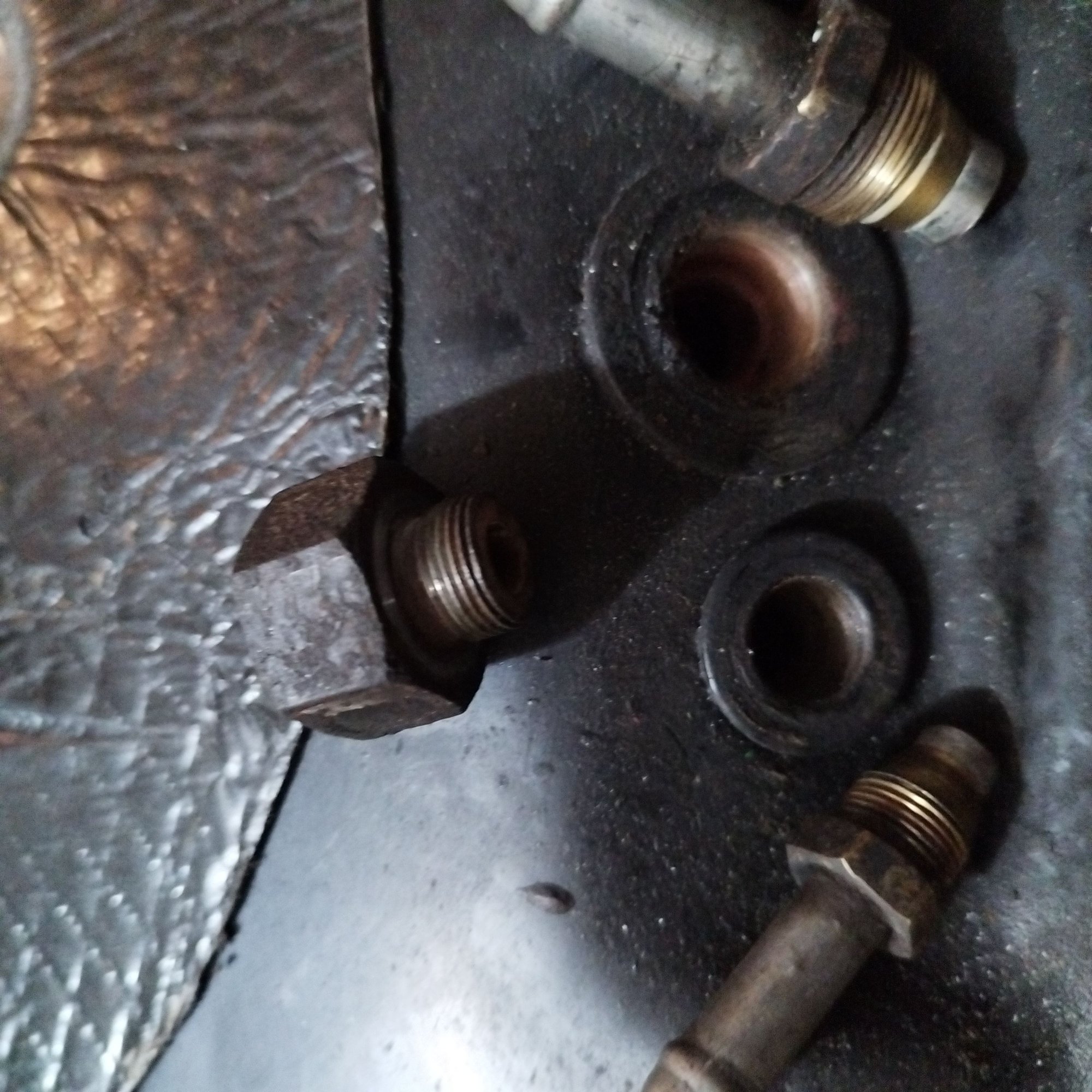

Anyone know where to get fittings for series III tank fuel line? I am putting one in drivers side of my 73 series I and would like to use the original metal fuel line instead of the fatter SIII hose, as it's going to the mechanical fuel pump.
Just went to Napa Autoparts but no joy there.
Attached Thumbnails SIII fuel tank into SI fittings source?-img_20180125_154830.jpg   SIII fuel tank into SI fittings source?-img_20180125_154814.jpg   SIII fuel tank into SI fittings source?-img_20180125_154758.jpg

Is what you are showing what you need? That looks like the fittings out of the Series 3 tank.. One that is the larger supply line and the other return that goes across the muffler... I have those I think.. Or are you looking for something else..

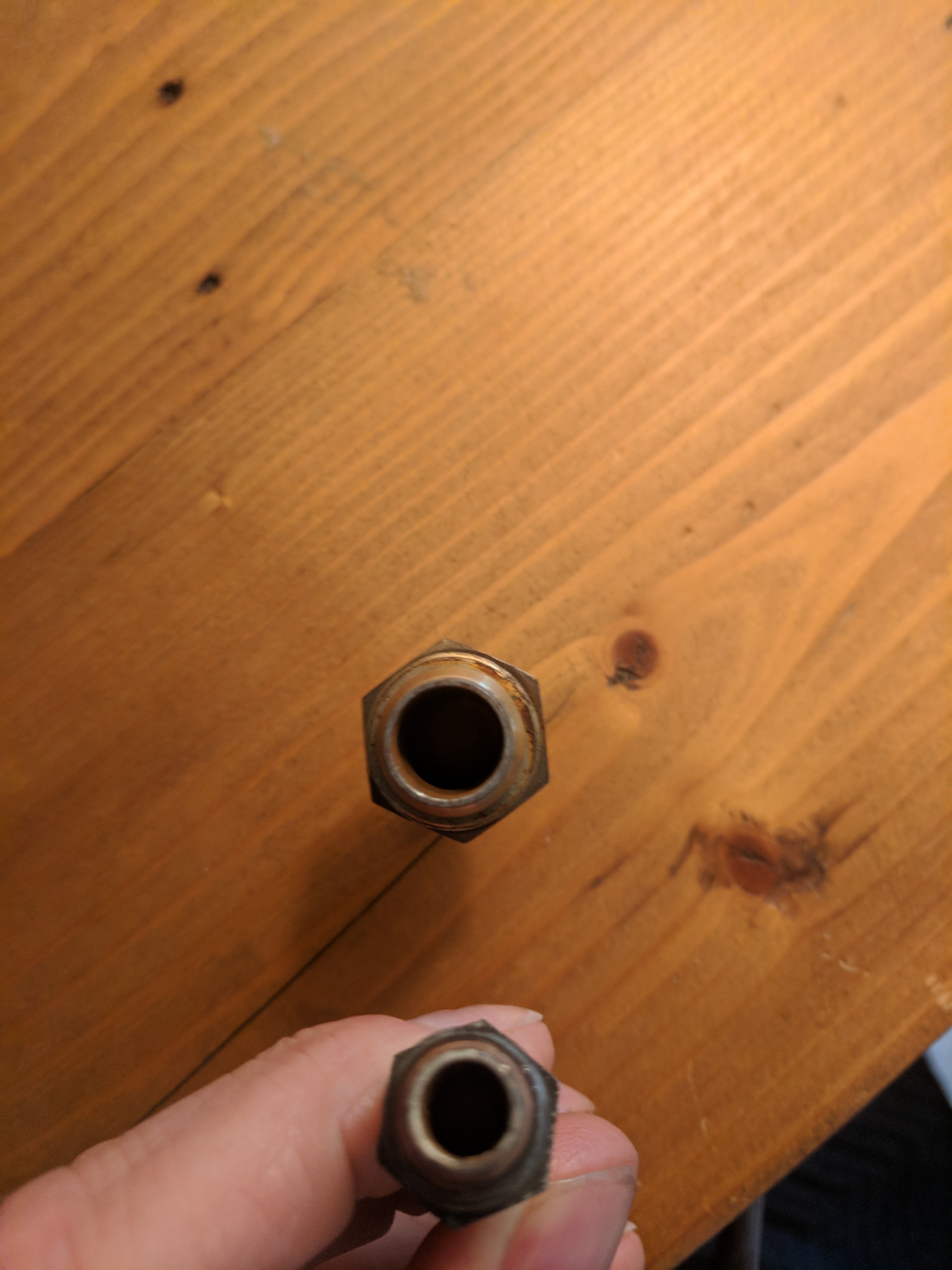

Hi David - I'm looking for a fitting that fits the SIII tank thread but will allow me to plumb in the old series I fuel line, which is a smaller thread. The fatter shorter fitting in the pic is the SIII fuel injection fitting, metal fuel line is the SI, which is what I want to connect to the SIII tank.

The fatter fitting is what was originally threaded into the SIII tank. It has a spigot to attach a rubber fuel line.
The longer metal fitting is what was threaded into my original SI tank, which I have removed due to rust and holes.
what I need is something that will screw into the series III tank but allow for the thinner metal fuel line which goes to the fuel pumps under the boot/trunk floor.
Somewhere out there is a threaded male connector/adapter that will allow this, and it won't be an original part ...
