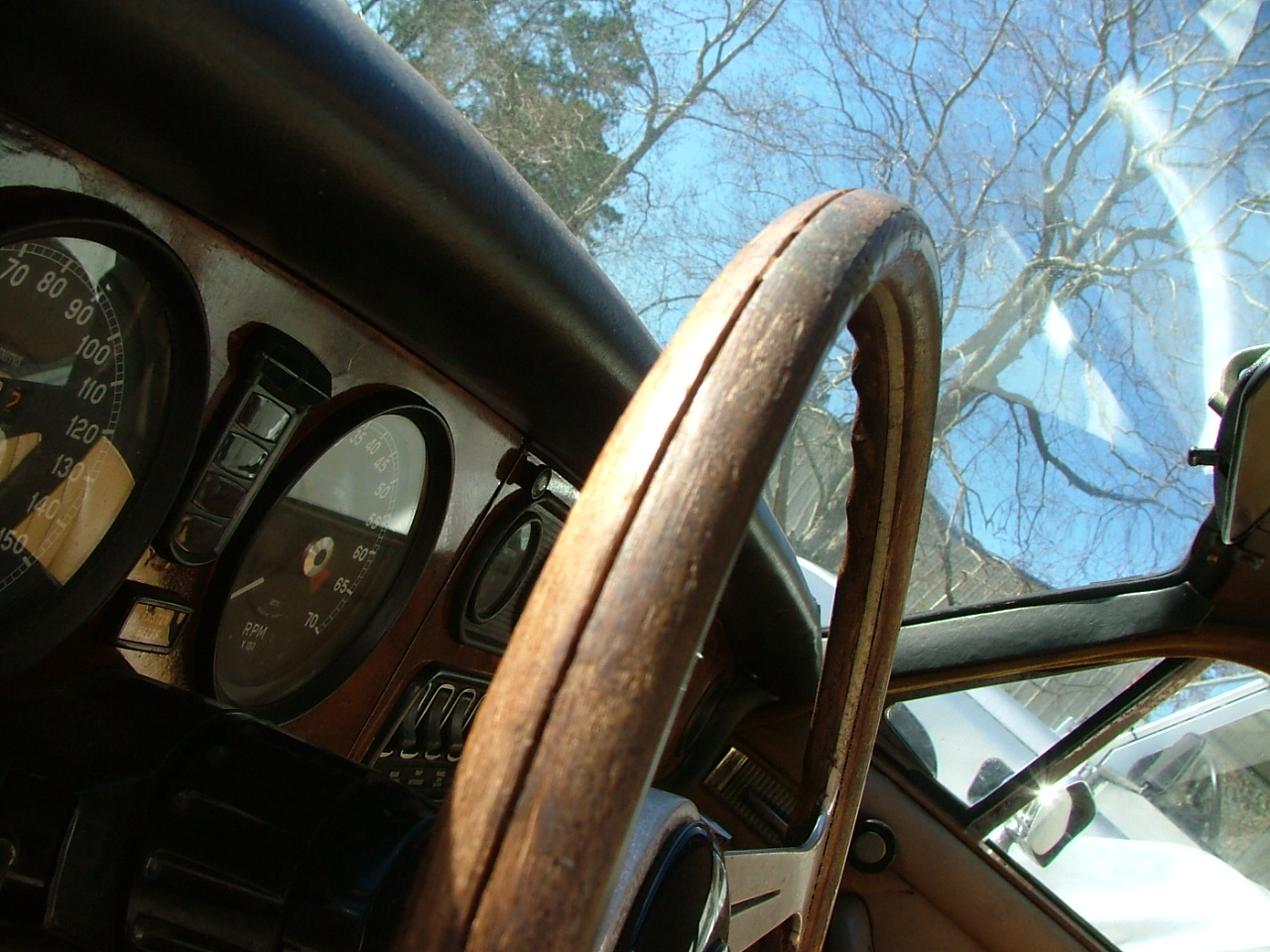

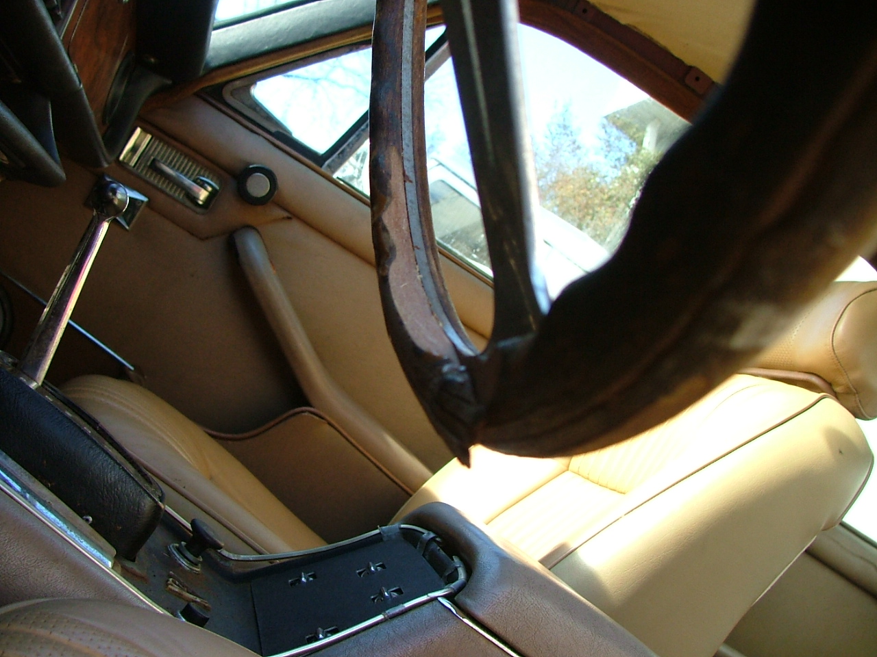

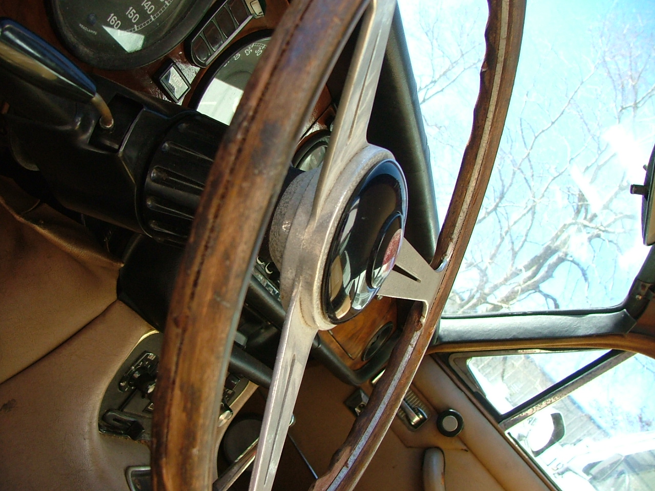

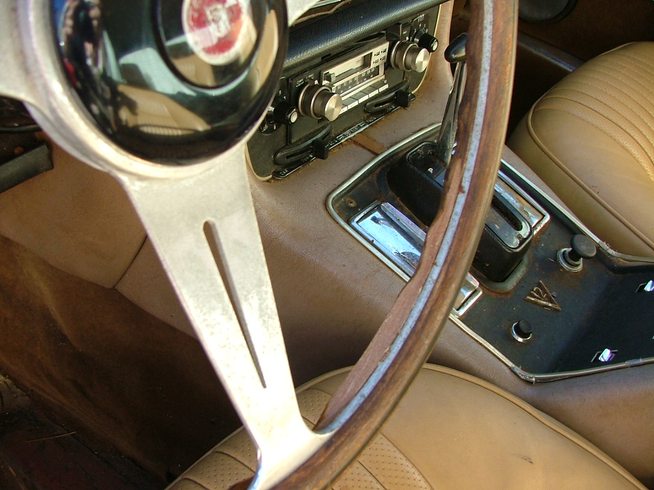

Here are some pictures to clarify the issue. You can see the wood is starting to separate in the middle. Not sure how long this has been happening. Something more recent however is a small piece broke off the bottom of the wheel and a section has pulled away slightly. Talked to one furniture maker he doesnt think he could fix it properly.
At times it means replacement. This is one of them. As, I said earlier, this one has "done it's time". I recall that phrase at a loss inspection in my former profession.
Hang it on a shop wall as a momento and go shopping.

Carl,
I was hoping to reuse it but i think your right. There are a lot of modern nardi wheel options out there. I am wondering if i can find one that i could fit the original horn button onto? A lot of modern variations though like the one in the link below:

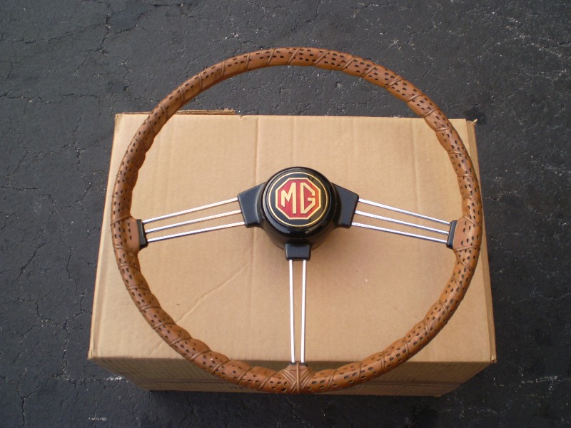

1. Slick. I've a wheel that looks a lot alike the one in your picture. But sans the MG badge and wood rim. Hard rubber or plastic. I was hoping it was a desirable late 30's Ford "Banjo". It isn't. But, whatever, it is a neat shop wall ornament/space taker!!

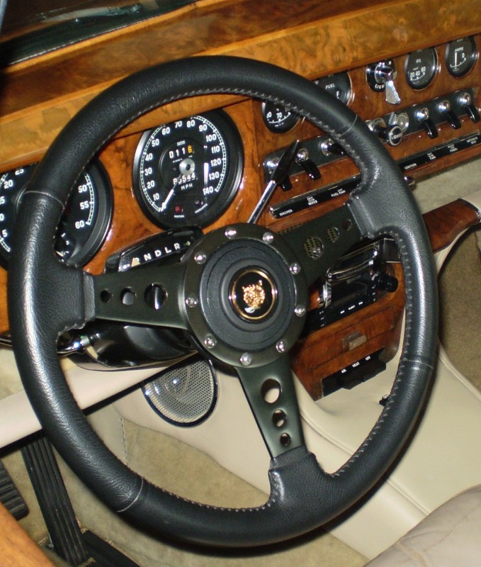

there is a brand called "Tourist Trophy" sold by Moss Motors in Goleta California. They make them in wood or leather, thick or thin grip. Excellent quality, and not expensive. Made in China. No need to spend a lot to get a great steering wheel.
I installed one of those in black leather / black anonized spokes / thick grip /15" diameter in my '65 S type.
the only issue is the left and right spokes are positioned at 10 o'clock and 2 o'clock like a letter "Y" so they block the gauges.
I'm going to replace that one with a Momo Italy wood wheel that I got from David.
it matches the dash wood stain (the picture looks different), and the spokes are at 8:00 o'clock and 4:00 o'clock. Unfortunately it also has cracks like yours, but Saul told me what to do to fix it.

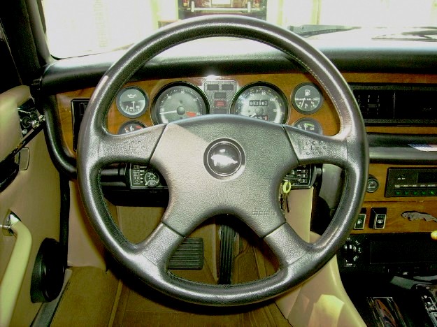

the one in the S type? that is the Tourist Trophy from Moss Motors. I don't like the position of the spokes at 10:00 o'clock and 2:00 o'clock. Otherwise a wonderful steering wheel, very comfortable.
compare with the black leather Momo in my XJ, where the spokes are at 8:50 o'clock and 4:50 o'clock. Not a lot of obstruction of the gauges.
