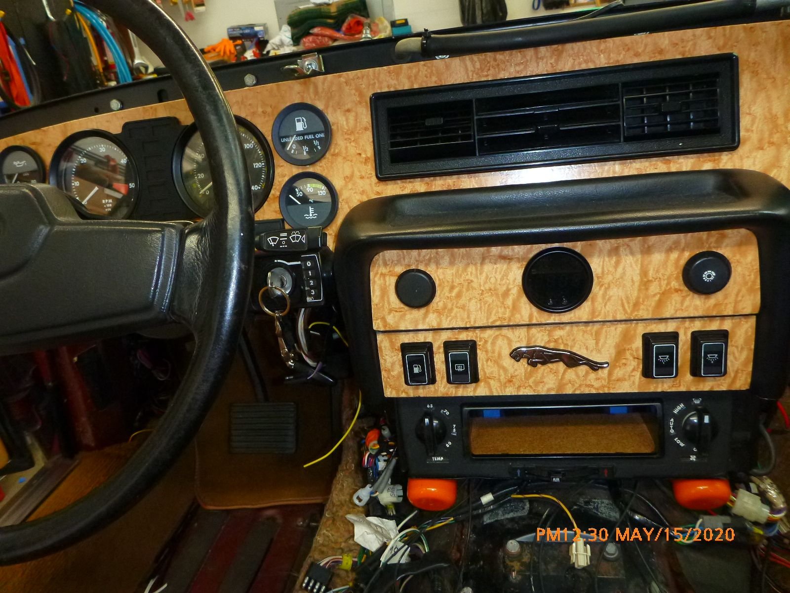

Just fixed the upper part of the dashboard, kindly check for me if or needs to do something else
Old Jan 9, 2021 | 10:10 AM
mikega's Avatar
Joined: Jan 2017
Posts: 527
Likes: 113
From: Accra
I have fixed my mess

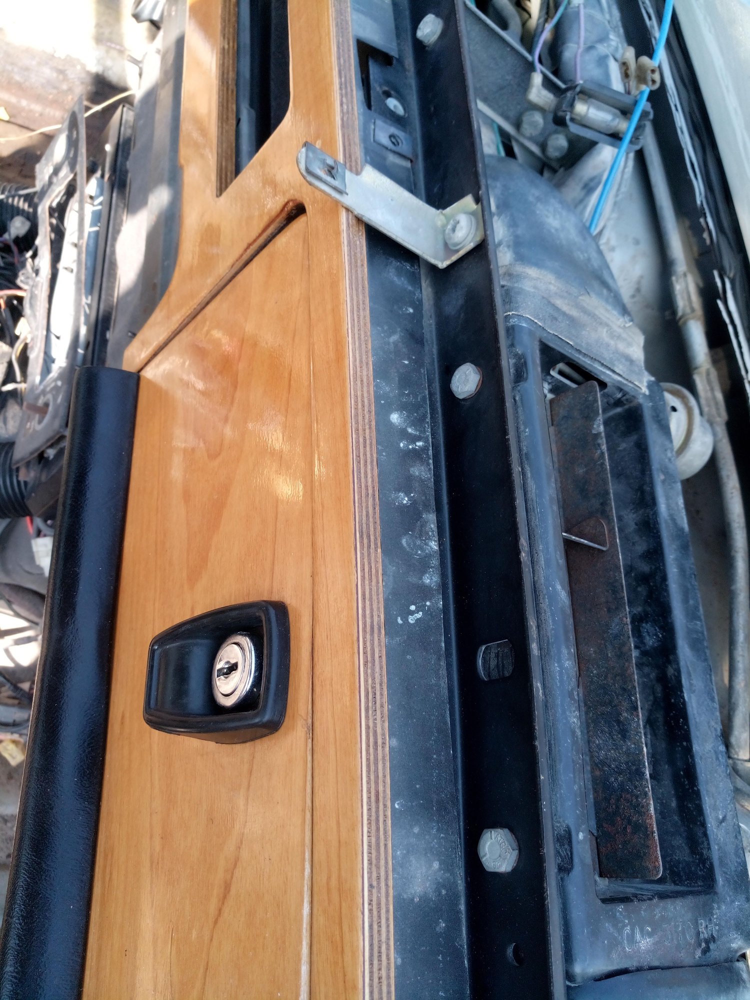

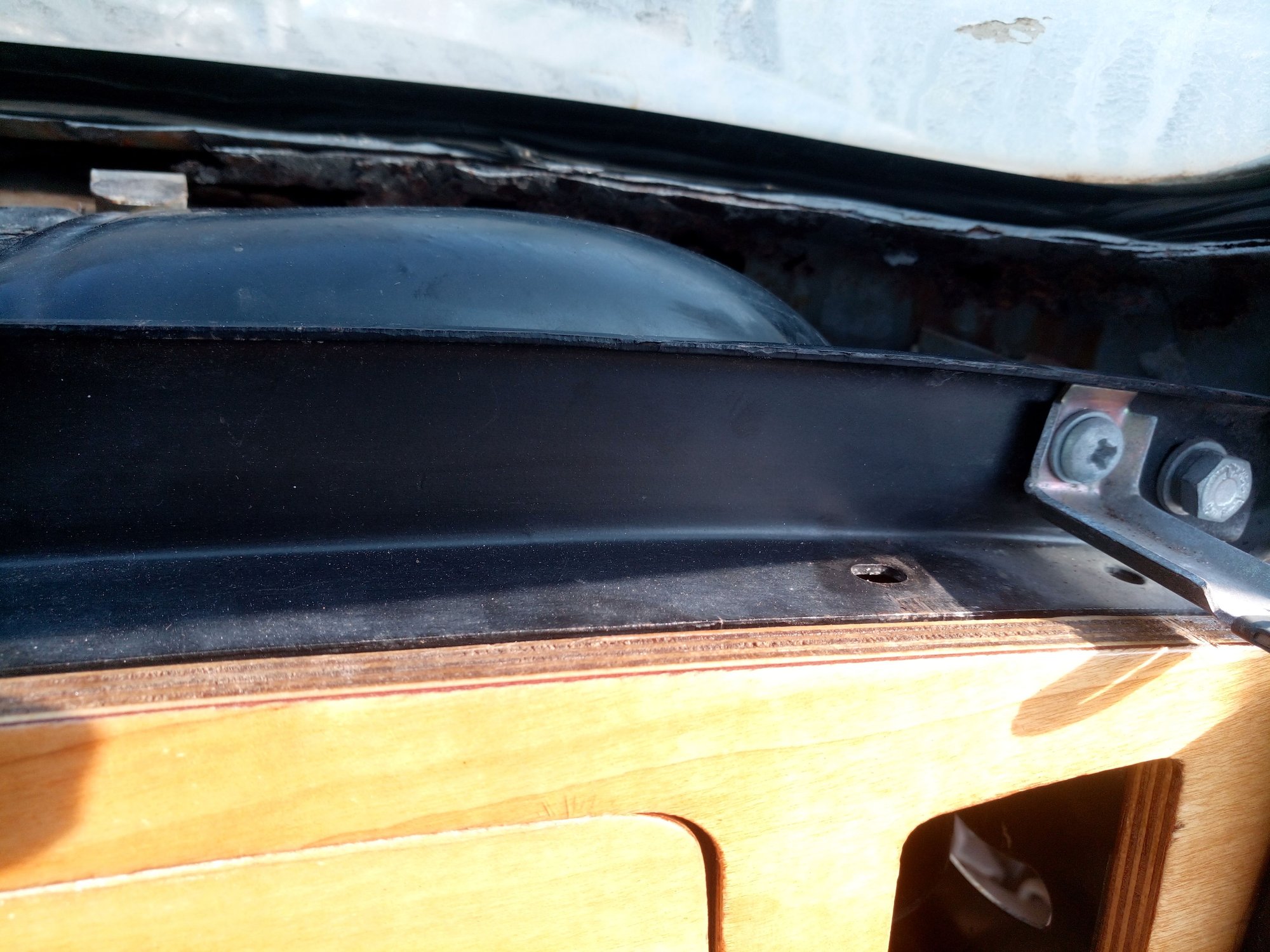

Old Jan 9, 2021 | 06:59 PM
Jag-o-nomic's Avatar
Posts: 449
Likes: 177
From: Melbourne, Australia
HI Mikega,
Also check cabin temperature sensor.
Looking at your pics, it looks like it could be that open ended rubber tube which is protruding through the black metal bulkhead just to the right of the steering wheel.
It's a bit unclear, but if that is it, then you are missing the end assembly which includes said sensor.
Later, when you re install the dash pad, there will be a recessed place and opening in the pad for the end of it to 'feel' the temperature in the cabin which is where the delanair systems gets its internal reading from.
If the sensor isn't fitted or gets kinked / blocked from here until the end, your climate control temperature simply wont work, to the extent that you may get hot air when it is warn inside and freezing cold air when it cold inside as the system is taking a temperature reading from the open tube behind the dash instead of the area under the dash pad lip inside the cabin.

Nigel is on he mark and it is a PITA to get the sensor stuffed in the hole in
the dash pad without pulling the hose/tubing apart. Here's a partial picture that shows the rubber tube along the top of the dash frame. What is not visible is another metal tube extending from the end of the rubber one toward the right. I looks a little odd as it has a branch coming off of it with nothing in it. The main tube connects to the sensor which plugs into the hole in the round-over of the dash. All of the tubes tuck up into the back of the round-over as you are trying to maneuver the dash pad into place. It'll be easy.
