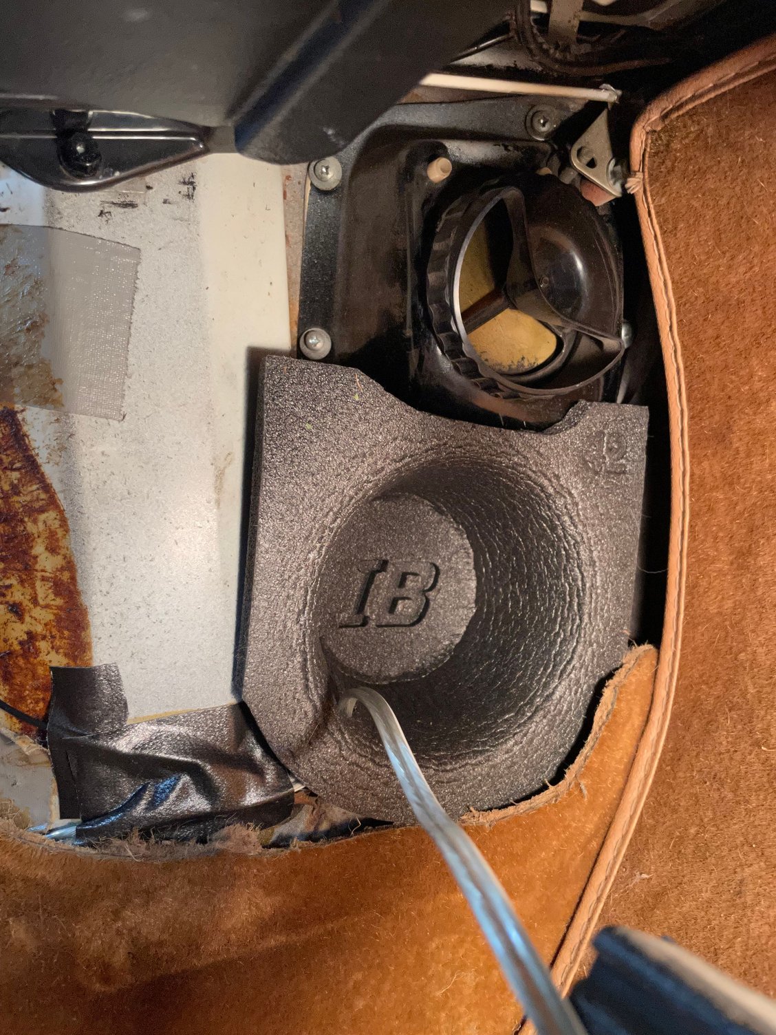

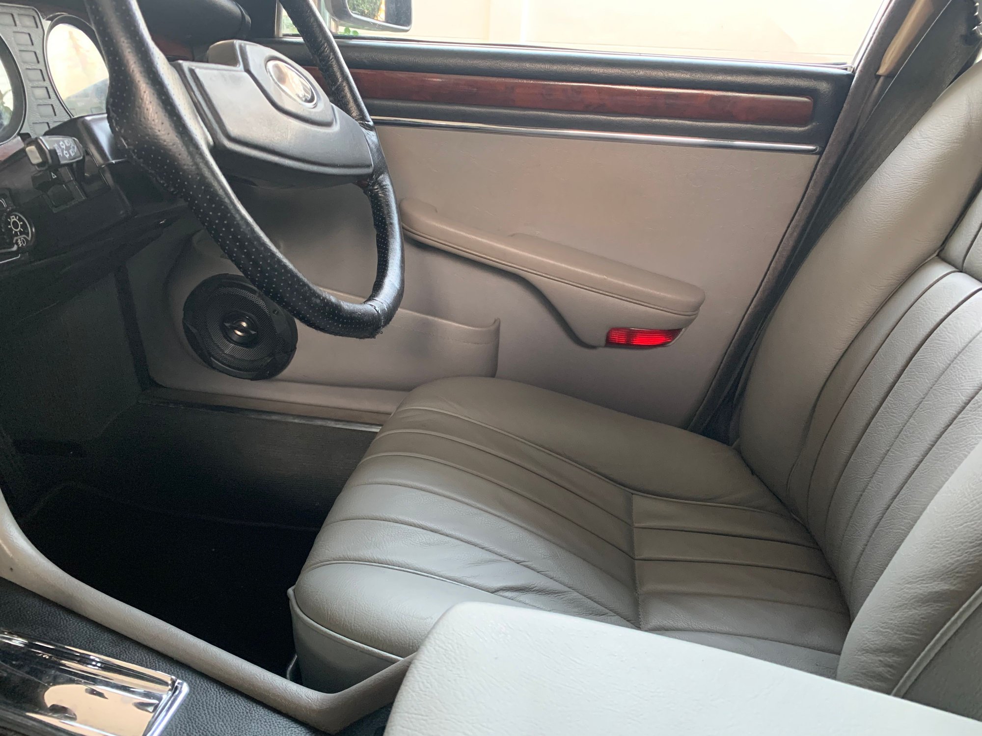

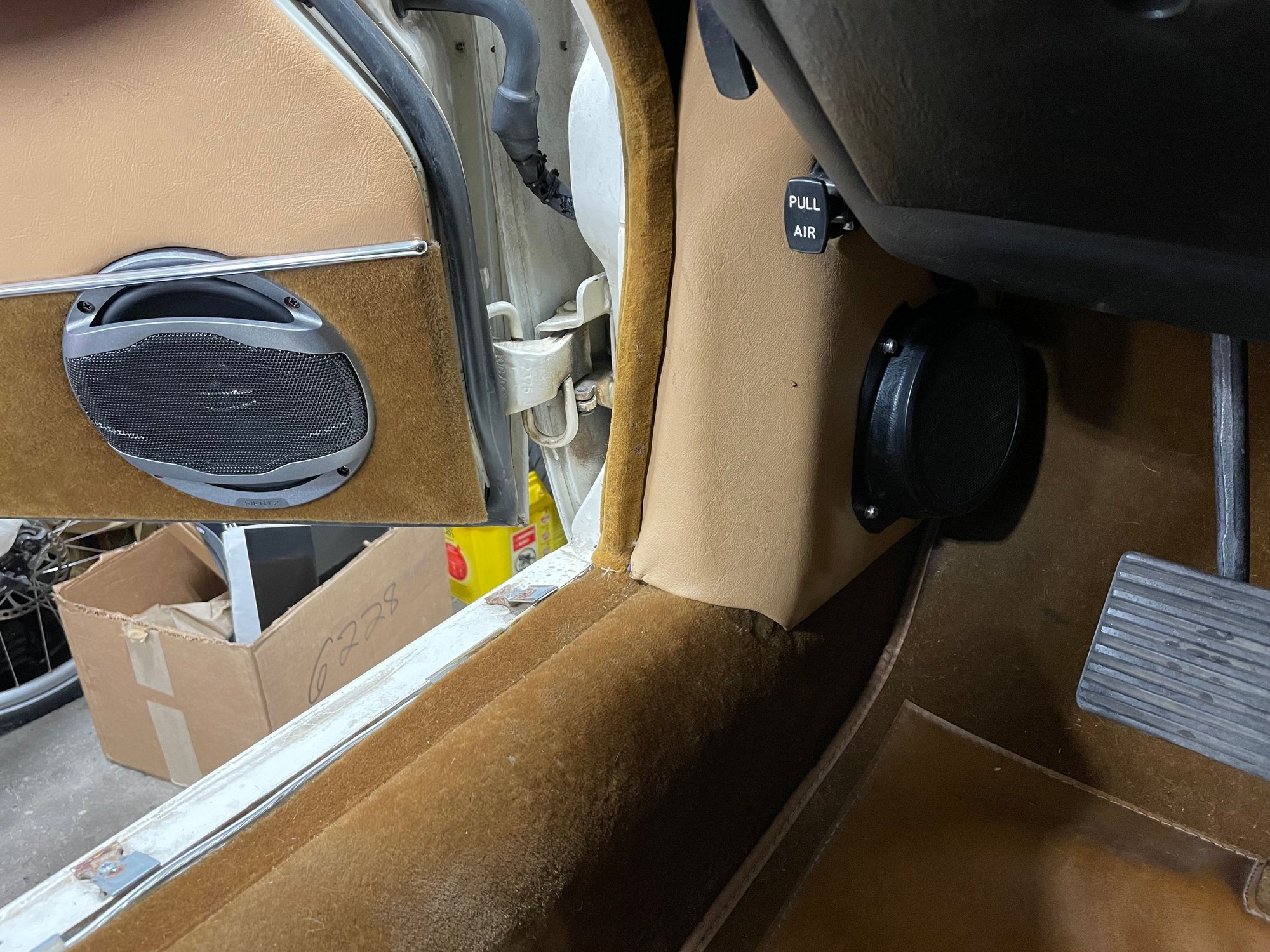

hi: i like your thoughts regarding keeping stock but adding hidden modern upgrades like the amp and blue tooth streaming. here's a couple of ideas i used: i have an '87 base xj6. i salvaged vdp door cards so i could jam 6.5" round speakers in the front.

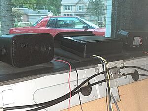

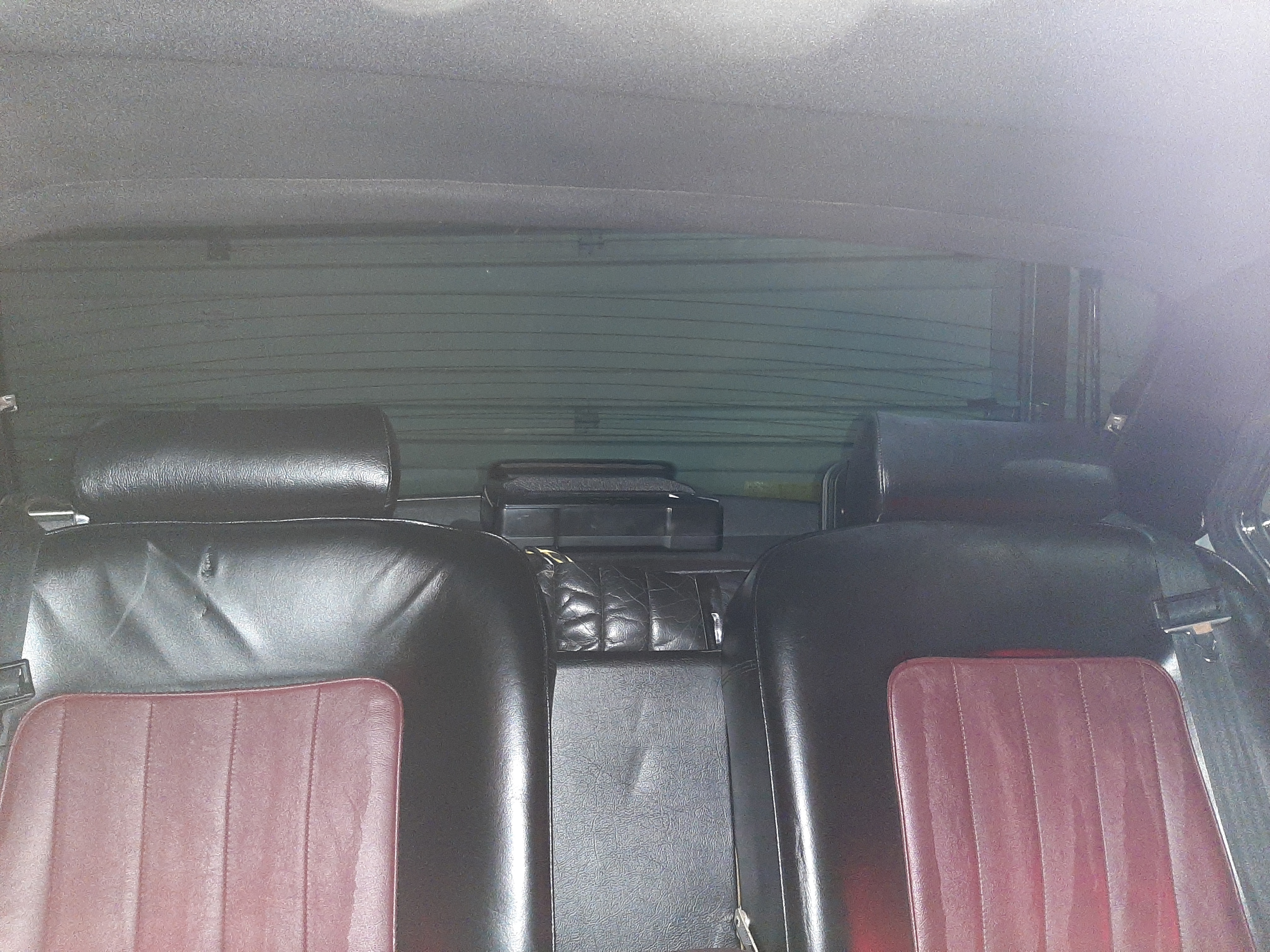

i used the parcel shelf in a non-traditional manner, i installed a powered sub along with sealed marine box speakers (the headrests from the vdp that i also bought hide the speakers)

on a side note, you probably noticed the ribbed leather between the inner shoulders of the rear seat backs. i rigged this up after i discovered this difference in seat configuration between base xj6 and vdp. i subsequently bought a vdp parcel shelf
overall i am pleased with the improvement in sound but this setup probably won't pass your "stock look" measurement. there may be a way to install 6x9s without cutting into the metal parcel sub-shelf. i've seen marine speakers that are very shallow, 1-1.25", which should allow them to "float" in the space between the underside of the parcel shelf and the metal. they are finished with the standard grill mounted on top of the parcel shelf . hope this gives you an idea or two. please share your final solutions for future reference. ren

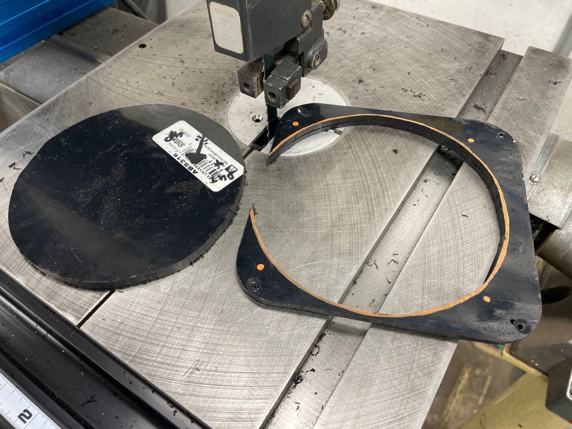

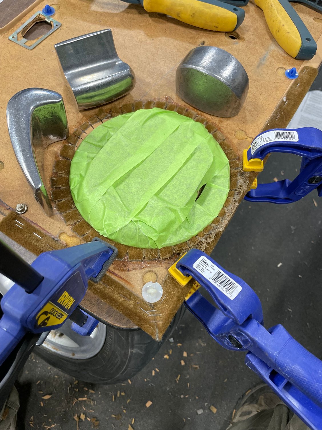

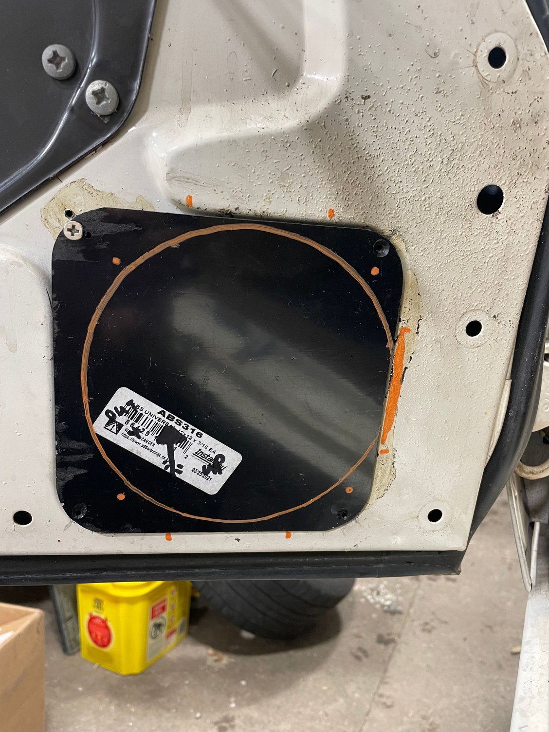

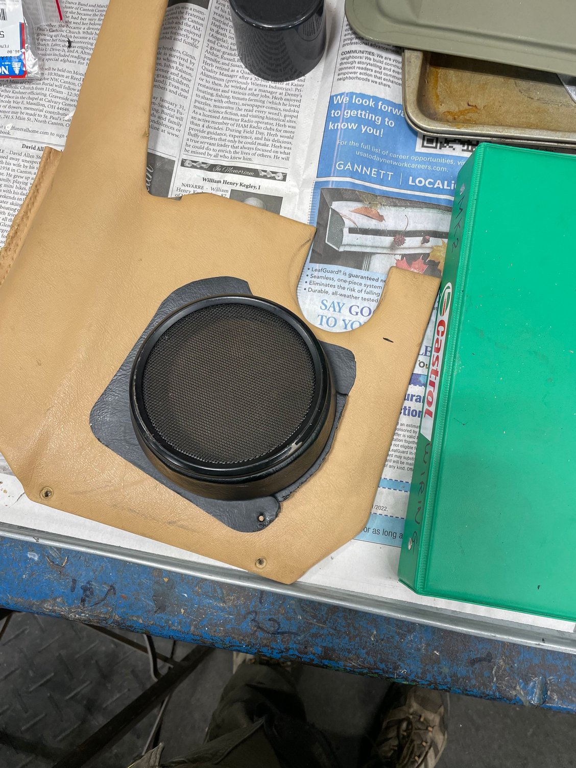

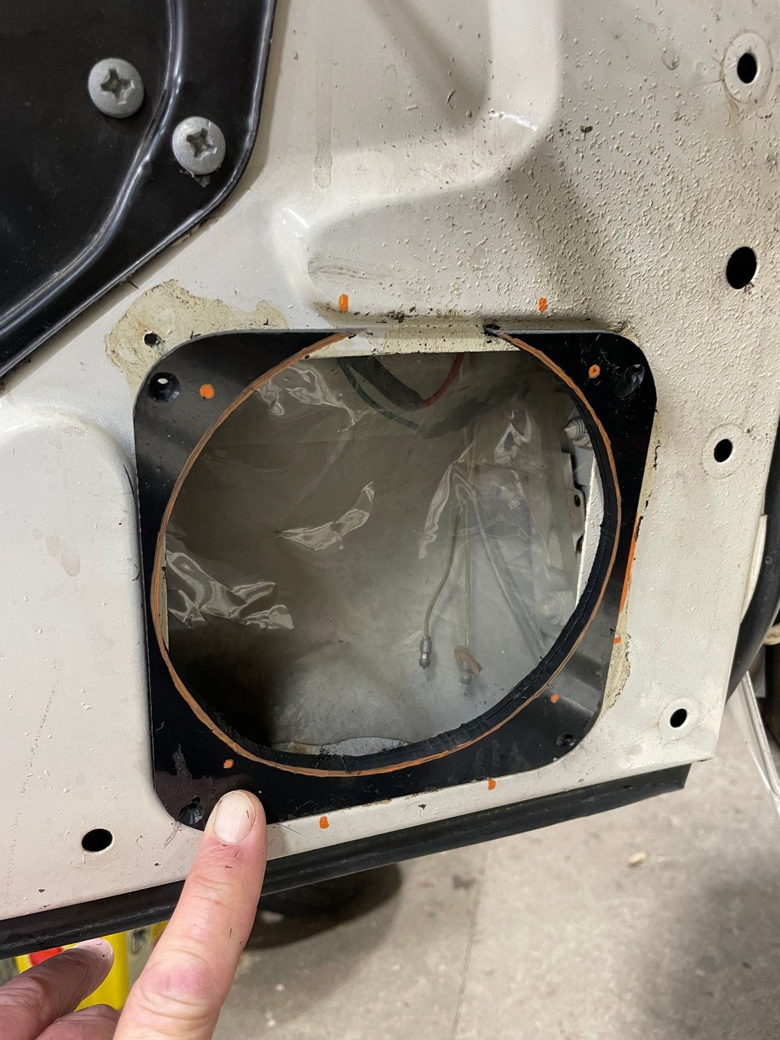

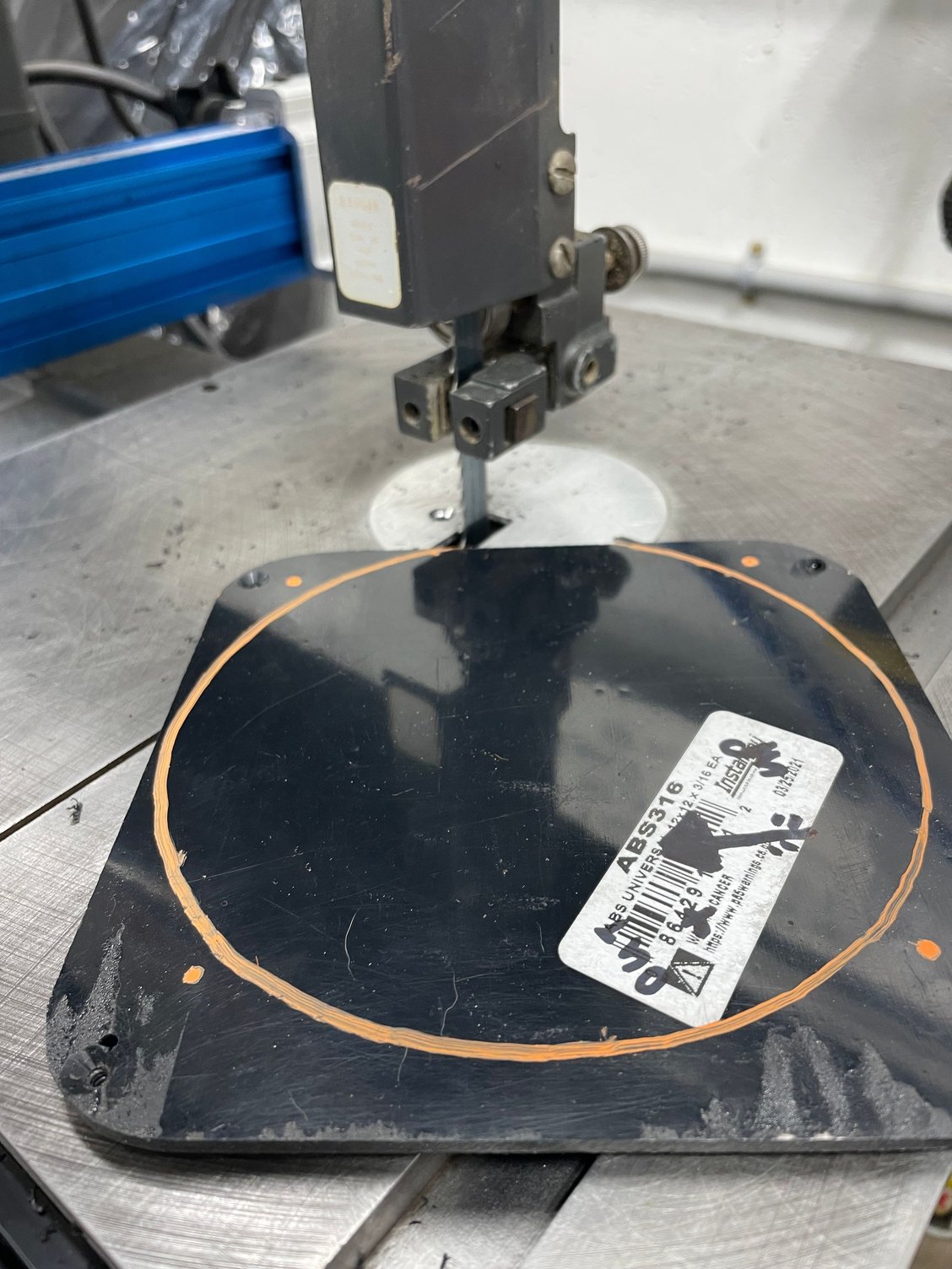

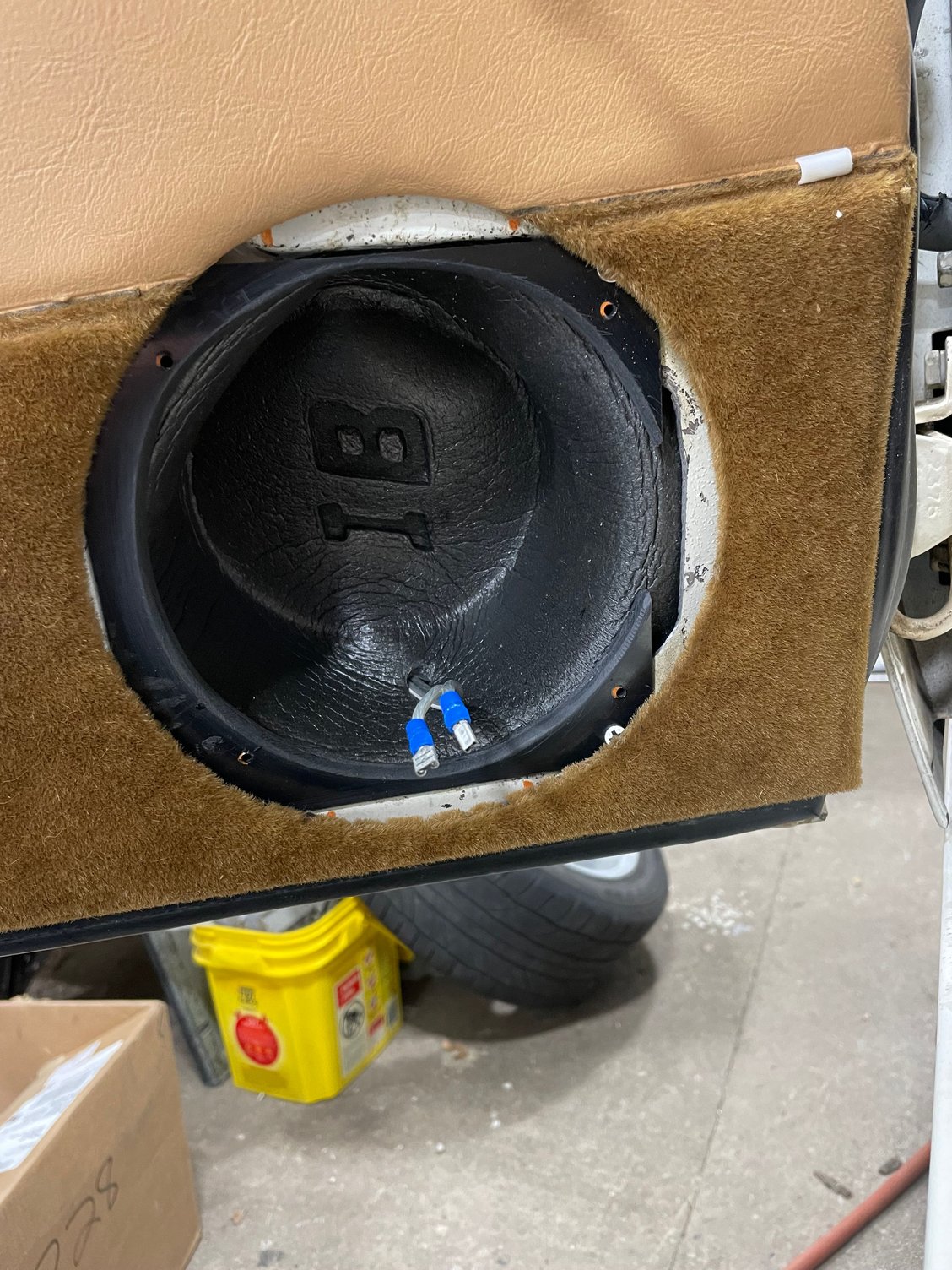

awg924: after separating the speaker box from the door card, you will find 4 threaded posts that secure the speaker along with 4 nuts. i had to cut 3 of the threaded posts to allow for my 6.5" jbls. i used the remaining post and nut as one anchor point then i used a 1/4" sheet metal screw to anchor a second point on the speaker. the speakers are held firmly in place and there was no issue with room for wires, especially the driver's speaker box with the remote mirror controls. the improvement in sound quality was immense moving from 4" to 6.5". i would imagine whatever solution you arrive at, the sound will be amazing good luck.
