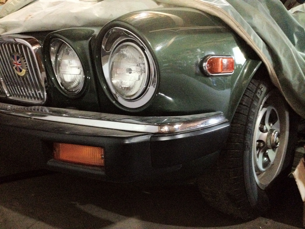

Hello my mom has a near mint 1986 xj6 with around 68k miles. The color is British racing green. It has been sitting in our garage covered for 3+ years. Ran great before it was parked. I would like to get it back on the road this year. What can I do or what should be done to it after sitting these years?
Also is this car elgiable for classic or antique insurance/plates?

Beauty; thanks for posting!
