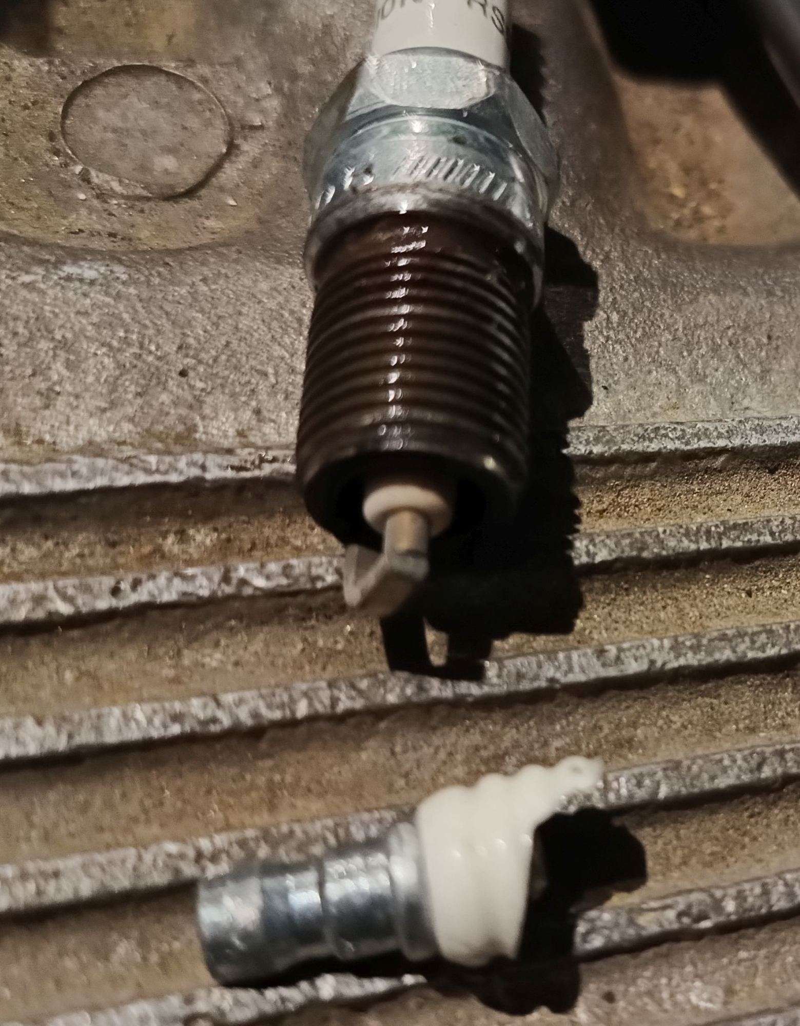

Forgot to post this strange spark plug: Part is clear white porcelain, other part is black soot. Spark plug is new, and colors are formed before the full power returned
black & white spark plug

I would say its too rich. Can you post a picture of the plug after a few hundred miles when its running good now? I am just interested what a "proper" running H.E. Plug looks like.

The plugs will look much like any other engine, a light tan colour.

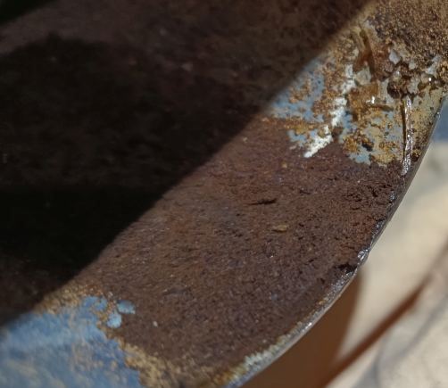

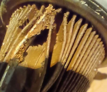

Now I cut the filter, it is clogged. May be less than 1000km. For the resurrected car, this filter should be changed on 250-300, it seems
