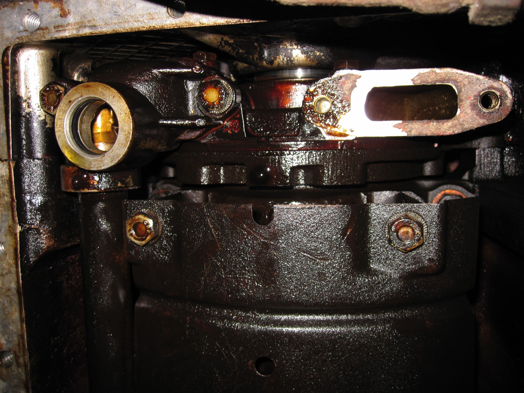

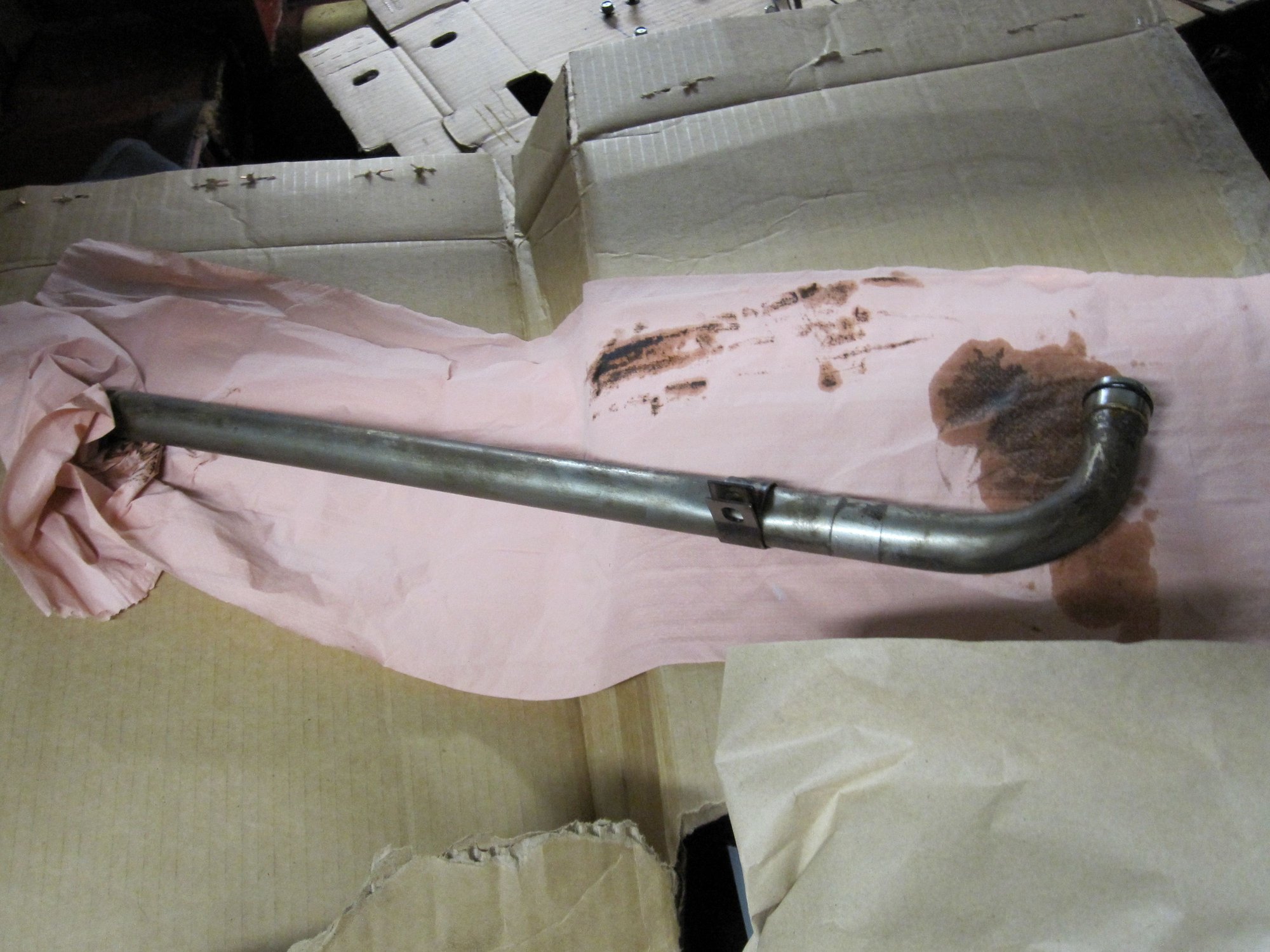

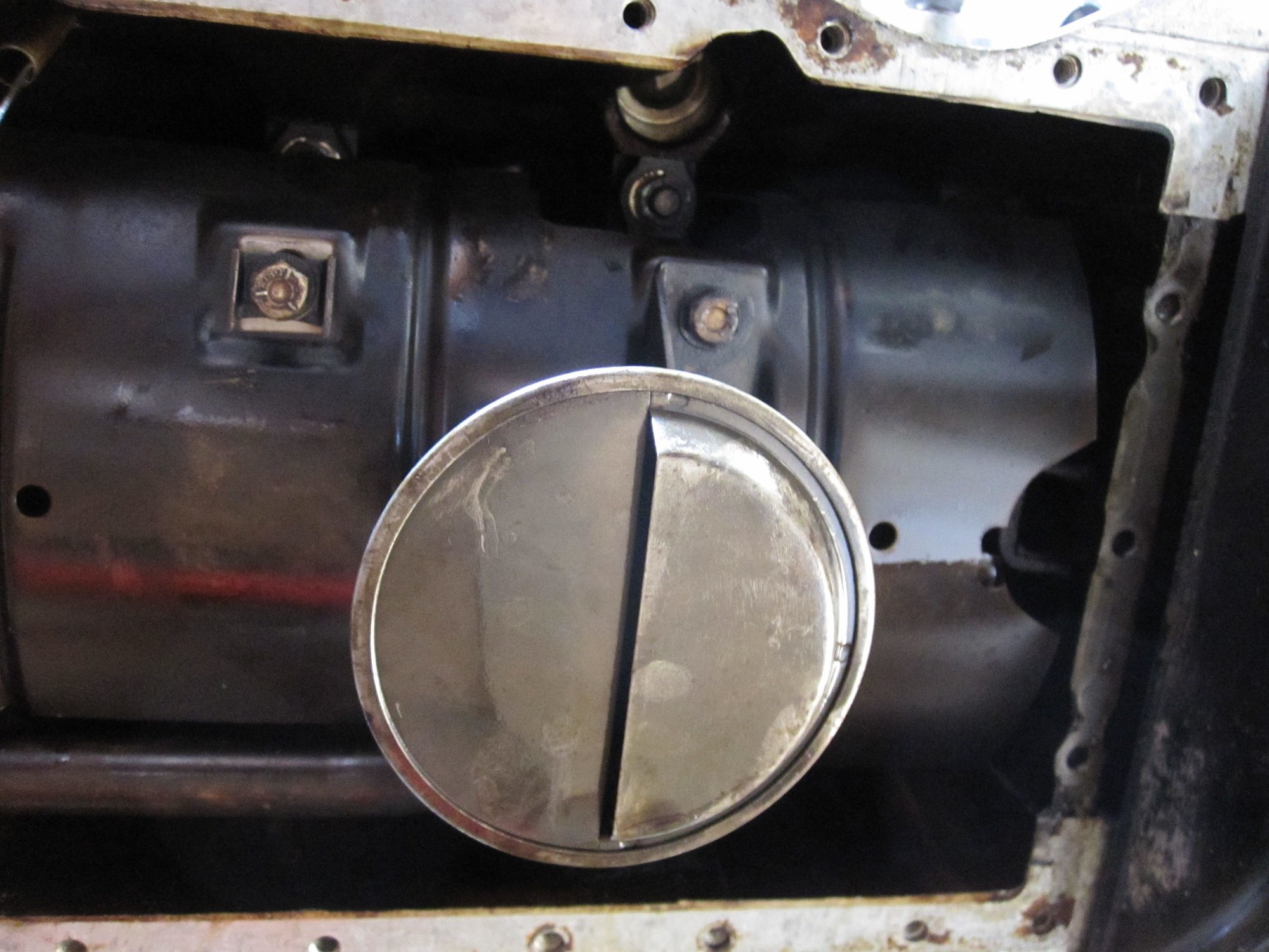

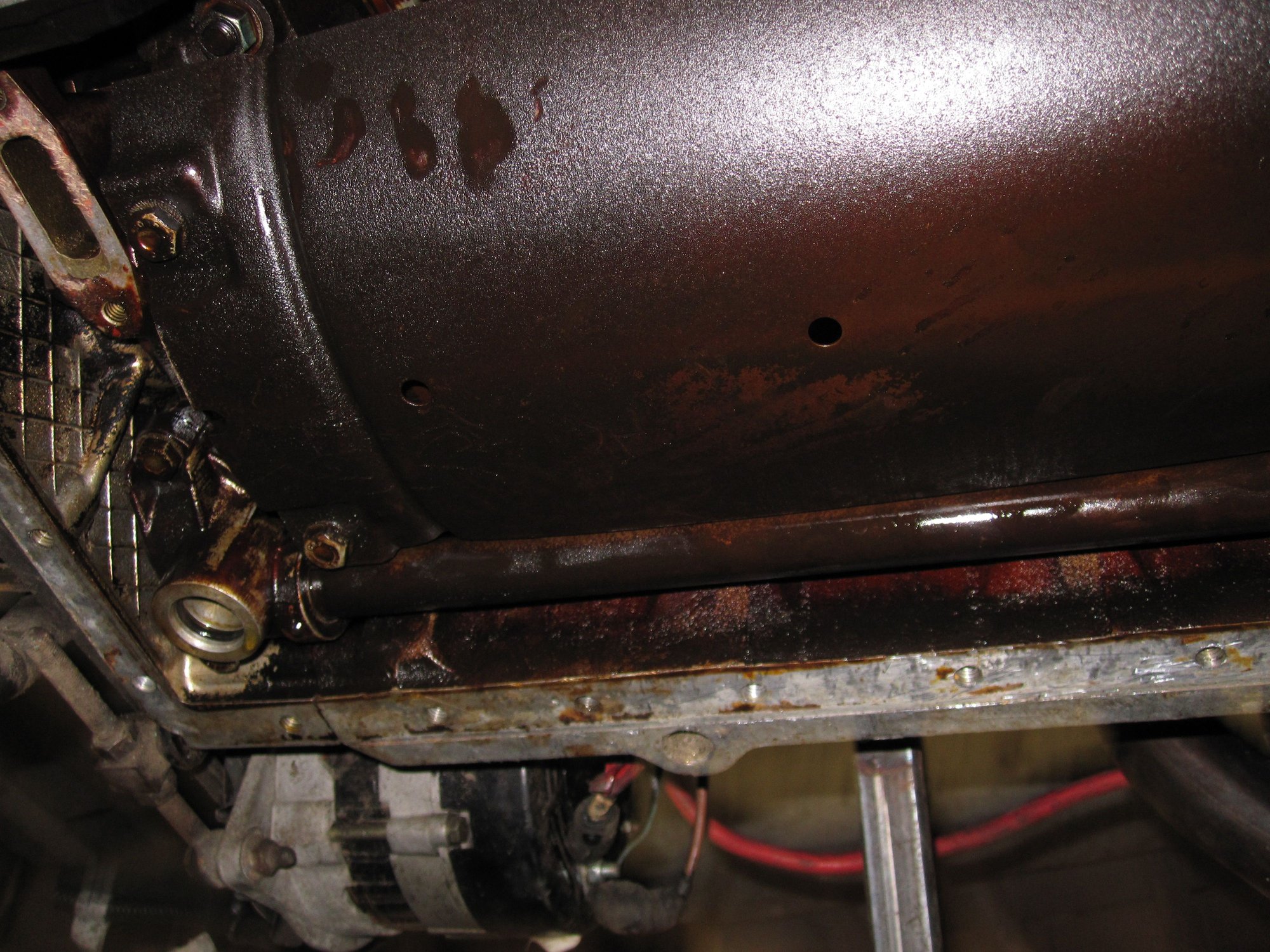

Replacing the oil pickup O rings is easy, assuming the engine is out of the car. Pics attached. Basically there are two pipes with O rings to seal them, one a pickup from the sump and another going from the pump to the oil filter and main oil gallery. You just unbolt the sump and the sandwich plate and there they are.
You can see the O ring on the end of this pipe
In this shot the O ring is in the casting
Sump pickup filter on end of pickup pipe
Another pic of oil pickup
principles shown above.

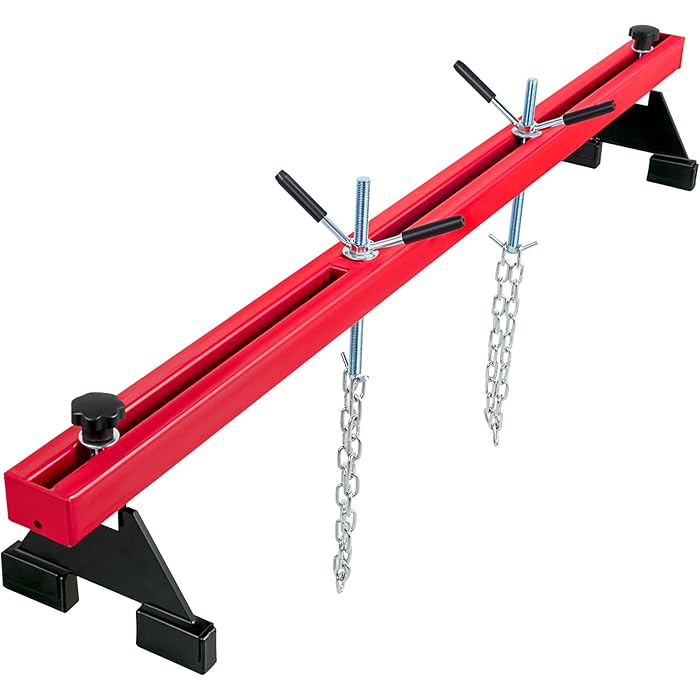

Good decision Tommaso. This is the ype of bar you need to support the engine, and the chains go onto the lifting eyes near the front water manifold/thermostat housings:
Best to use shackles to attach the chains. The only other thing is that you need to undo the engine from the engine support mountings. You need a 9/16s ratchet spanner to do it, and to remove the air cleaner boxes to get to them, one each side.

When he raises that engine, WATCH OUT FOR THE HEATER TAP AT THE REAR, easily missed and squashed.
I said 6", maybe half that will do, I just look and see, and call it enough.
