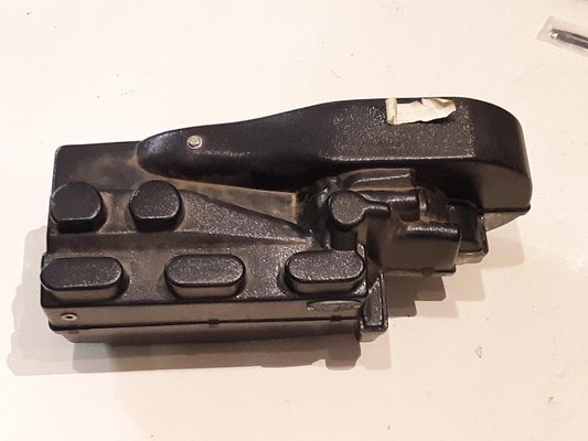

Vintage Air has two 'air handlers' available.
One is a traditional cable and flap unit and the other is more modern with stepper motors controlling the air flows.
IIRC the classic style of air handler from Vintage Air is significantly smaller than the modern stepper-motor equipped unit.
Vintage Air makes 'dummy' air handlers for folks contemplating a conversion/addition of AC to their car/truck so they can investigate fitment. This is a dummy of the servo motor version-
You can borrow either 'dummy' unit for a trial fit from any local distributor for Vintage Air. I borrowed one from the local Socal Speed Shop. I think you can get one from Vintage Air directly too.
FWIW, I borrowed the unit in the picture to see if the VA unit would fit it my '49 GMC - it did. I'd estimate the distance from the dash to the firewall in my truck is about half the distance it is in my XJ6, so I'd be pretty confident you could get it to fit. It is worth noting that either unit required that I shorten my glovebox so it was only about an inch deep - not much call for gloves in Arizona but AC is a necessity so I'm willing to live with it.
We'd all appreciate it if you were the 'first penguin off the ice floe' on this endeavor - let us know how it works out!
