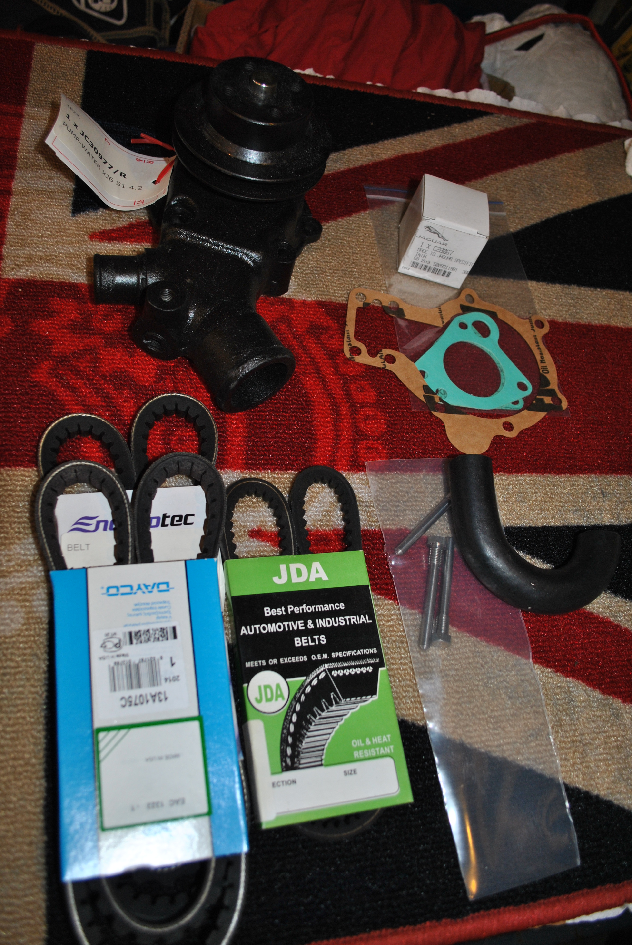

nothing there looks like a match. These are the best pics I have.

NOPE.
I work, when called upon, in the aftermarket spare parts industry. The pumps from the likes of what you have suggested will NOT fit the S2.
I have looked at them many years ago, and came to that decission then, and see no reason to change that decission.
I have always got mine from JagDaim, including the V12 units.
They will need to know the V groove number on your pump pulley, and the "snout" diameter and length. That is from my memory as it has been a very long time since I needed one.
