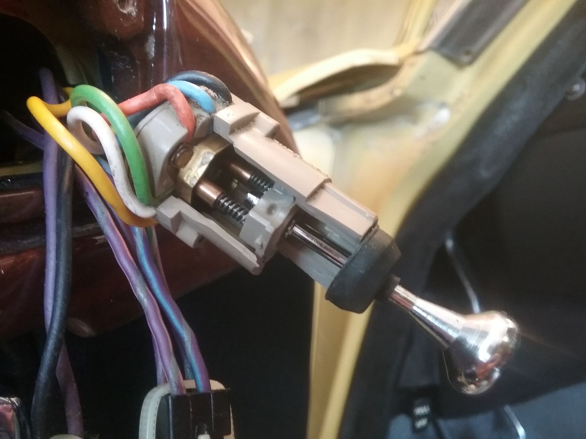

Old Aug 30, 2022 | 12:49 PM
Yellow series3's Avatar
Joined: Aug 2017
Posts: 916
Likes: 648
From: Cincinnati Ohio
I finally got around to investigating my possessed door mirror. Turns out the joystick switch has perished, plastic housing cracked and falling apart. Its part number DAC2649. By chance does anyone have one sitting around? They don’t seem to be available new and the used ones on the web are quite pricy. Thanks for your help.
Jeff
Old Aug 30, 2022 | 02:44 PM
Jose's Avatar
Posts: 9,137
Likes: 2,659
Jeff how pricey is pricey?
the lowest price I found for ONE JOYSTICK is David but he doesn't have any. Nobody else has them either. Nothing on eBay.
I have two sets including the chromed fascia. Contact me for price.
