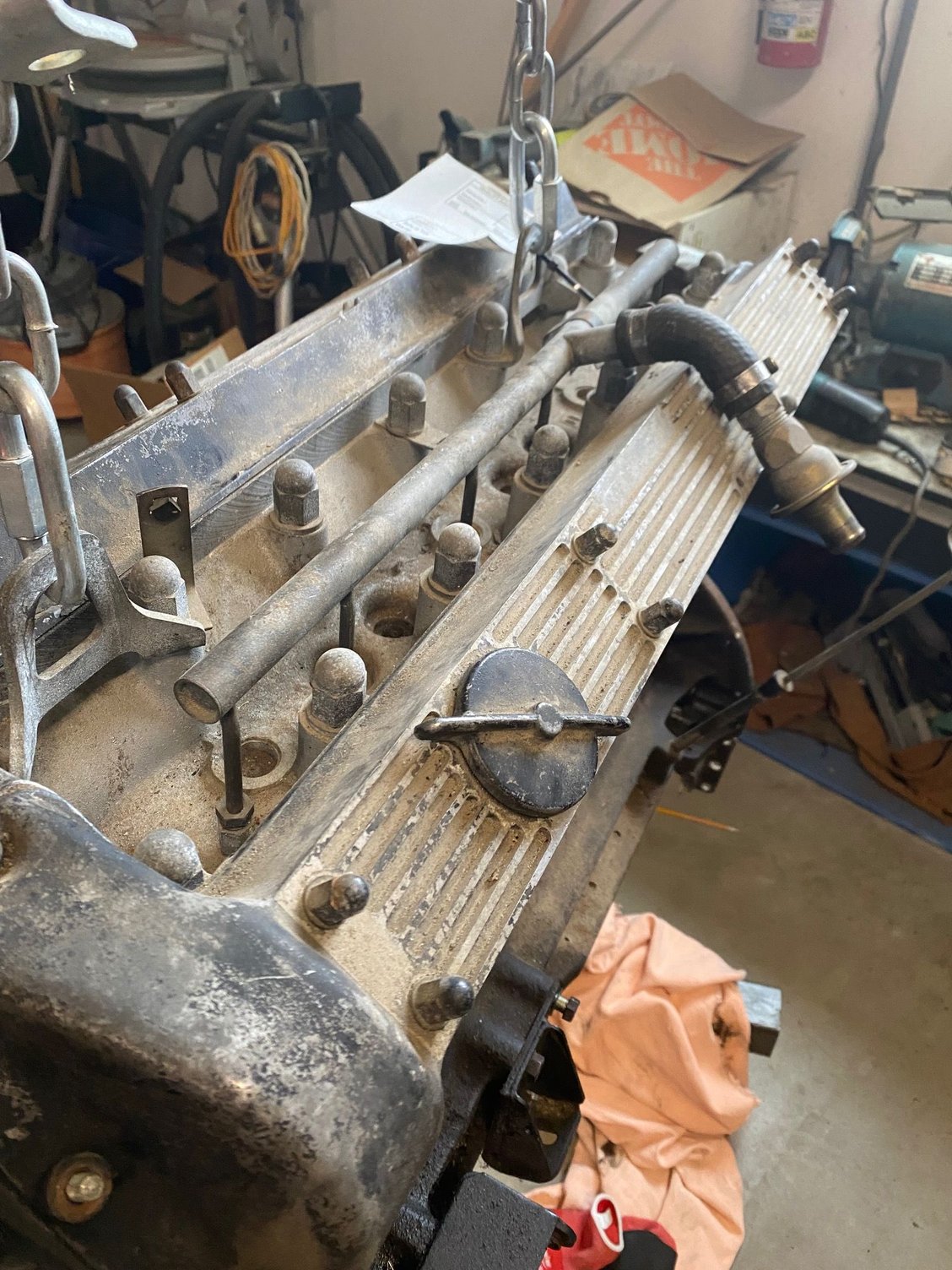

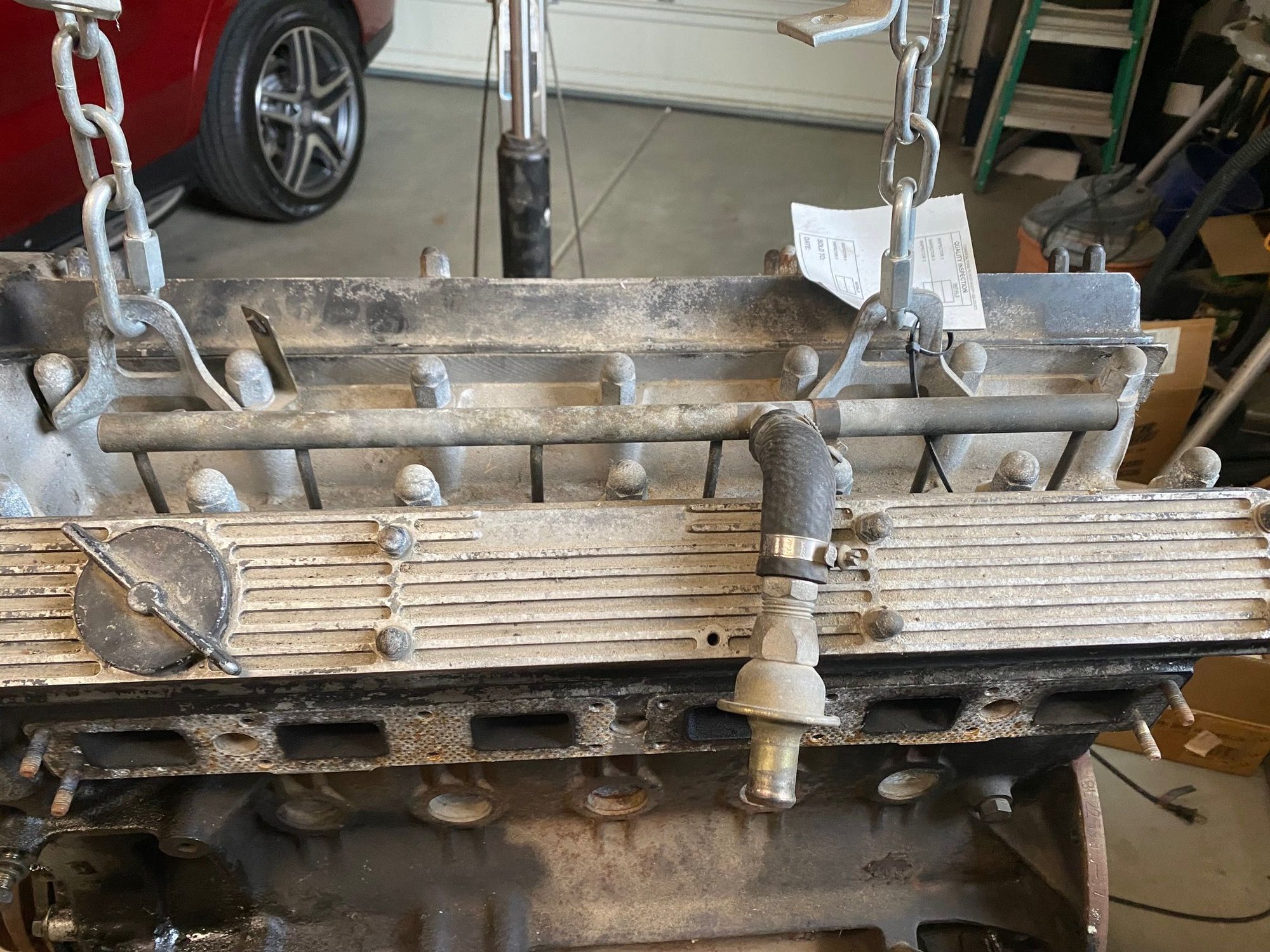

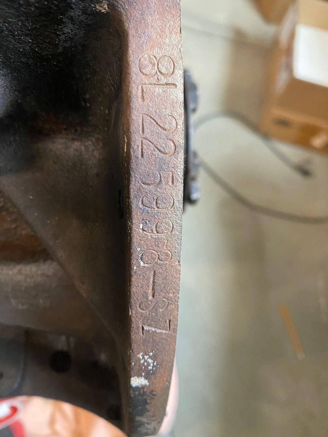

I bought this as a non-running engine on ebay. Yes I am a glutton for punishment. I was struck by what appears to be coolant lines going between the cylinders on the head. I know the 8L stands for the 6 cylinder 4.2 with the long head bolts. Other than that, I am clueless. Can somebody please tell me what I have? Is it worth trying to get it running or should I just turn it into a coffee table for a man cave?

That's a US spec XK engine, 4.2 litre from a Series III XJ6 (up to 1987). They are not "coolant lines", but an air injection rail. Only USA market cars had that.
It's certainly rebuildable if you have a use for it.

Thanks. Since this is going into something other than an original vehicle I can just plug them?

Yes, Easy to remove and thread a plug into each hole.

If you decide to remove the "smog pump" fittings you'll need 1/8" BSPT countersunk plugs to fill the holes. The "T" stands for tapered, the straight fitting won't fit. I bought mine from Grainger.

Thank you for making it easy for me. I just ordered 6 of them
