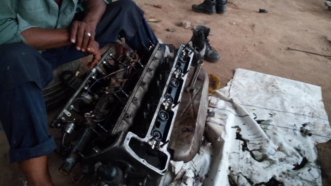

I need help where to get below list of parts at affordable prices for my 1985 XJ6 Series III, i urgently need them please.
  1. Timing Chain, Guide and Tensioner Kit
  2. Head Gasket Set
Thanks for support in advance.

Couldn't help noticing the cylinder head studs.... you really should change them all now that they sit in front of you, if one is corroded at the bottom (they sit in the coolant) it may fail as you are torquing head down and then you will have to do it all again. You will never know which one until you pull them all out and look... I had one stud 1/3 corroded thru, when I was just where you are now. (They are 40 years old and needed to be retired).....There are Forum posts on how to get them out without breaking them off in Block, which is a real pain .... Weak/non-symmetrical toque of head, will surely lead to water leaks and another blown gasket; follow manual carefully when torquing.
For engine parts, I would be comfortable with SNG Barratt US or XKs Unlimited (they are 20 miles from me, so I avoid shipping)
You want this to be the last time you have the head off, before giving car to your favorite son.
Rgds
David

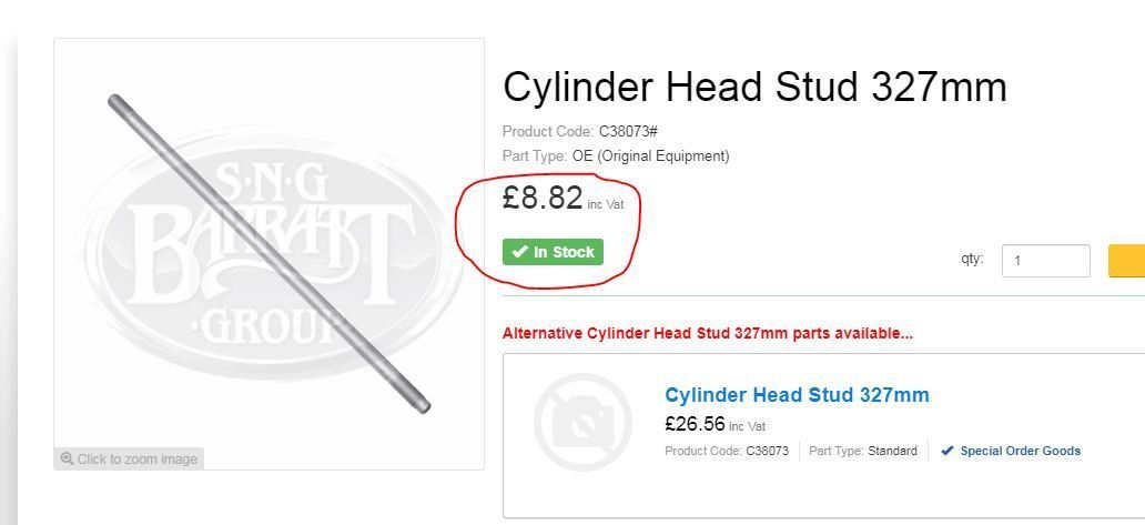

SNG have them but do not have C38076

Did the link I included above not work? It did for me, showed them in stock for £7.35

attach is what the link returned wit the price more that what you have stated, maybe my location determined different prices on the parts.

The difference is VAT (Value Added Tax) is included in that. If you're not in the UK, you will get the price without VAT. Currently, VAT is 20%, so that's the difference. At the very top right of the page you can choose to show prices with or without VAT.

Mike GA, have you removed those studs yet ? Can I advise a word of caution. When I rebuilt my XJ6 engine back in 1990, I replaced the these studs but great care is needed. First off, you need to remove the core plugs by each stud first. You can then see the state of the stud, Mine all came out OK using a stud extractor, but some did look like Desperate Dan's toothpick. The corrosion occurs mainly at the bottom near where the stud goes into its threaded hole at the bottom of the block. That's why great care is needed because if the stud is badly corroded and snaps off, getting out the stub can be really difficult. Once you have the studs out, I had a tool made up to clean out the threaded holes because the studs need to go down all the way, or they stick out too far, and the domed headnuts bottom out and don't provide any gasket pressure. My tool used a plug tap welded to a long rod with a T-bar at the top, but you could use one of the old studs with a T-bar welded on the top, and two saw cuts at the bottom threaded portion to collect the crud. Use plenty of lube or grease.
