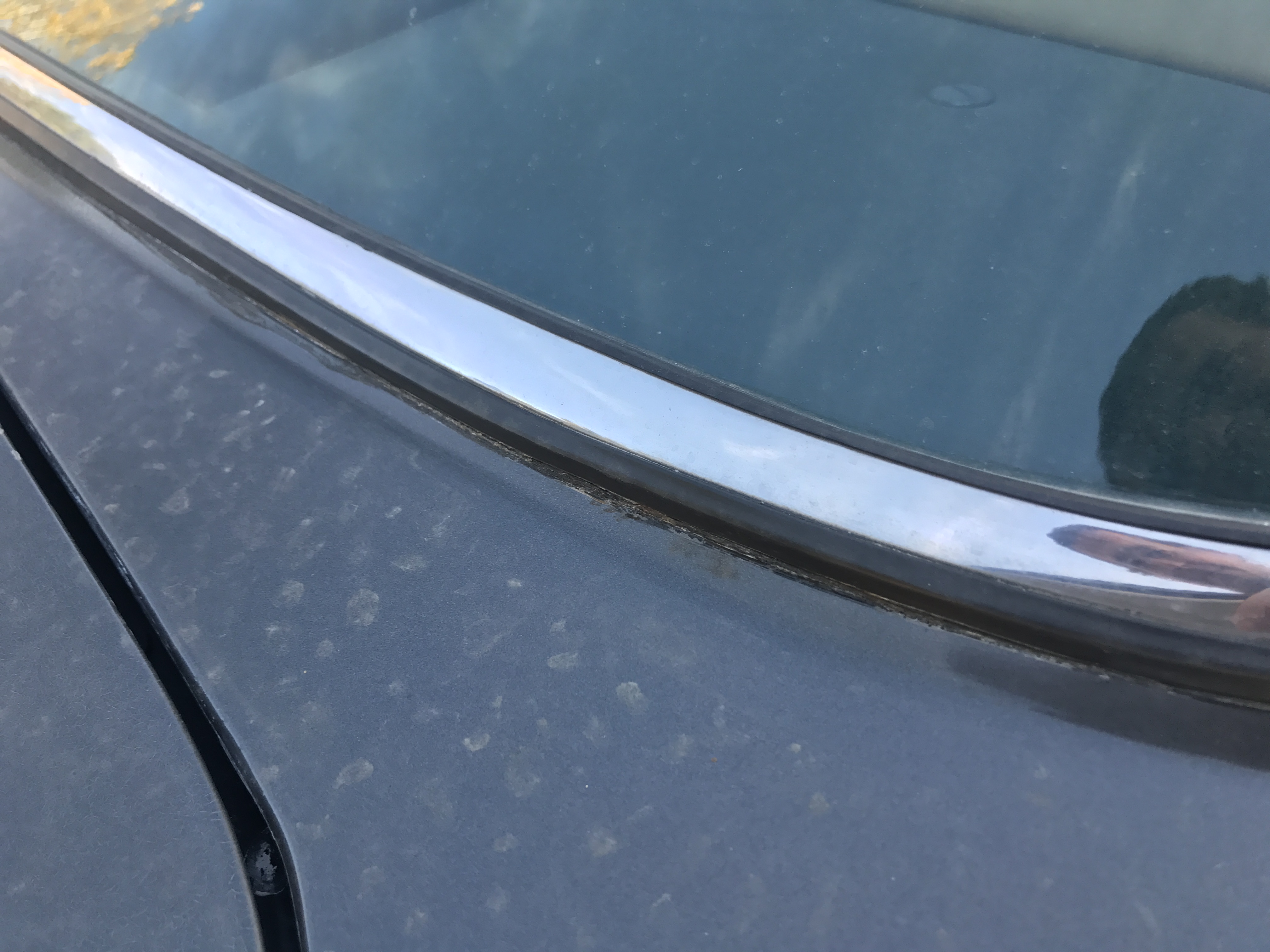

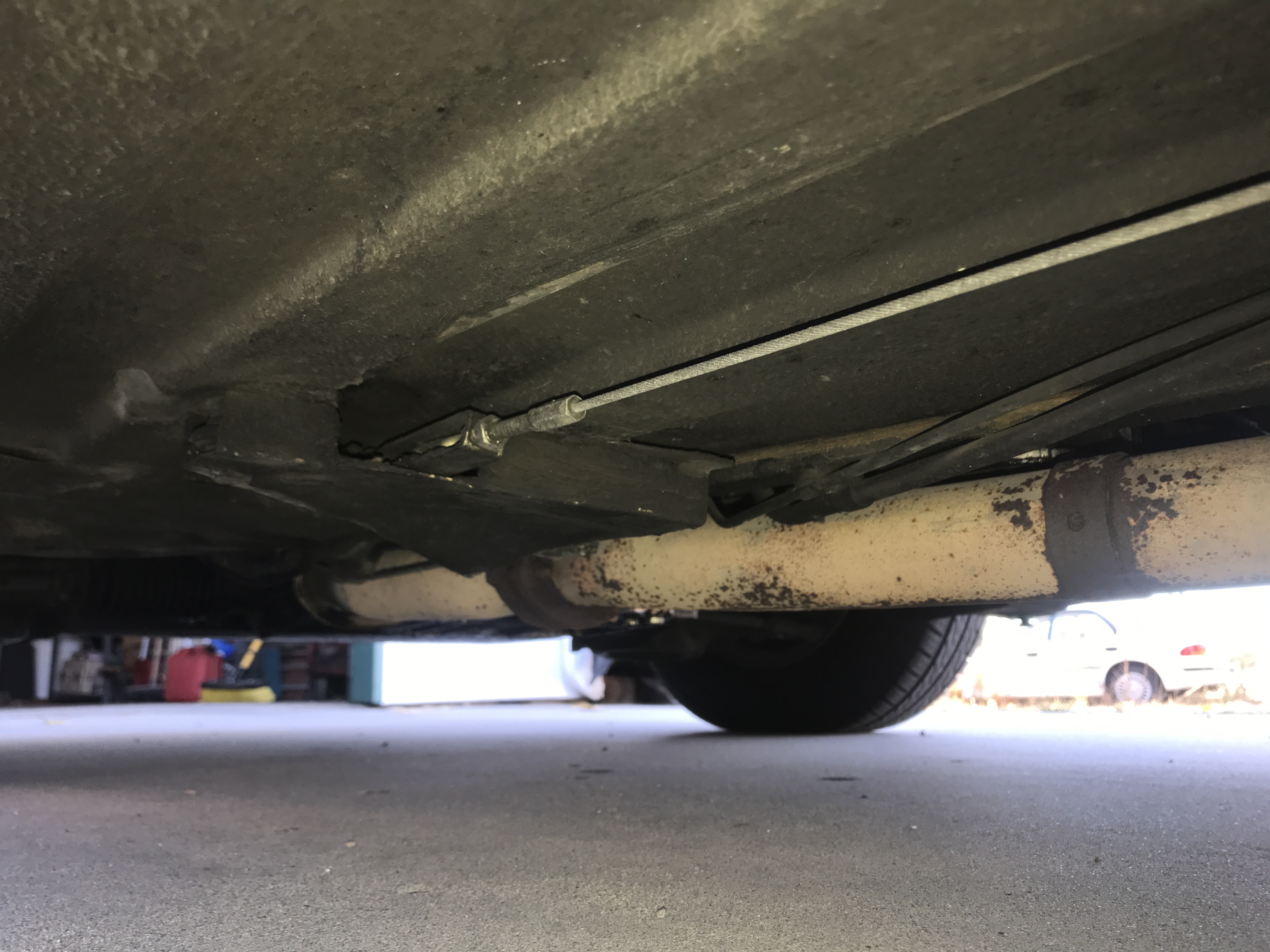

Here I am again poking around at series 3's again. I looked at one today, daily driven '86 165,000 mile XJ6. They're down to $2,000, but after looking at it, it is more like $1,000 I think, body and undercarriage are actually in pretty good shape. A couple rust bubbles underneath the front wind screen. Being daily driven, they have replaced various parts along the way in the past 10 years...AC unit, vacuum pump, plugs, starter, tires are two years old, etc.
My main concern is no head gasket change ever at 165,000 miles (and ofcourse no tappet stake down kit). The engine was pretty oily, and it definately showed it leaked by the pan he had under the car. He said it'd go through a full quart of oil between oil changes (how often, I don't know, he takes it to a shop). From my understanding, most all of these leak, but how much is acceptable? Also, I found white build up or residue at the muffler joints underneath. It looked like what you would find on corroded battery terminals, soft and flakey. Is this white residue indicative of a possible head gasket problem with water in the exhaust, just condensation build up in the mufflers, or other?

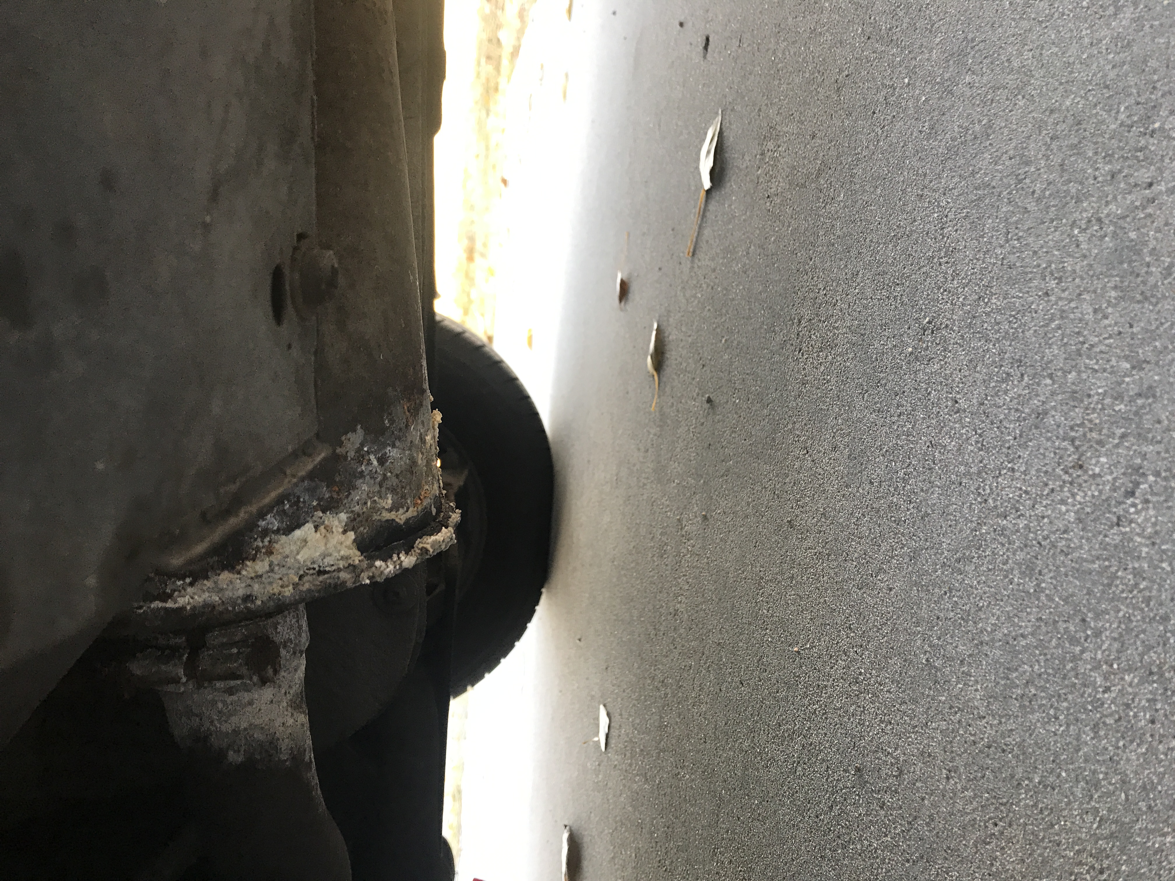

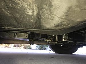

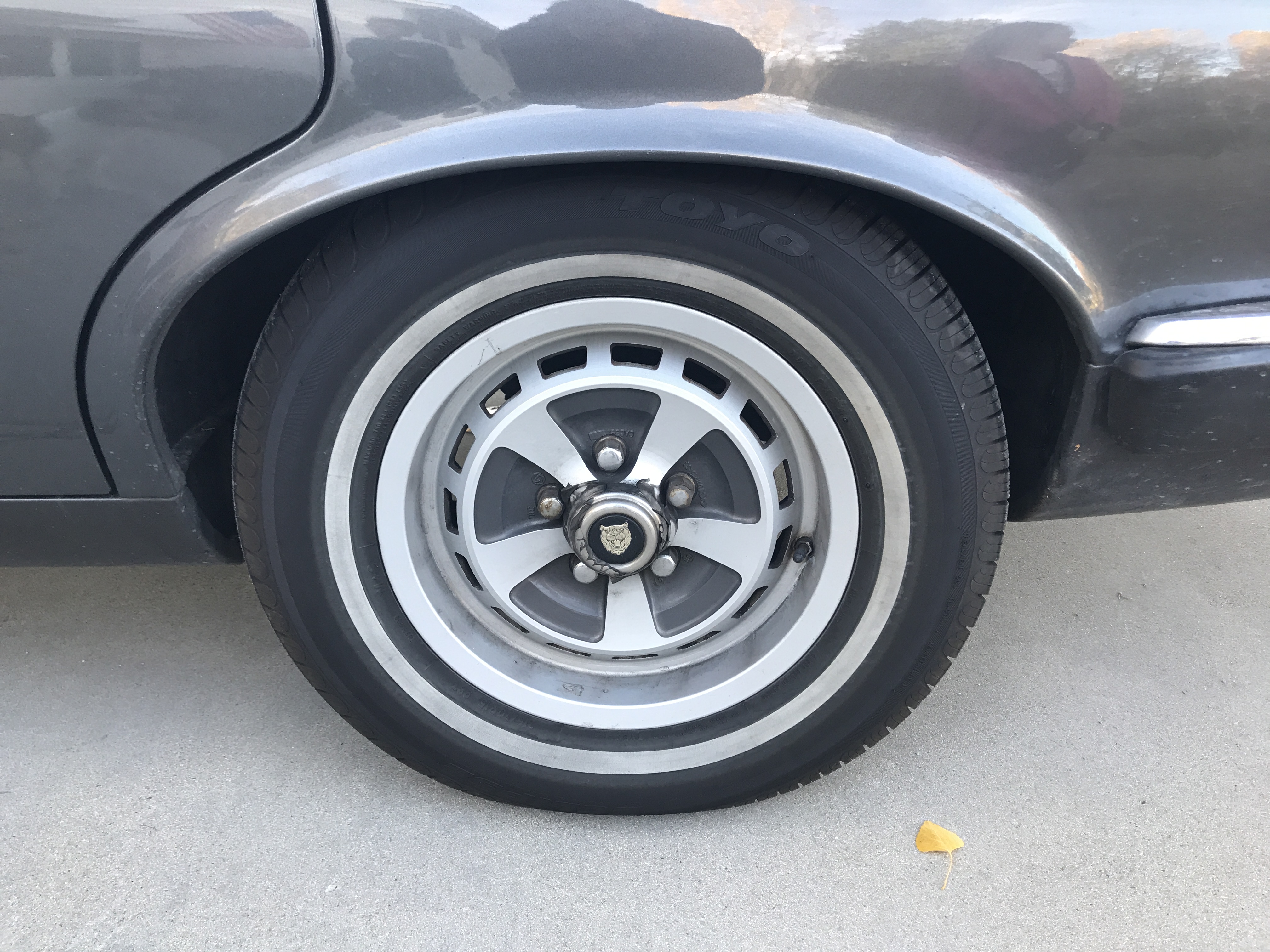

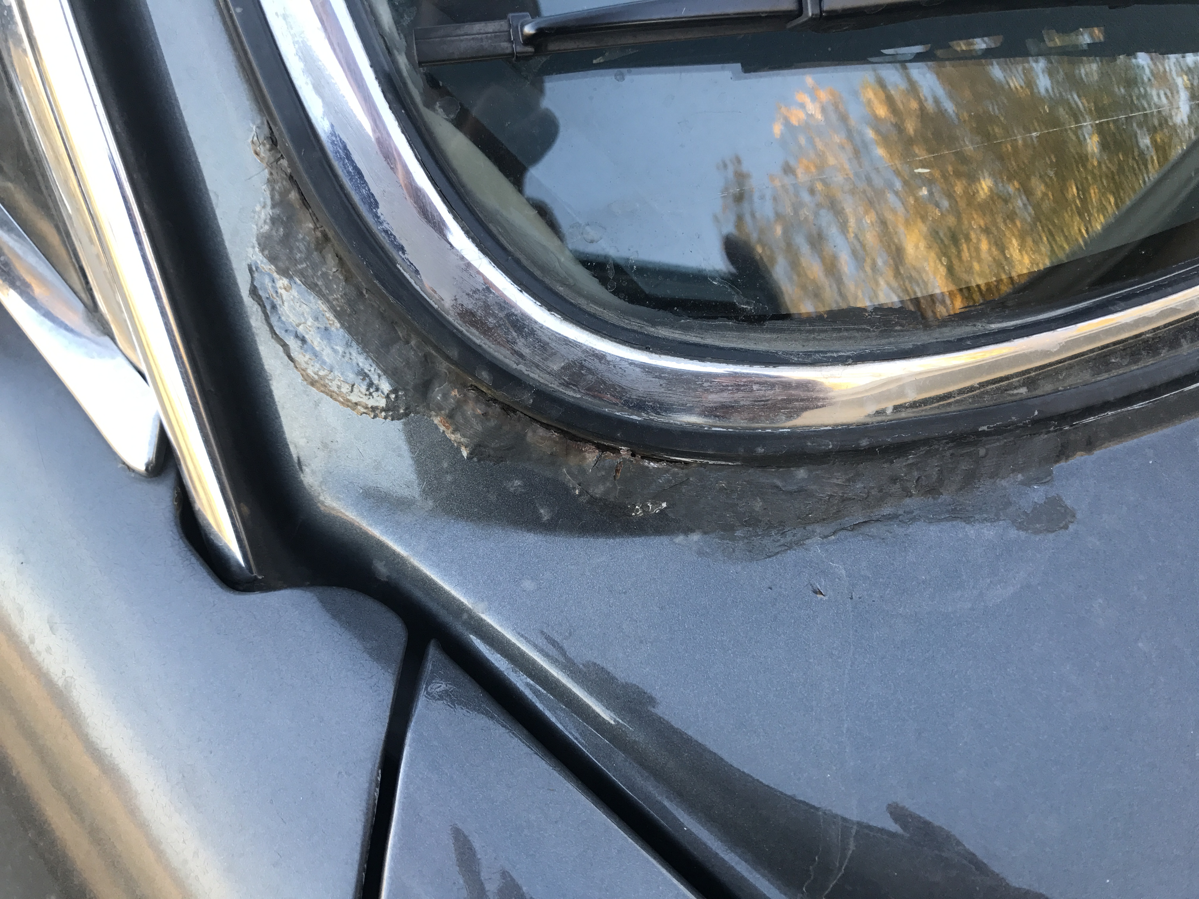

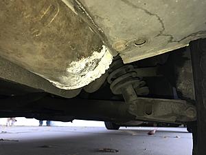

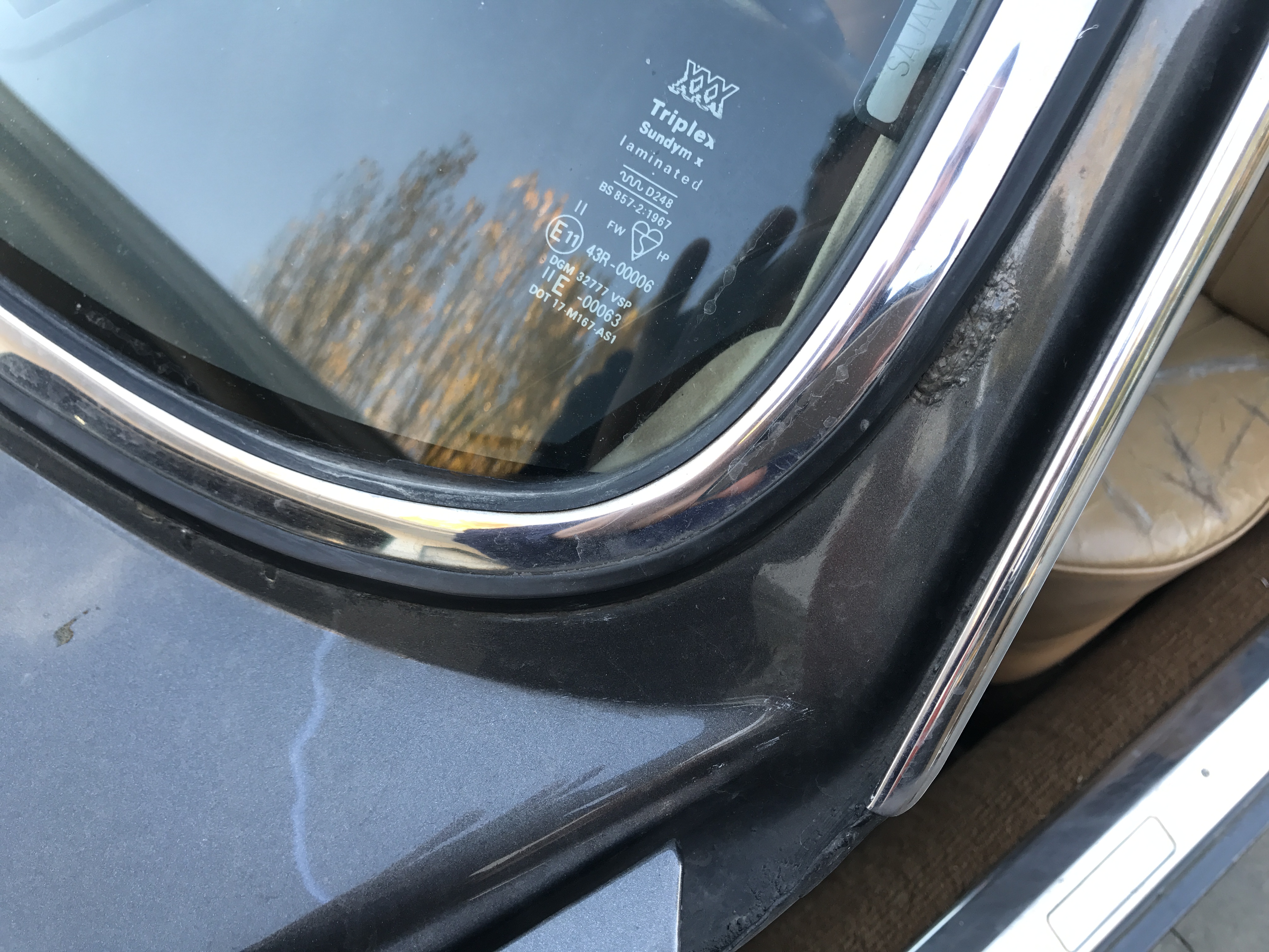

Yep, that was the worst corner. The opposite corner up front wasn't as bad. The back didn't really have anything. A bonus picture of his taped hub caps on because they would blow off in the car wash.

1. White powder. How is the PH of your local water? Mineral residue. Not condensate as it should be mineral free! From the combustion chamber? Not good. What does the coolant and filler necks look like? Dosed with a mineral based stop leak?
2. Stake down is a lessor issue than the rust. As Doug opines, it is far worse than you see. Fixable, for $'s. I wonder how it fares in a wash rack!!!
3. The cap oddity is fixable by rweaking ghe tangs on the ca for a tighter fit.

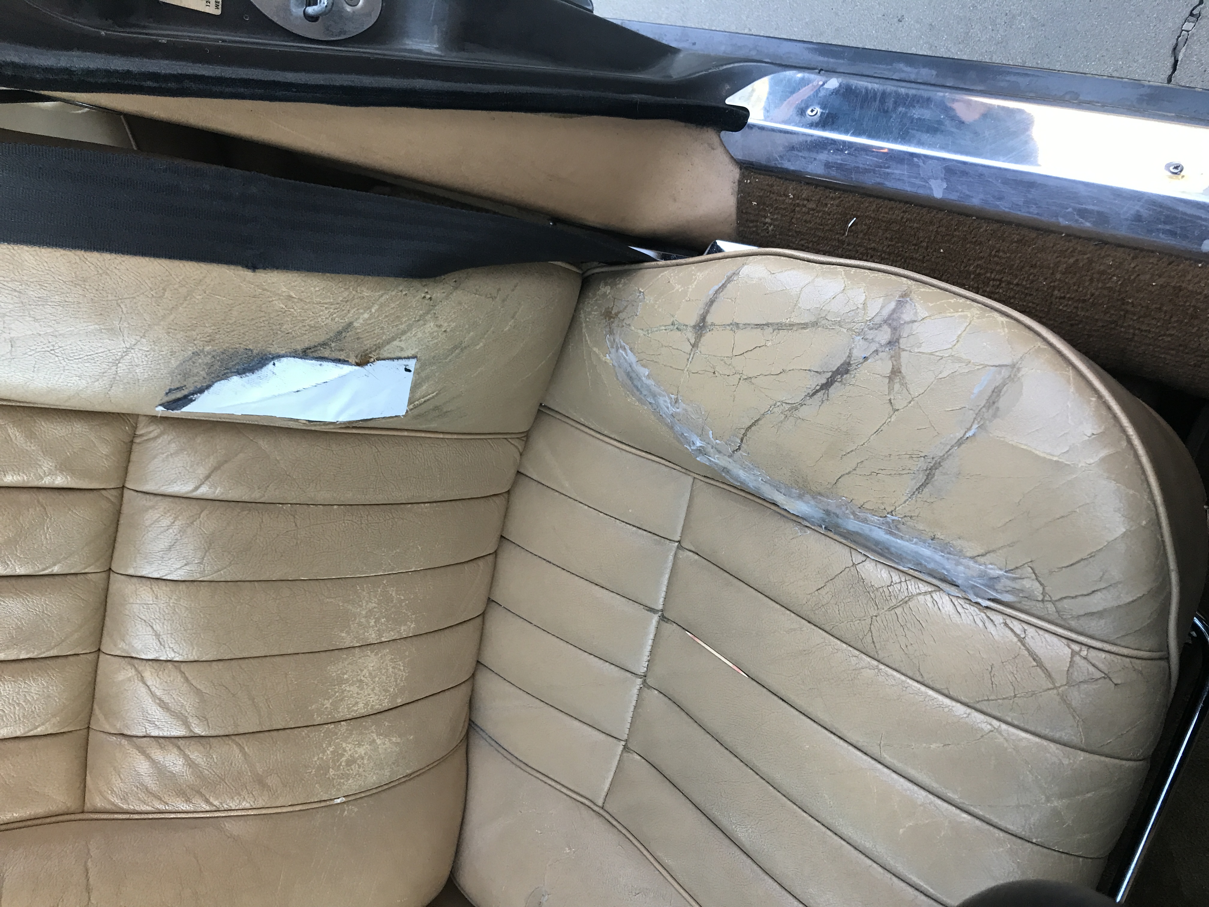

4. Wear spot in the driver seat?? Fix or cover?
5. As to the HG, miracles do happen. I'd price the cost of the fix andd Deduct from the 2K asking price.
6. Remove a spark plug or better yet, several. They will tell all. oil consumption and coolant leaking.
7. If he does the OC at each 3K, I' accept the loss of only a quart.
8. The "uses no oil" is a myth. A thread for another day.
9. In my opinion, S!500 is the value.
10. It is a decent looking car and worth a fix Just a matter of sweat and/or money... Far worse get fixed and roam the roads.

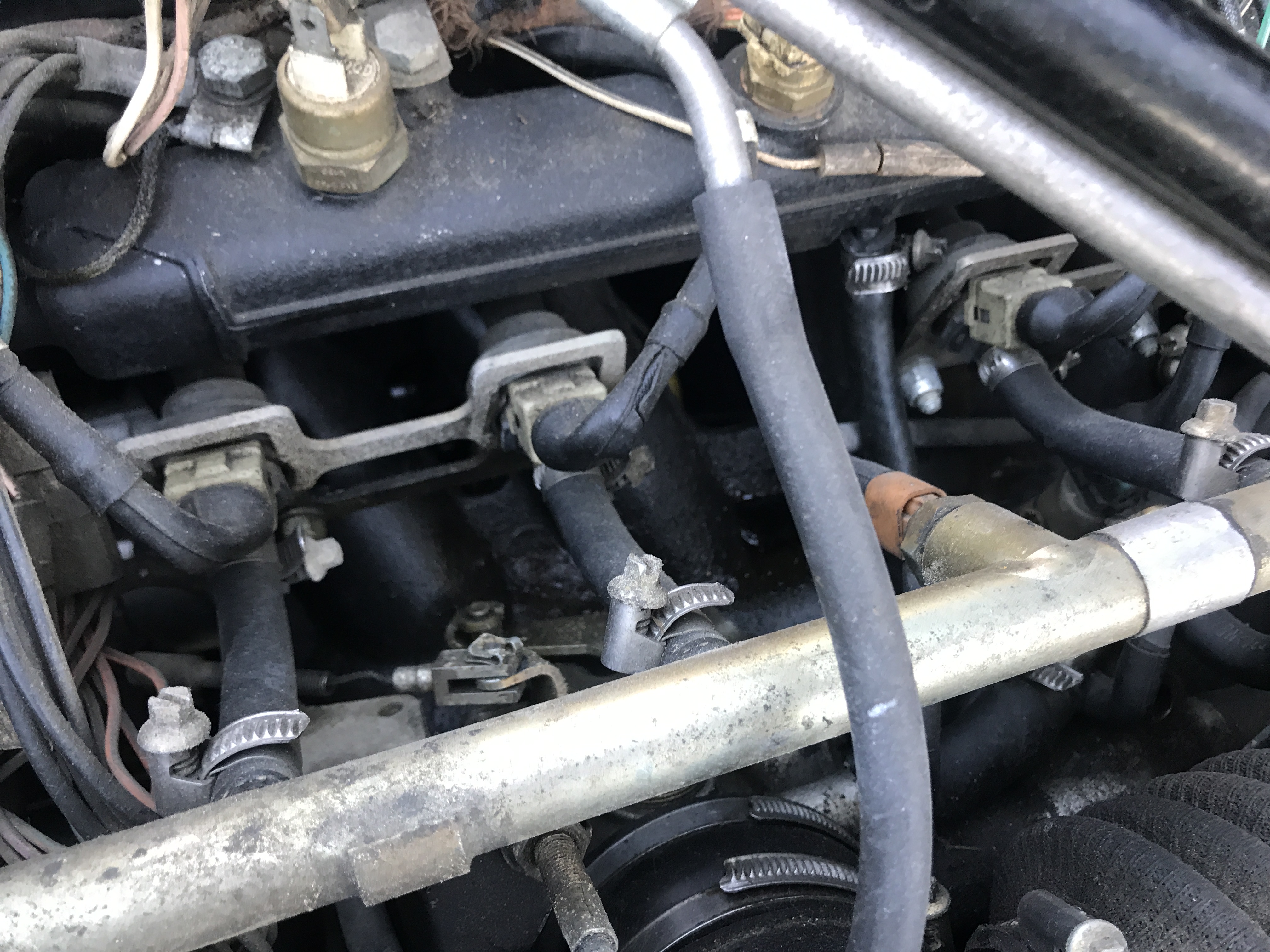

Thanks for the replies! I think you are right, there is a lot of work to be done and it is looking closer to a $500 car. I attached one more picture, which doesn't quite capture the filler neck. I added one of their photos, too, but it is not very clear.
Water is rather hard around here, so it would be from that. I do not remember seeing any residues under the hood though, only directly in front of both mufflers, which is why I thought perhaps a HG going. I didn't notice any smoke while the car was running.

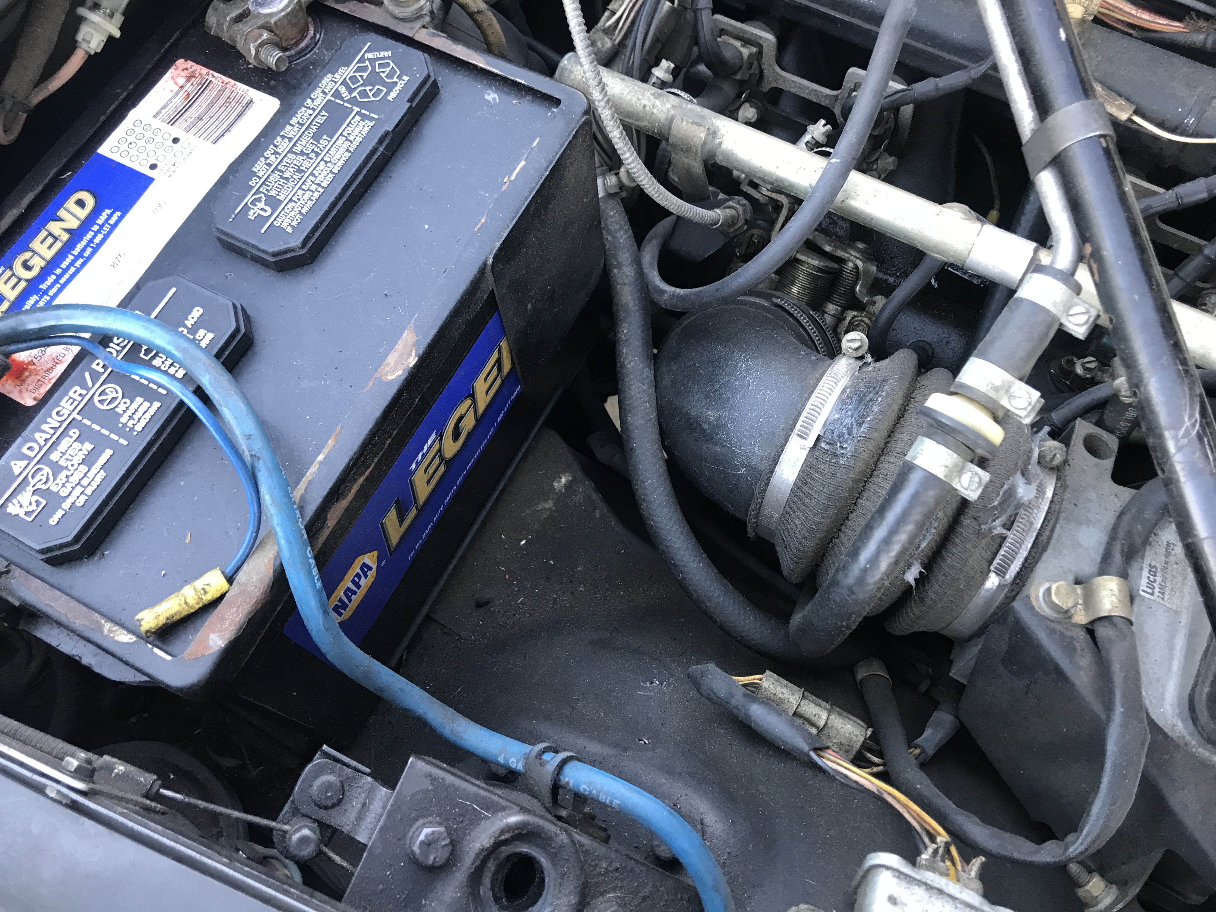

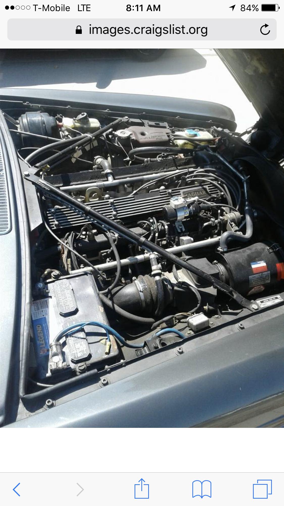

The battery and it's cables are at odds when compared to my car?
Top post instead o a side post. And backwards? The posts to the front seem far more proper than to the rear as in this car.
OTH, I leaned, the hard way as is my wont, that top posts batters are more forgiving than the side post versions. Don't ask....
