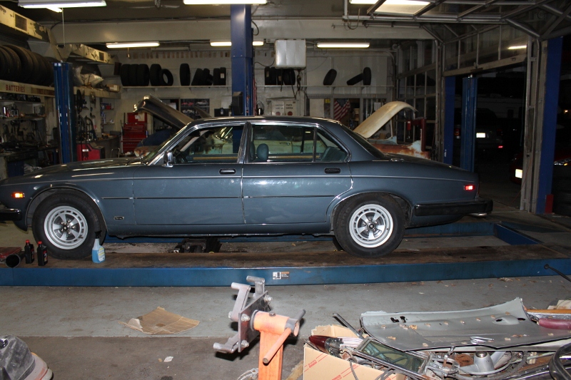

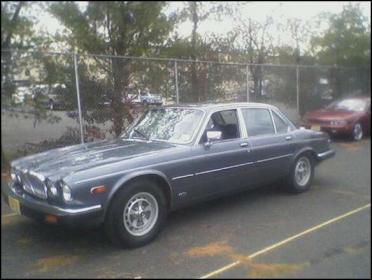

Default switchin it up
Im going to swap the wires to alloy. i had a pair in storage and just cleaned them up. im having trouble removing 1 lug from the busted wheel. just destroyed my crowbar and all i loosened up were a few of my ribs.

Alloys: good decision :-)
Your car: it looks great. That shade of blue has always been one of my favorites on a Ser III.

Default Alloy wheels vs Wire Wheels
I made the switch yesterday...and yes Doug, the love affair ended as soon as i began my journey home from the shop. The ride was smoothe. No issues other than the my passenger side rear wheel not having a center cap by the time i got home.
