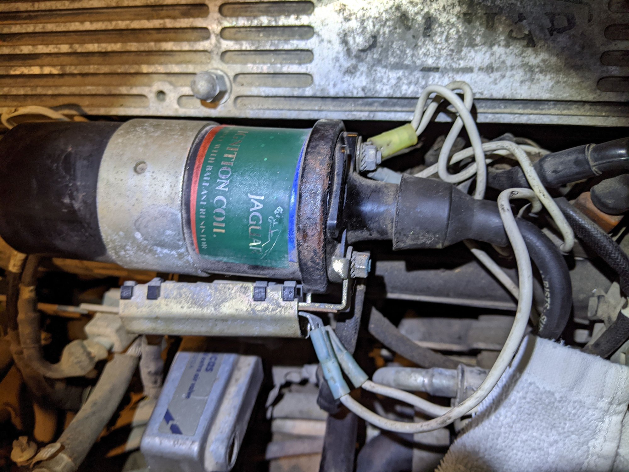

Found thread regarding coil test
Engine cold
Key on
Battery = 12.13V
Both - & + terminals on coil = 11.6V (i.e, with in 1 V of battery) =? coil OK
But I couldn't determine which was+ and- terminals...need to know that before next step
Also, should I repeat this step with engine hot and won't start?
Can you help?
Old Aug 15, 2023 | 06:33 PM
Doug's Avatar
Posts: 25,528
Likes: 11,721
From: Pacific Northwest USA
The coil terminals are normally marked "-" and "+" but the markings are sometimes quite small
Anyhow.....
The "+" post will have white wires attached, and/or a ballast resistor with white wires.
The "-" post will have white/black wires and a white/slate/blue wire.

Thanks Doug. As you can see all my wires are white. I must have had coil replaced in past. Obviously (+) terminal is the one with ballast and I can now ID the two wires that go (in a bundle) to ignition module. Is there an ohmage across ballast that I should check and , finally, would it be best to remove the big black "can" (?air intake?) to more easily access the ICM. Again,,,Thank You.

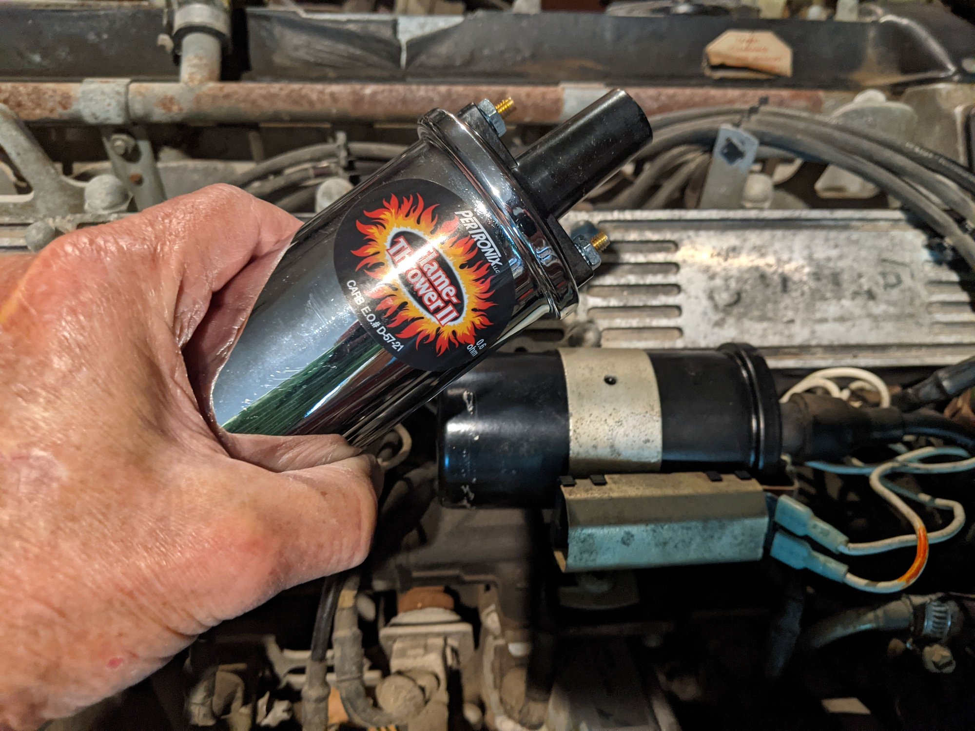

David, Doug and all...I've completed fix. I let engine get hot and started right off. David...I used generic (Standard) coil for now but I've ordered Petronix 45111 Flame Thrower for my next project. My antenna broke off in car wash so I'll do that first. Antenna motor runs when I turn radio on but antenna won't come up. I'll look for thread but if you have any suggestions, I'm all ears. And many thanks for all your help!

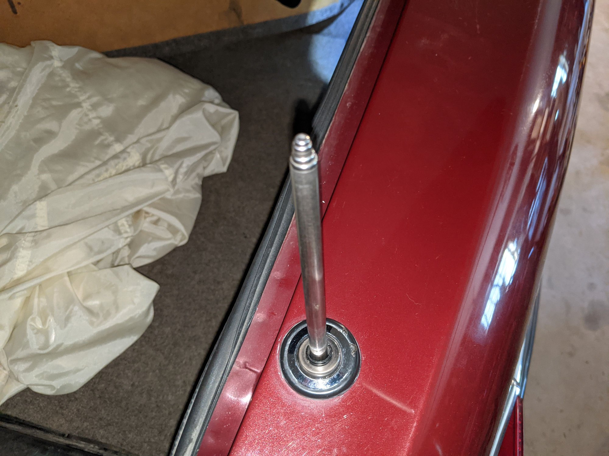

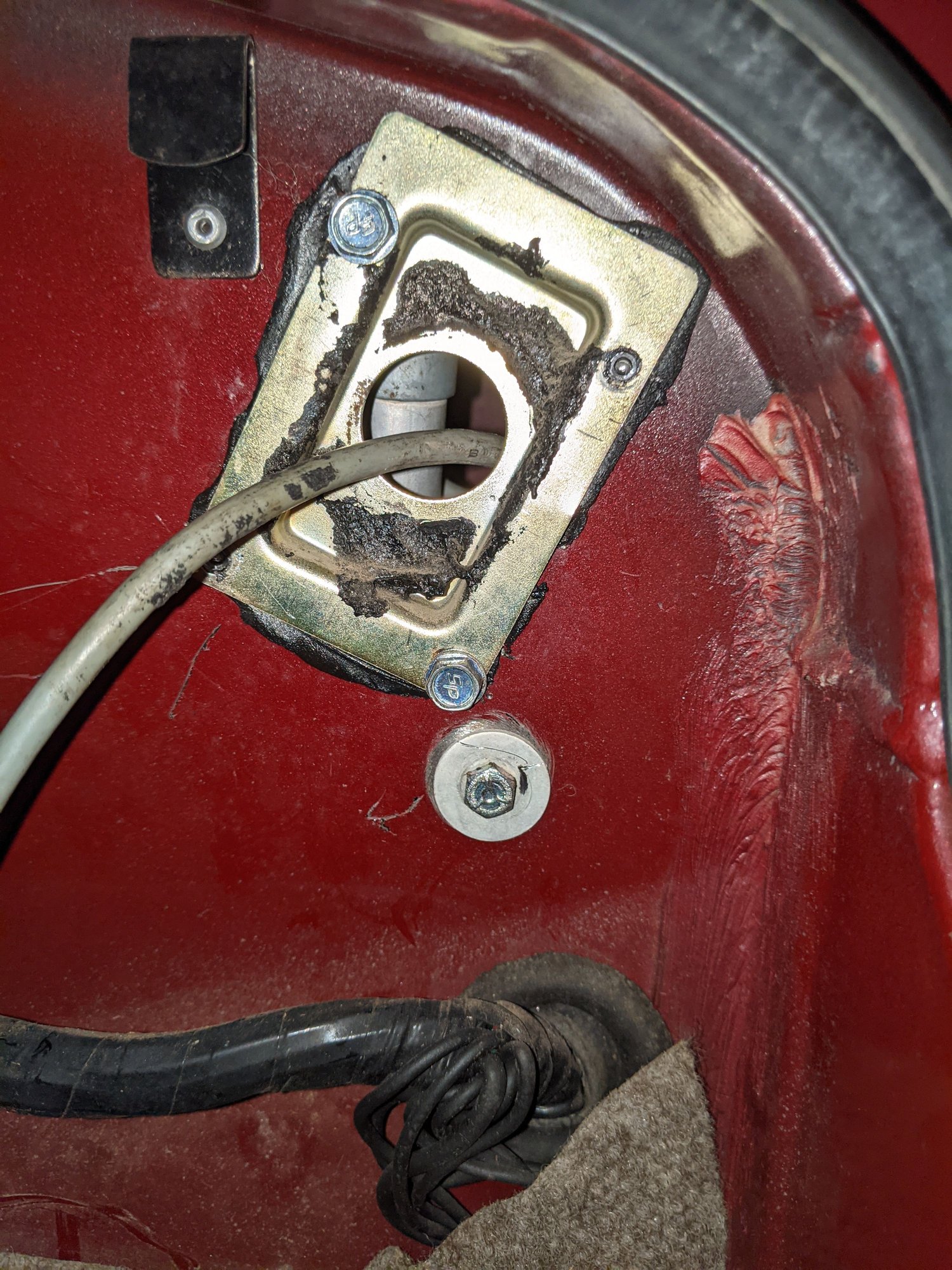

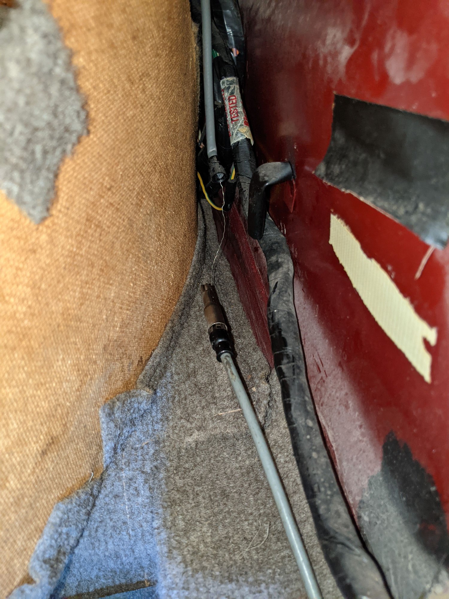

I've watched a few videos and threading cable looks a little hairy to me. Furthermore, I bought a new mast about 2 years ago after the carwash incident and a local auto shop tried to fix it and some of wiring looks a mess. It looks like a plug was broken and spliced? Also should I move to a new thread? Sorry about huge pics.

Time to swap stock coil with Petronix 45111. Can I assume I don't use external ballast?
Old Aug 31, 2023 | 01:59 PM
David84XJ6's Avatar
Posts: 782
Likes: 459
From: Central California
Time to swap stock coil with Pertronix 45111. Can I assume I don't use external ballast?
Normally I would just toss the ballast, in this case we are Trouble Shooting by replacement of parts, So leave it in until you have success with the original problem.
