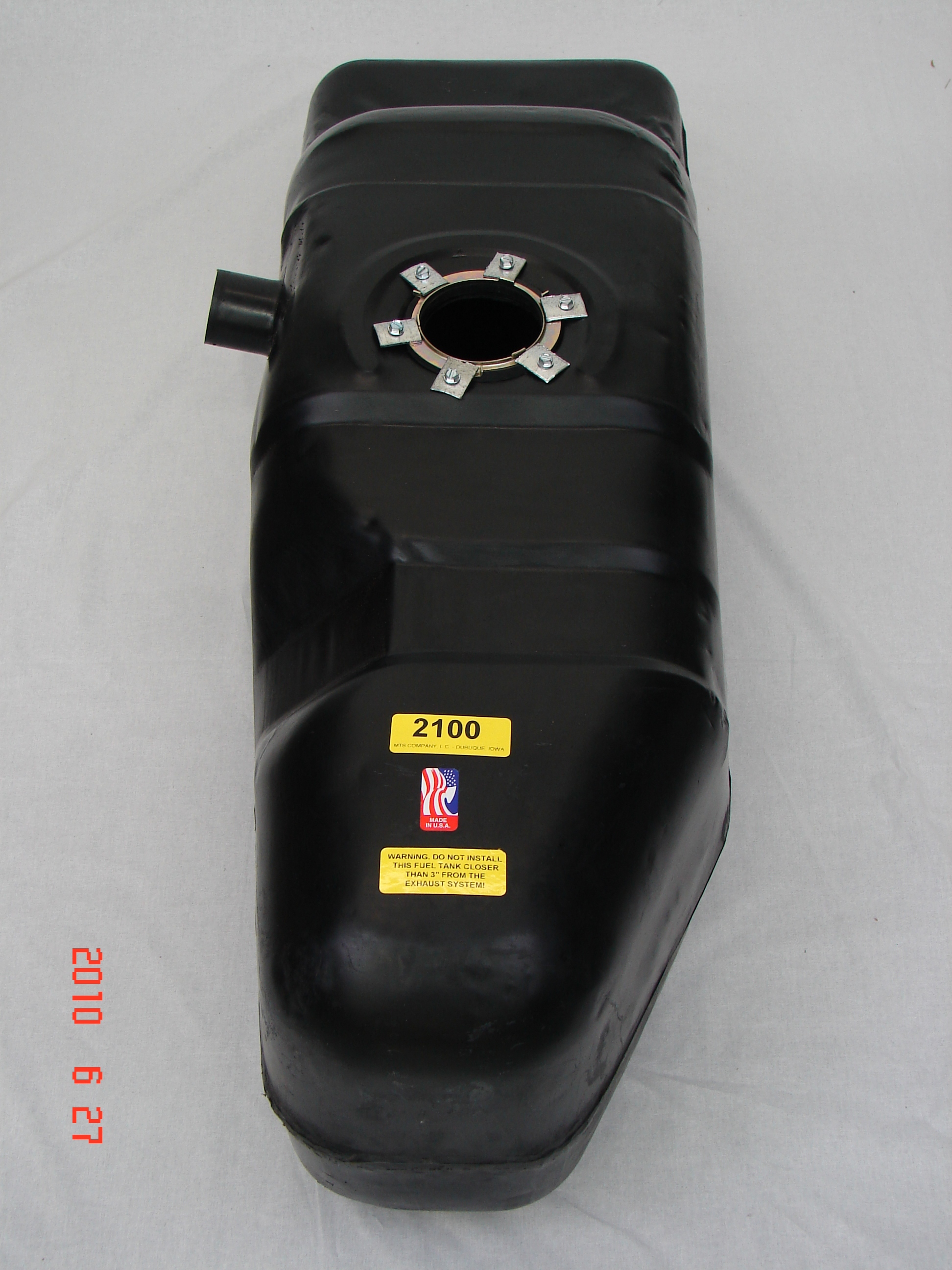

Also, the gas tank from a GM S-10 pick up truck seems as it will fit.
http://www.mtscompany.com/images/chevygmc/2100.jpg
It is 39" wide x 12" x 13". Best thing is that they are made of polyethylene! No rust ever. Gas inlet is on the long side. They come with the pump and level sensor mounted on top. Quick check shows the std GM fuel pump gives 60 to 65 PSI (S-10 with 4.3 liter V8). It should be ok for the v-12.
