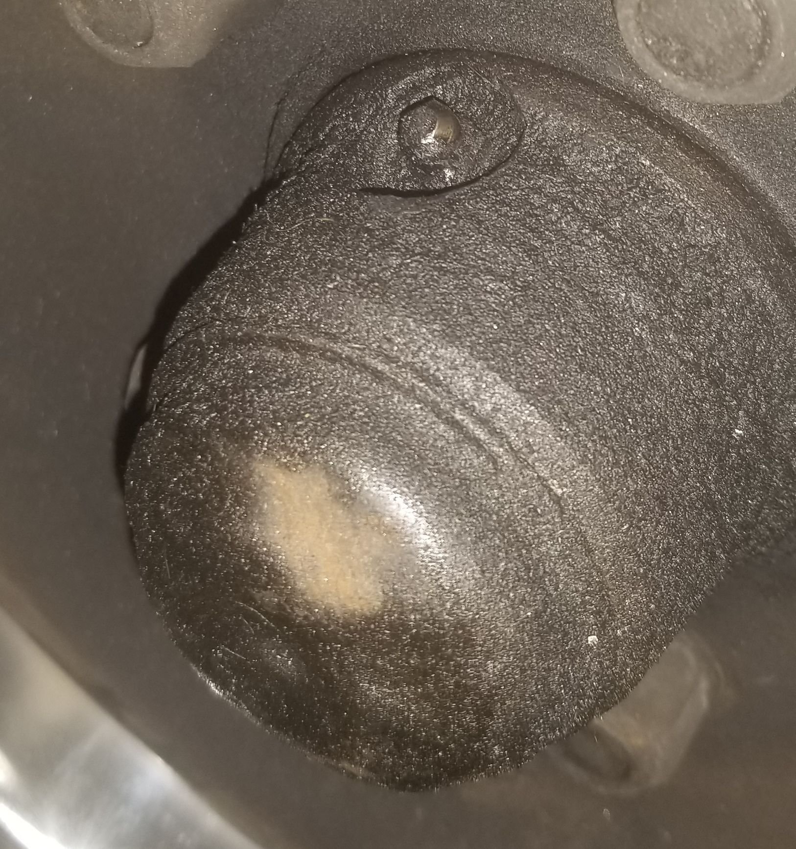

Pulled off a hub cover that needed to be touched up & wondered where all the black build up came from inside.
In all our questioning of the engineering, has anyone mentioned this common sense solution to a concern.
Old Feb 2, 2021 | 10:55 AM
JagCad's Avatar
Posts: 6,796
Likes: 2,403
Heat hardened grease that ooozed past the cap ?

The "zerk" fitting that is in the front hub, shown in your picture, is where you would plug in a grease gun and start pumping. The plan would be to remove the dust cover so that when the cavity is full and the grease you're pumping in has to start squeezing out through the outer bearing, you can see it. Instructions are written that say you should keep pumping until all the old grease pushes through the outer bearing and you see fresh grease coming out. Job done. All that unused grease between the bearings, and then there's the inner bearing. The inner seal is directly behind the bearing, so where is all the old grease going to go? Out the seal?! If you manage to stop pumping before the seal goes, then you haven't put any new grease into the inner bearing.
