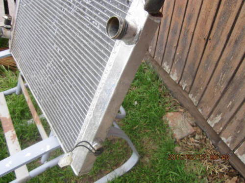

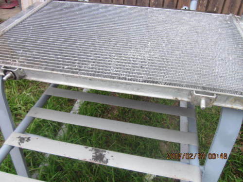

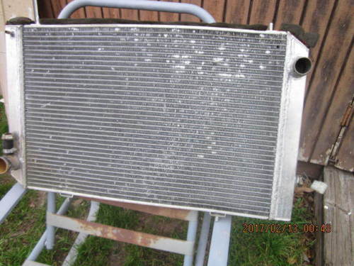

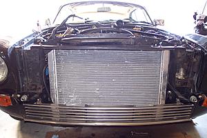

These are the photos when I bought it off EBay. And the fourth photo is it dry fitted up. It's thinner than the stock and I'm going to go with a new condenser, but I haven't chosen what it's going to be yet.
Attached Thumbnails XJ6C Cleaning up engine bay-s-l500.jpg   XJ6C Cleaning up engine bay-s-l500-2.jpg   XJ6C Cleaning up engine bay-s-l500-3.jpg   XJ6C Cleaning up engine bay-dcp_0021.jpg

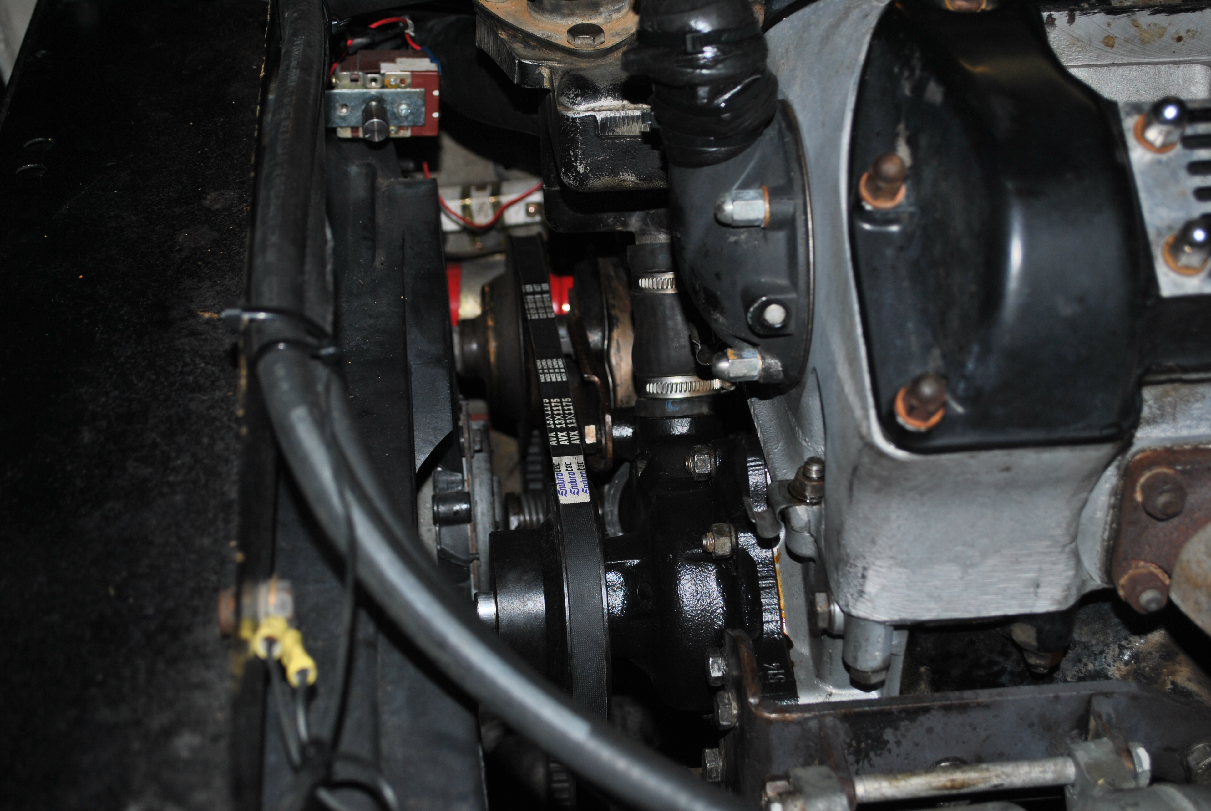

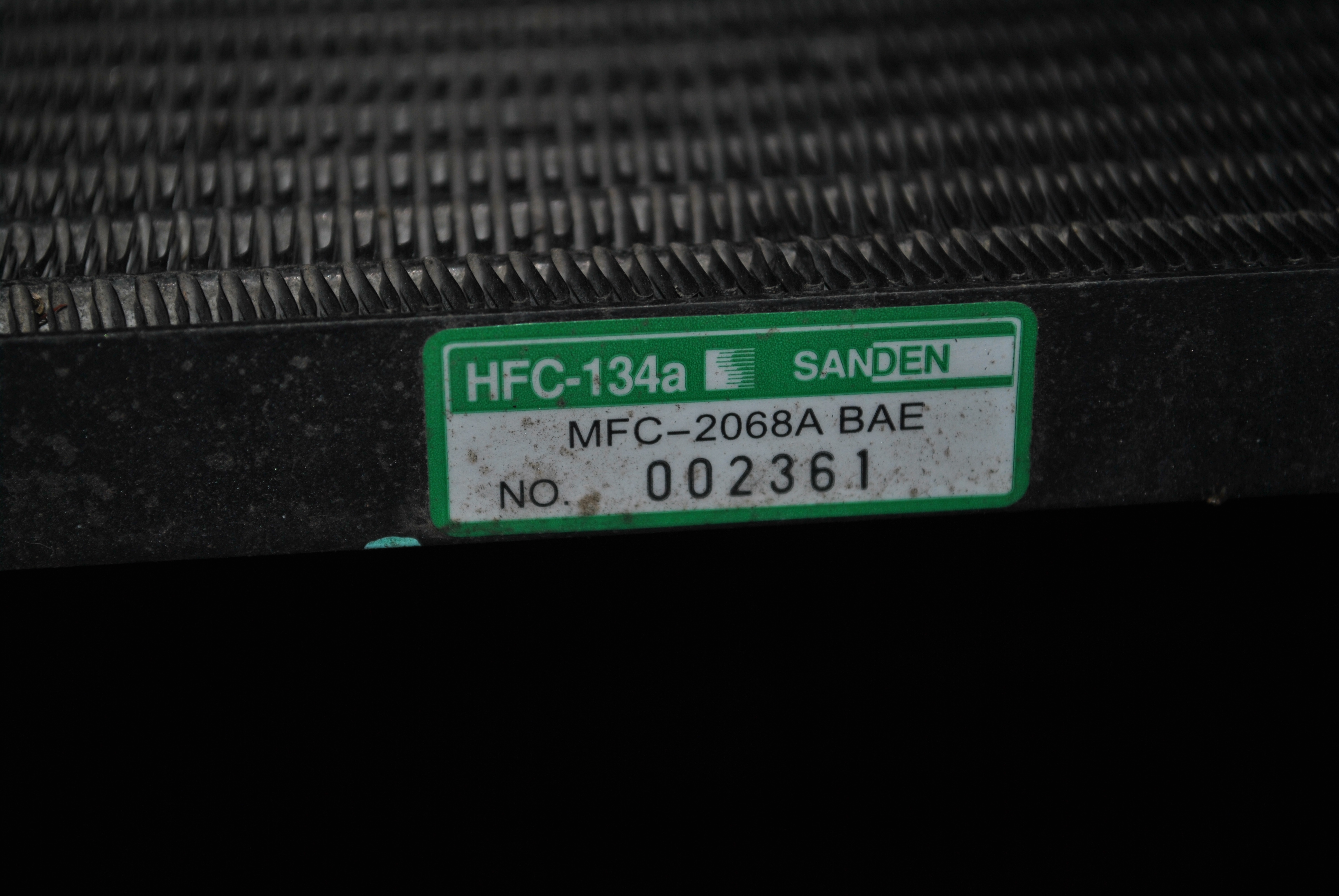

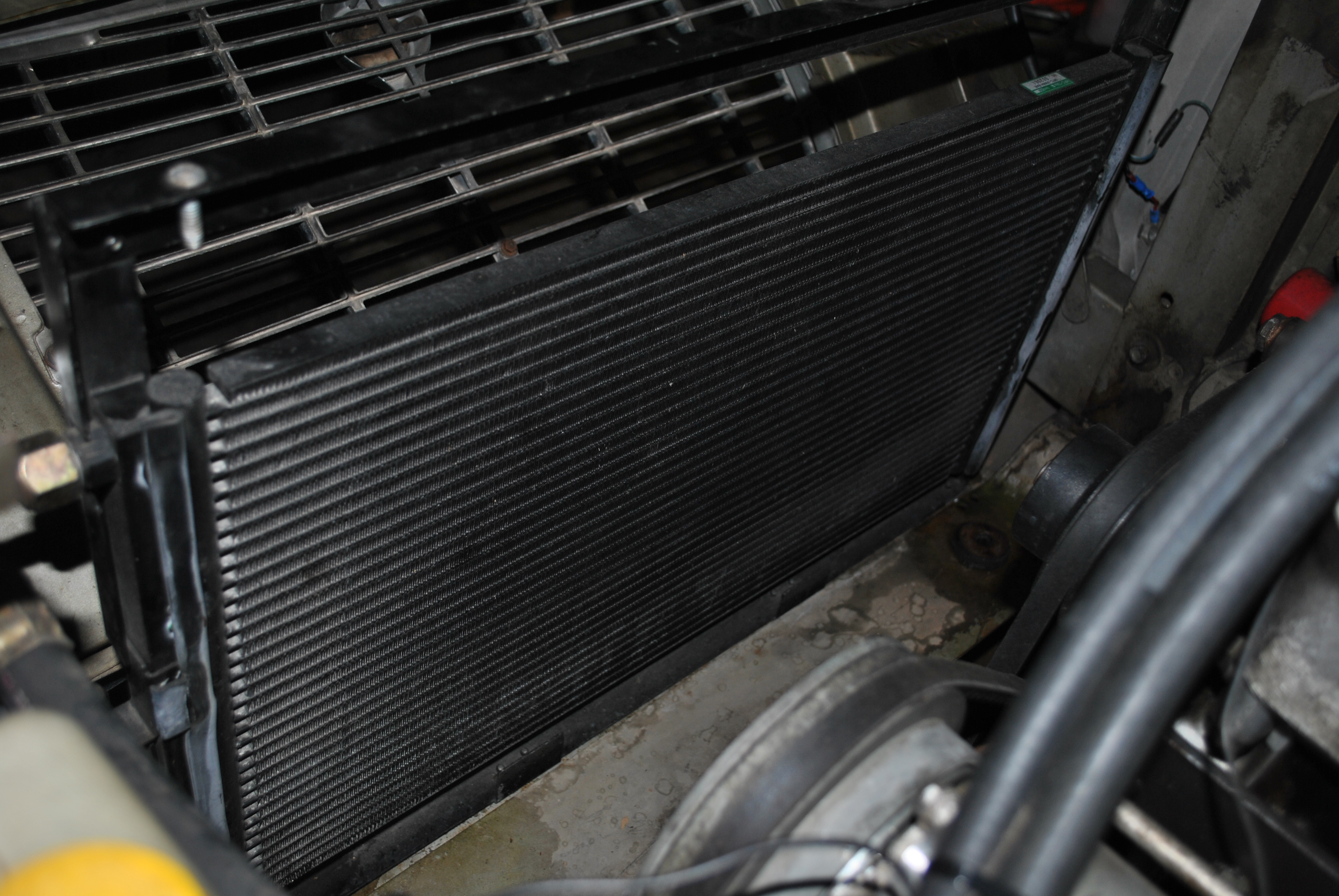

I have a Sanden condenser, thin and fits the space well. I also have Ford (1990's) twin electric fans fitted.
XJ6C Cleaning up engine bay-dsc_3711.jpgXJ6C Cleaning up engine bay-dsc_3714.jpgXJ6C Cleaning up engine bay-dsc_3719.jpgXJ6C Cleaning up engine bay-dsc_0100.jpg

That being said, I will stick with my viscous clutch and steel fan and spring for the water pump that fits that. And... I'm adding two 12" electric fans. Also have an aluminum radiator I'm going to try out (see pics above).

Clarke - I can't find the Sanden condenser that you have. Would love to school off someone who has done this before. It looks like you eliminated the mechanical belt driven fan altogether? What A/C compressor did you use? Thank you, Bill
The condenser came with the car so can't help with a supplier. I used a "Sanden Style" compressor off ebay. The belt only drives the water pump now. And temp sits well below 1/2 even in Aussie summers.
Originally Posted by yachtmanbuttson
Are any of these the fans you installed?
Any duel fan will do the job as long as it doesn't interfere with with other moving parts. Mine is about the same dimension as the radiator core and held to the radiator with two screws at the bottom panel & two at the top shroud.
