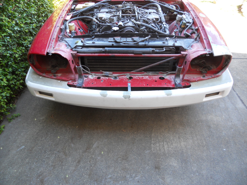

Does your car have 2 orange igniters on the radiator top support? if not it is Lucas not Marelli. If they are there then its Marelli and the crank sensor is on the front RH side slightly under the damper. easiest access is from under the car, there will also be a speed sensor on the flywheel
