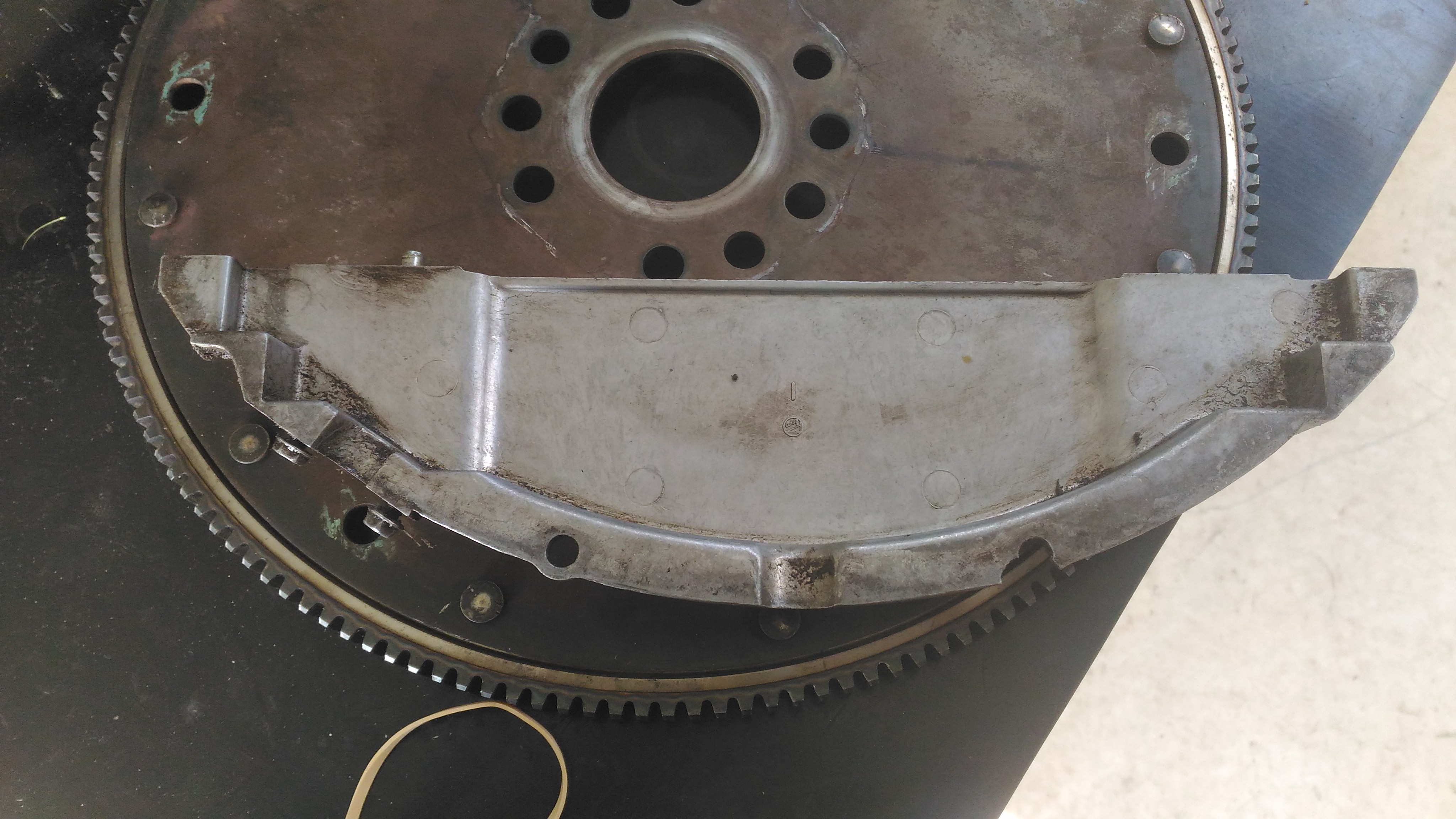

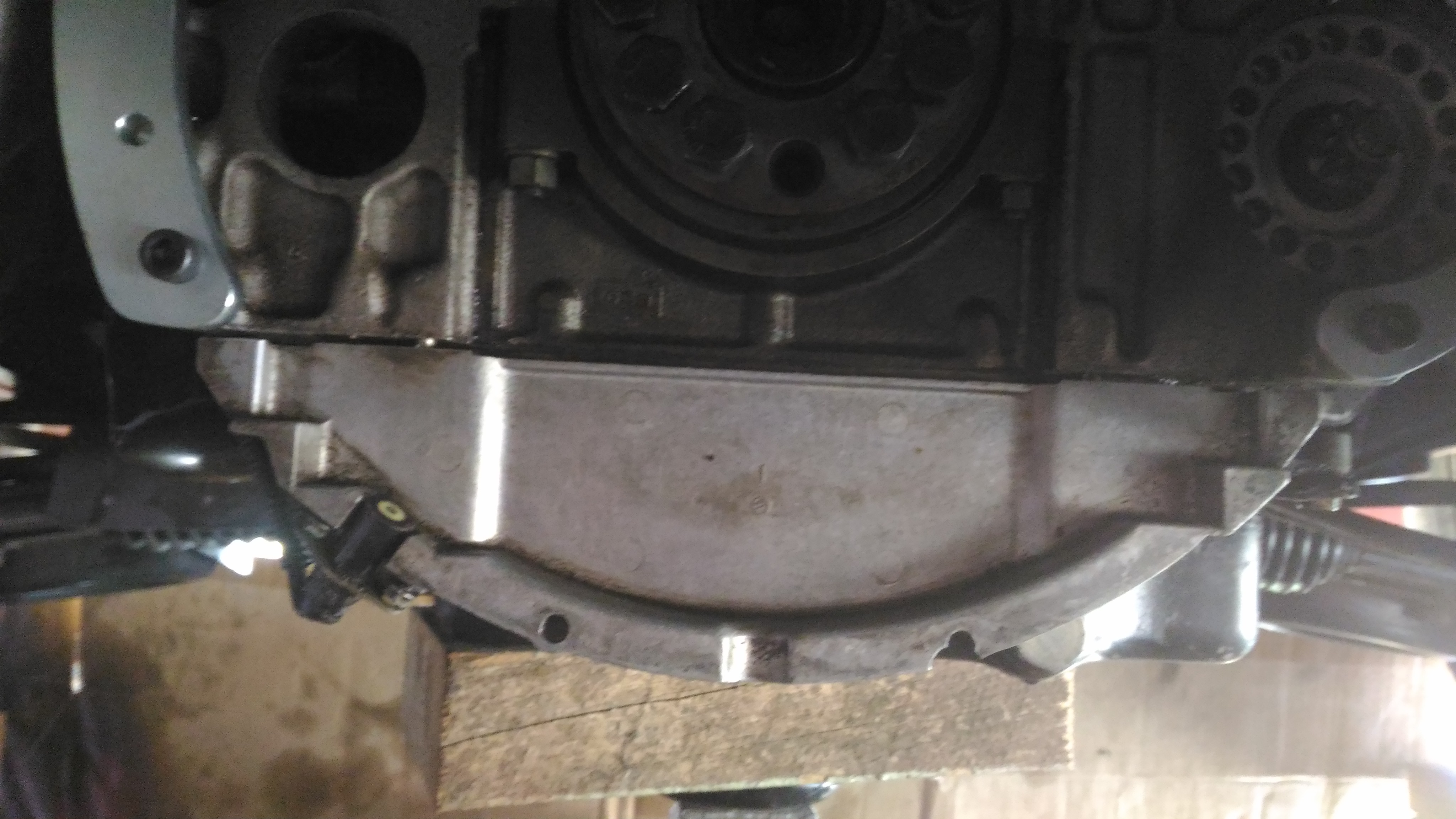

You will need #3. My car did not have the heatshield, and the trans had never been out.
Without the sensor on the flywheel the car will not start. The Marelli ECU needs this for engine speed, without it, the Marelli does not even see the engine cranking so will not provide tach signal to Lucas FI ECU so no injector firing.
My car is getting a 4L60e ATM so if you need any more pics let me know.
