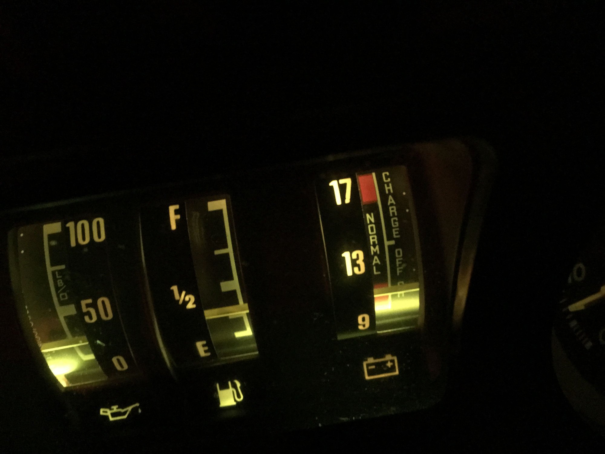

Hello all! Hoping for a little help here, got myself a nice shiny xjs! She is a 1990 5.3 v12, now after a good 2 hour drive home she was faultless! Today however..... not so much! Started her up and the volt meter on the dash was just over the red at the bottom so undercharging but no warning lights? So shut her off and shot inside heading for the volt meter! Checked the battery and it was a steady 17.3 volts!!! Hmmm so started the old girl up and the dash meter was just under 13 now in the normal.... so went back in the boot and hooked up the volt meter and at idle she is putting 21.2 volts into the battery!! Im not sure if I’m doing something wrong with the meter so will take a pic of it later and add on here, I had a car do this once before where the voltage regulator knackered up and it was putting 19v in the battery, but that put EVERY warning light on and most electrics in the car wouldn’t work and blew a load of fuses, but the jag is fine, everything works, no blown fuses no raging inferno from a roasted battery, so I’m a little stumped! Going to check the volt meter on my other car tomorrow to rule out the volt meter being at fault, Any input would be greatly appreciated! Thanks Pete

Old Jun 17, 2019 | 05:42 PM

the meter is on 200V , maybe try 20V???

If this reading is directly across the battery terminals then the reg is almost definitely the problem.
If you run it like this you will boil the battery and it could explode if the vent does not work then you'll have a mess in the boot to clean up. I'd pull the alternator and have it rebuilt.
You can get the alternator out from underneath, it's a real PITA job as all the belts have to come off as the alt is the flat belt closest to the block.

I suspect that voltmeter of yours is out of calibration or just plain broken.

Thanks for the response everyone! Yeah the reading is across the terminals on the battery, I put the meter on 200 as it wasn’t reading on 20 as the car is producing over 20v, I agree that 20v is mega high at idle (around 500rpm) i checked the volt meter against my wife car as I know that is perfect and readings of 12.7v on the battery and 14.2v running, I have bought a new volt meter today just incase, am I right in assuming that if it’s the voltage regulator this can be repaired separately as the alternator is working ok? Or has the regulator been toasted because the alternators gone nuts and started running mega high! Is it possible someone has installed a 24v system and installed a 12v battery by mistake? I’m not sure what goes into installing a 24v system I’m assuming it would require a complete rewire and would yield no benefits over a 12v system but just a thought I had.

An alternator generates 3 phase AC and has rectifier diodes to convert the AC to DC then it has a regulator to keep the voltage between certain values approx 13-15V.
Alternator voltage will be at least 3 volts higher than max voltage required so 20V at idle is about correct if the reg fails. There is nothing wrong with your meter and you were correct using the 200v range as your meter does not auto range.
You will need to remove the alternator and have it fixed.
One thing that does kill alternators is heat and if they get gummed up with oil the regulator can not cool correctly and overheats and dies.

Great thanks for the info, I’m glad I had the meter set up correct, have had a quick look and the alternator is very dirty/oily so I think your right and it’s overheated, I will check the voltage now with my shiny new meter and see what it says.... but think will have to address the oil leak situation too, the whole front and underside of engine is very oily and it had a advisory a 2 years ago for oil leak around belts area, so may need to look into that too
