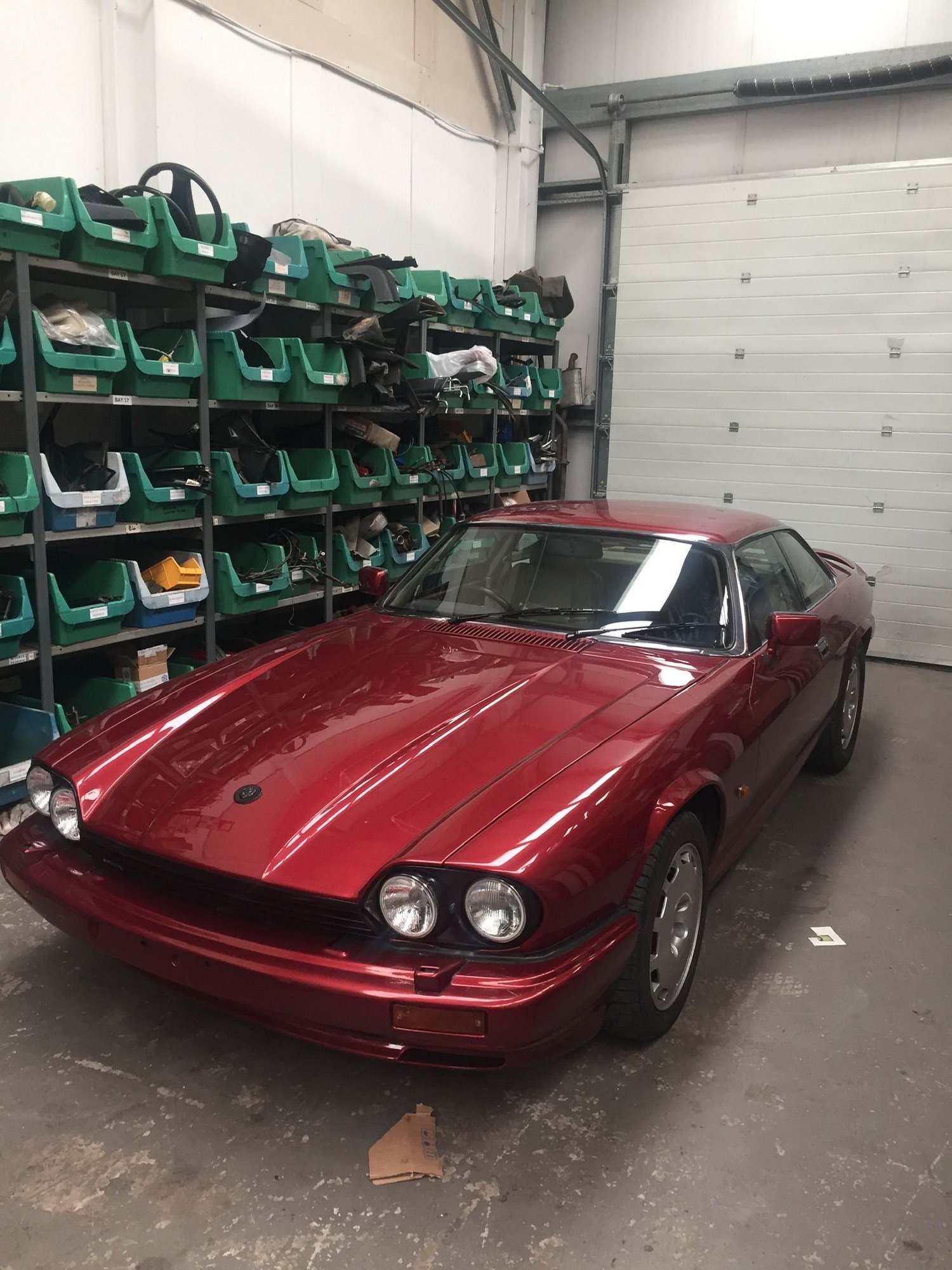

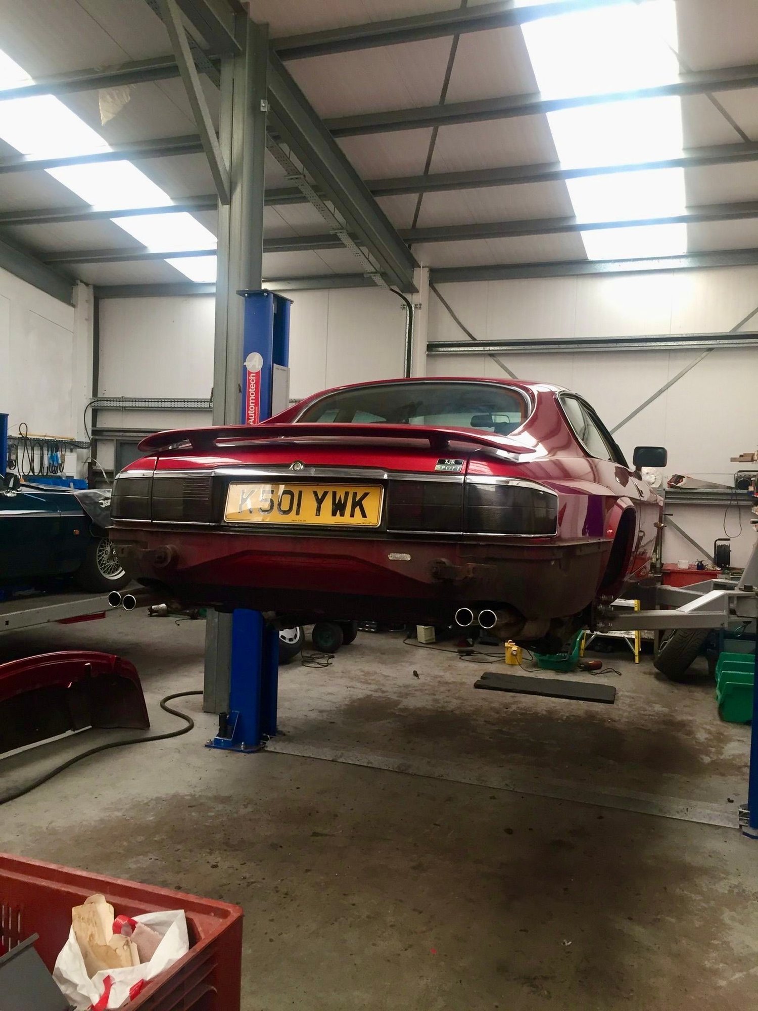

New member here. I’ve just taken on this car as an unfinished project. This forum came up well for technical help and advice on my searches :slight_smile:
What could possibly go wrong!?
I’ve looked at buying an XJR-S for the last 5 or so years but up until now other cars have taken my interest, so pleased to finally be joining the fold.

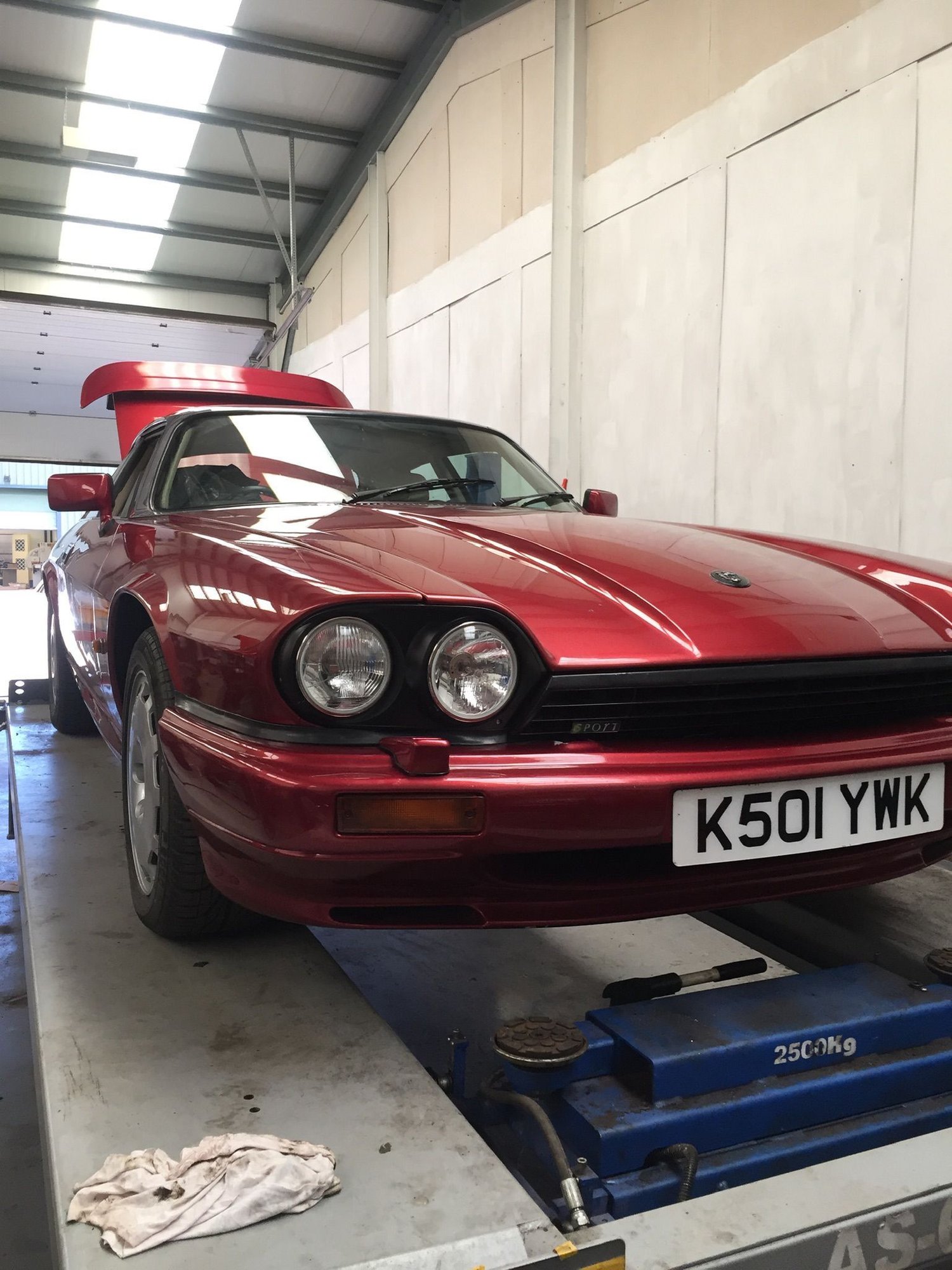

I’m based in the UK and the car is a 1992 XJR-S in Flamenco Red. It was owned by Jaguar Cars of Browns lane for the first 4 or so years of it’s life, probably a management car I’d imagine.

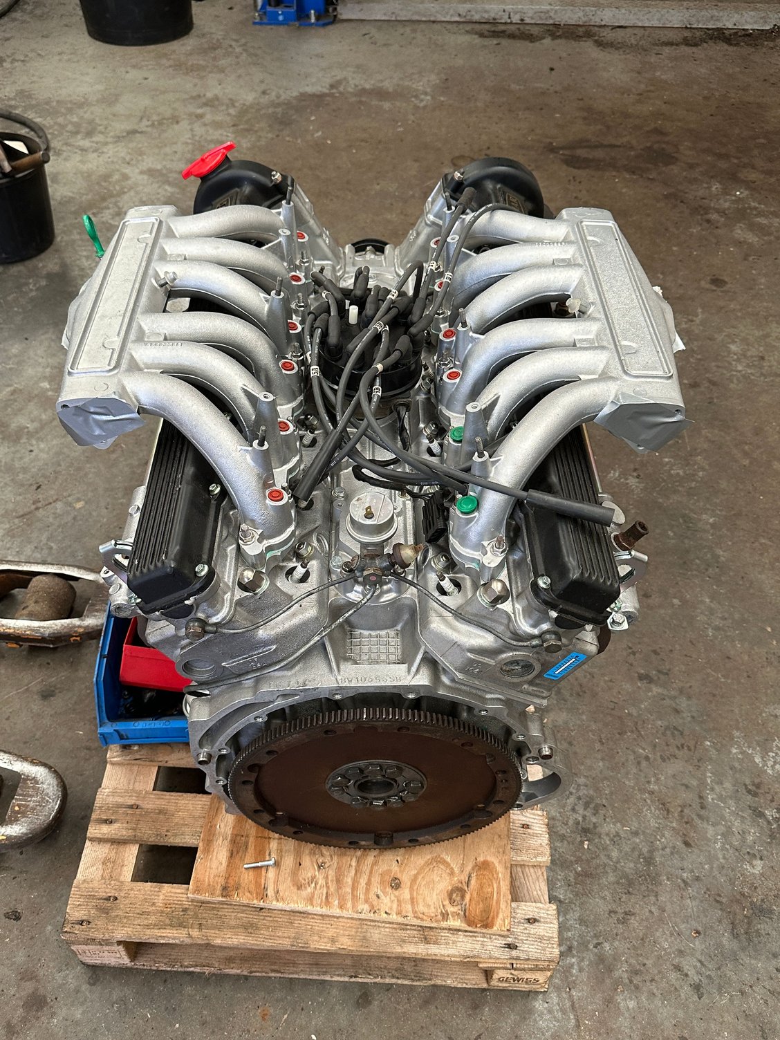

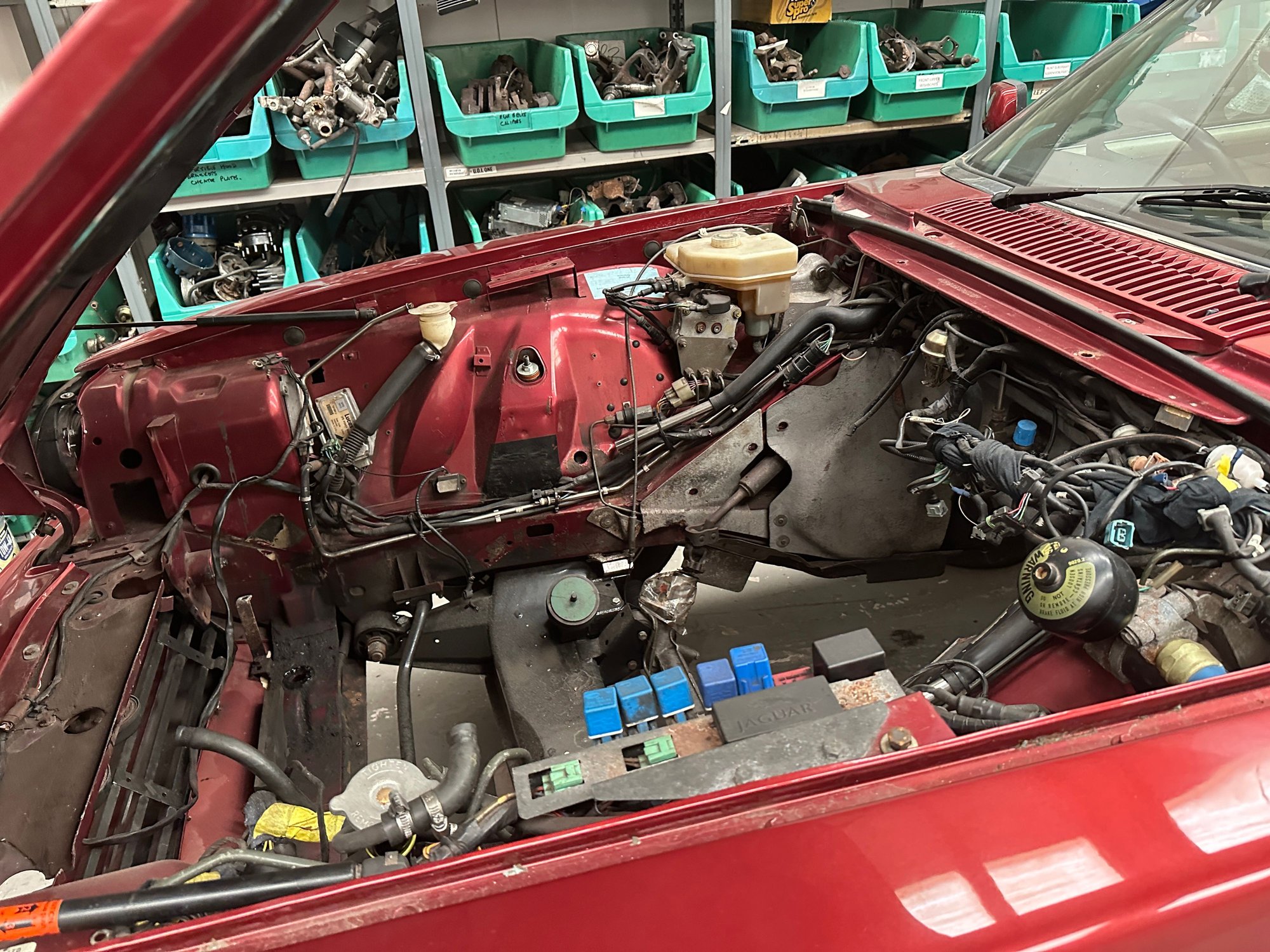

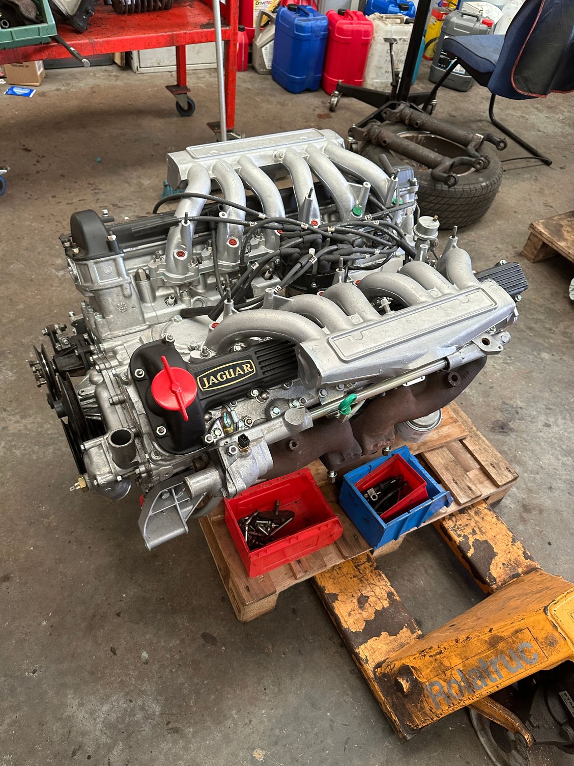

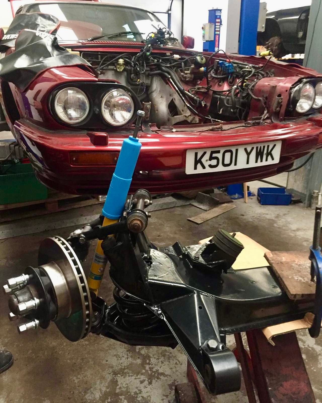

The engine is currently out and has been rebuilt by Brian Ball. There is other recent work such as a powder coated front subframe, new front shocks, new rear brakes etc etc.
I spent 1.5 hours looking the car over and could not find any real rust spots, went under the car, took all mats up, checked scuttle etc, there is bound to be something but hopefully it’s not a bad starting point. It’s also had a recent re-spray although not to a concours standard.

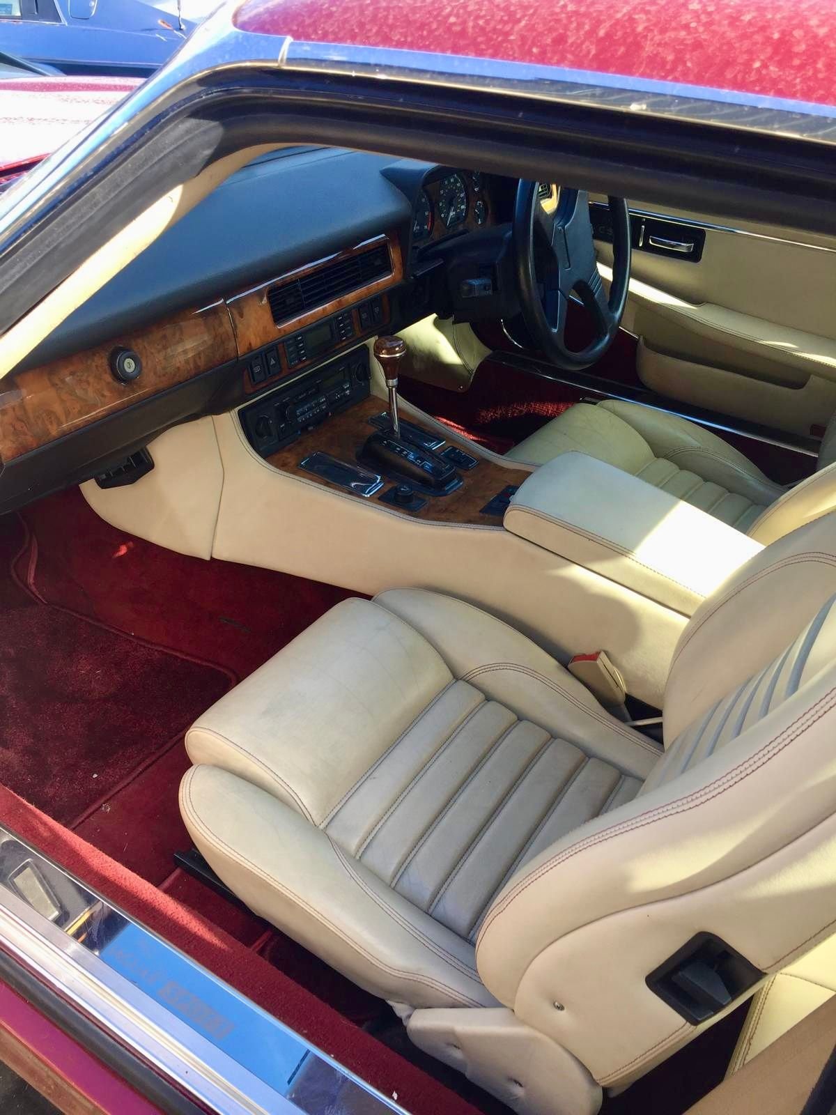

I was thinking of buying a car that was all together, but always wanted to put a manual box in and some other subtle mods so when this came up at sensible ish money I popped some brave pills and I will be slowly progressing the project.
So my plans:
  1. Getrag 290 Gearbox and conversion parts from Simply Perfromance (I have lead on one but not sourced yet, might be tricky)
  2. Ditch the Zytek Engine Management and go for an aftermarket ECU with coil packs. I can’t decide which one is going to be best. I fitted an Omex ECU to my 1966 Alfa Romeo with 2.0 Twin spark, that worked well but the local mapper/supplier no longer maps fuel injected cars as they claim they are sick of people bringing them badly installed stuff. Mine wasn’t a problem on the day i have to say, although the V12 is more complex and now we have a baby boy at home I don’t have as much time!!! Options are Emerald, Omex, Link and Haltech, of and ECU Master.
  3. Wasted Spark Coil packs using Ford 6 Cylinder coil packs and will have to make up a trigger wheel of some kind, probably a 36-1. The Zytek equipped car does not have one sadly… (it’s in the Dizzy or on the flywheel i think)
  4. Maybe go for broke and fit these sexy Jenvey throttle bodies if they will clear the bonnet. Jaguar V12 Throttle Body Kit 2 or maybe just stick with the standard 6.0 manifold and enlarged throttle bodies.
  5. Tubular Exhaust manifold, either from Simply Performamnce or Custom.
  6. Full Custom Exhaust back from the manifold; sadly probably with catalysts as this car is right on the UK cutoff…
  7. New Veneers etc inside
  8. And much more…
Anytips or advice would be much appreciated; what have people done for an aftermarket ecu, and has anyone fitted that expensive Jenvey manifold with Sucess?
That’s enough to for a starters, much more to come in the way of updates and questions!!

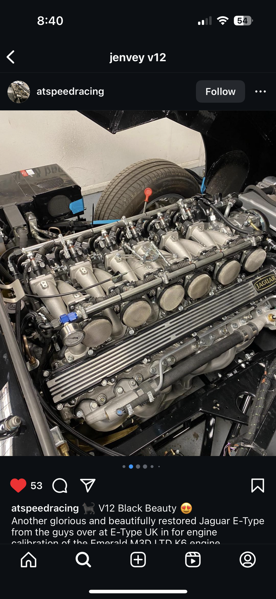

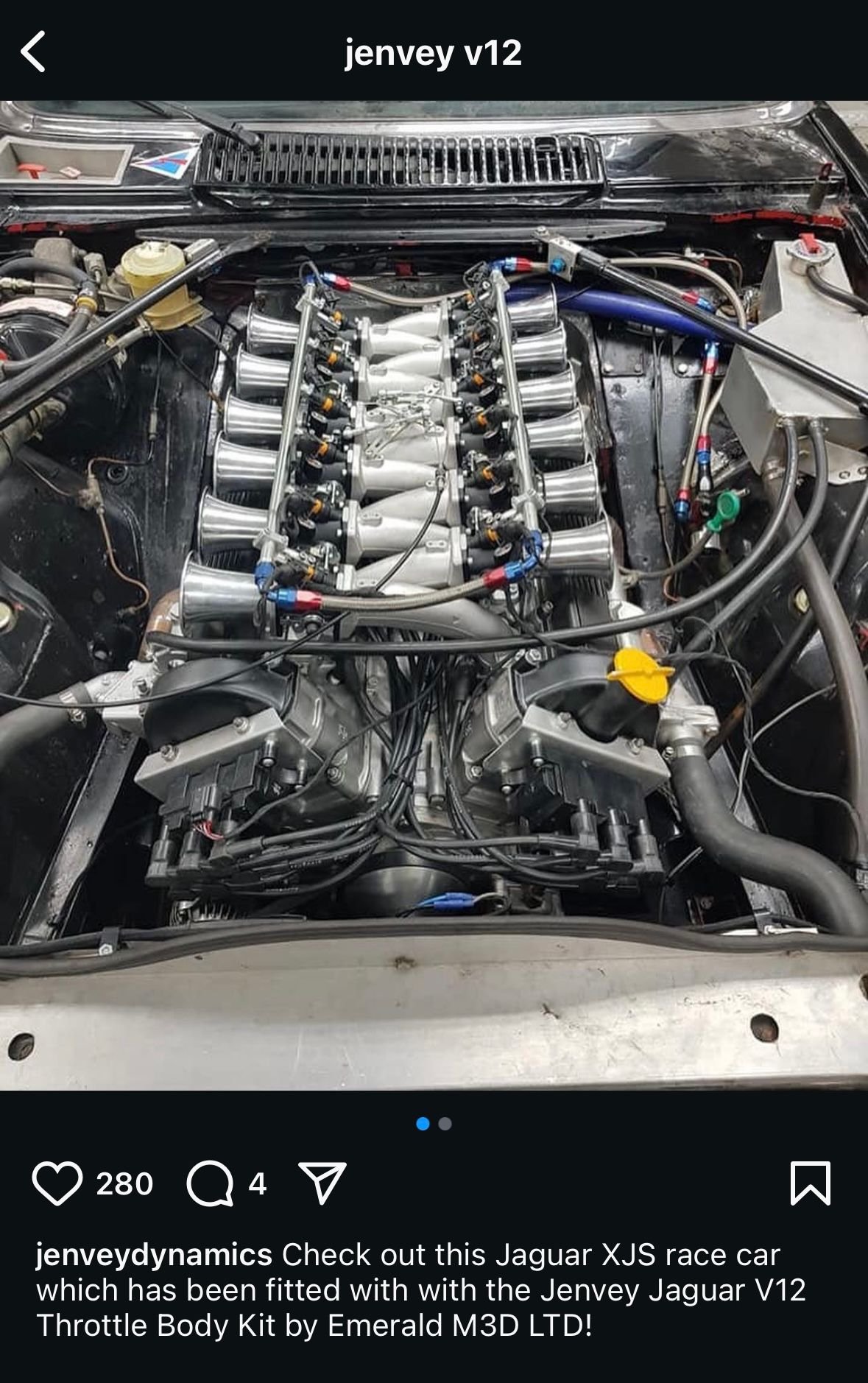

Yes the Jenvey Throttle Bodies are maybe excessive and there is a worry of losing torque, the runners are still a fairly good length by the looks of it, I’m also worried about bonnet clearance. Then there is the big cost of them!
Jenvey Jag V12
I think it’s the prospect of the sound and throttle response that excites me!
I guess the same could be said for a tubular manifold, I’m pretty sold on one of those as I think it’s a relatively simple way of optimising for a modest gain, more gains if combined with other modifications. I saw the Harry’s Garage vid where a 5.3 on Emerald Management and a 6.0 inlet manifold and a tubular exhaust manifold made 340bhp supposedly which seemed good, subtle tweaks to the 6.0 should give a reasonable gain.
I did email roger to ask if he fits intake trumpets to the 6.0 manifold but haven’t heard anything.

The main factor is the £4000 cost, not inconsiderable. The cross plane style runners of the manifold do have some length and then if there is space you have the option of trying different intake trumpets to give a longer runner length/more torque.
The manifold has mostly been fitted to fancy Restomod style E Types, and a few of which seem to have a 6.0, so I bet someone has a synopsis comparison/power curves that could be compared. E Type UK seem to do a lot of them?
I think tow 70mm (or whatever size larger than the standard ones) throttle bodies and enlarge the flange of the 6.0 manifold should be more than sufficient. The XJR-S air boxes and cold feed pipes on the facelift do seem like quite a nice setup.

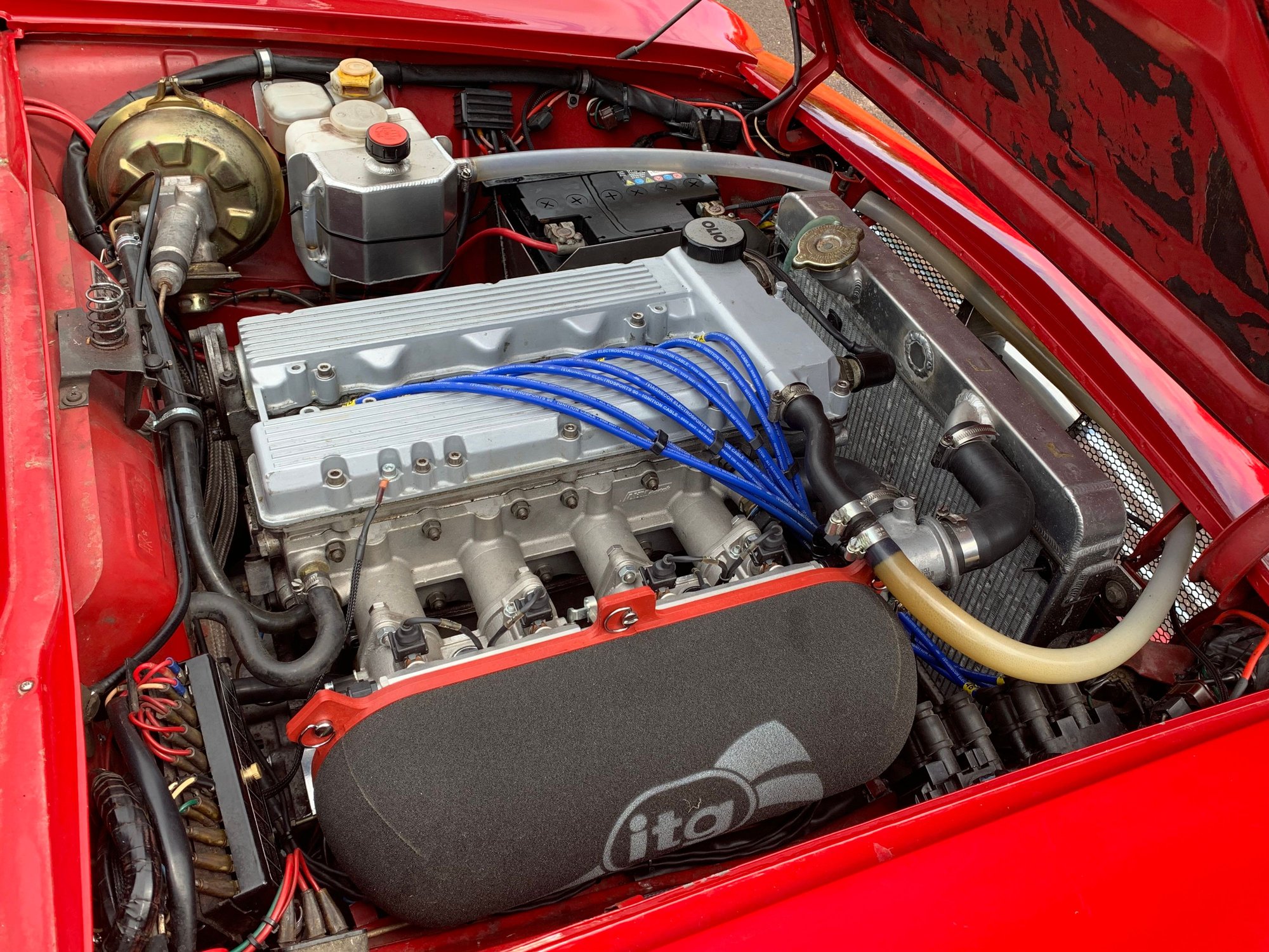

Found a couple of photos of an XJS racer and then an E Type installation. Another compromise is that there is not proper air filtration, just a filtered gauze that from memory is quoted as 80 micron or not very fine.
