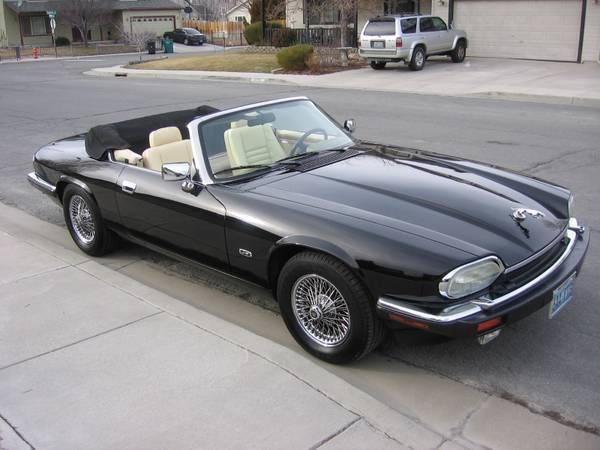

Just bought this beautiful car. Previous owner did not drive it much and it was garage kept. My question is that should this car be driven fairly often. There are a couple little issues but passed smog and is driving fine. Just not sure how much to use it. It is not my main car.

If the car was infrequently used, check to see how old the tires are. Check the condition of the sidewalls looking for cracking. If you have a recent service history you can get a better idea of the condition of the car. My advice is the drive the car regularly. Not just a five minute jaunt to the store but for twenty or thirty miles at a time. Get the motor and transmission thoroughly warmed up, This will also keep the battery charged up. This will give you a better idea of the shape the car is in. I'm not saying that you can never run down the local Starbucks for a latte. just that these short runs should be balanced out by regular longer runs. Sitting and infrequent use doesn't help any car.
That's great looking car, enjoy it as much as you can.
