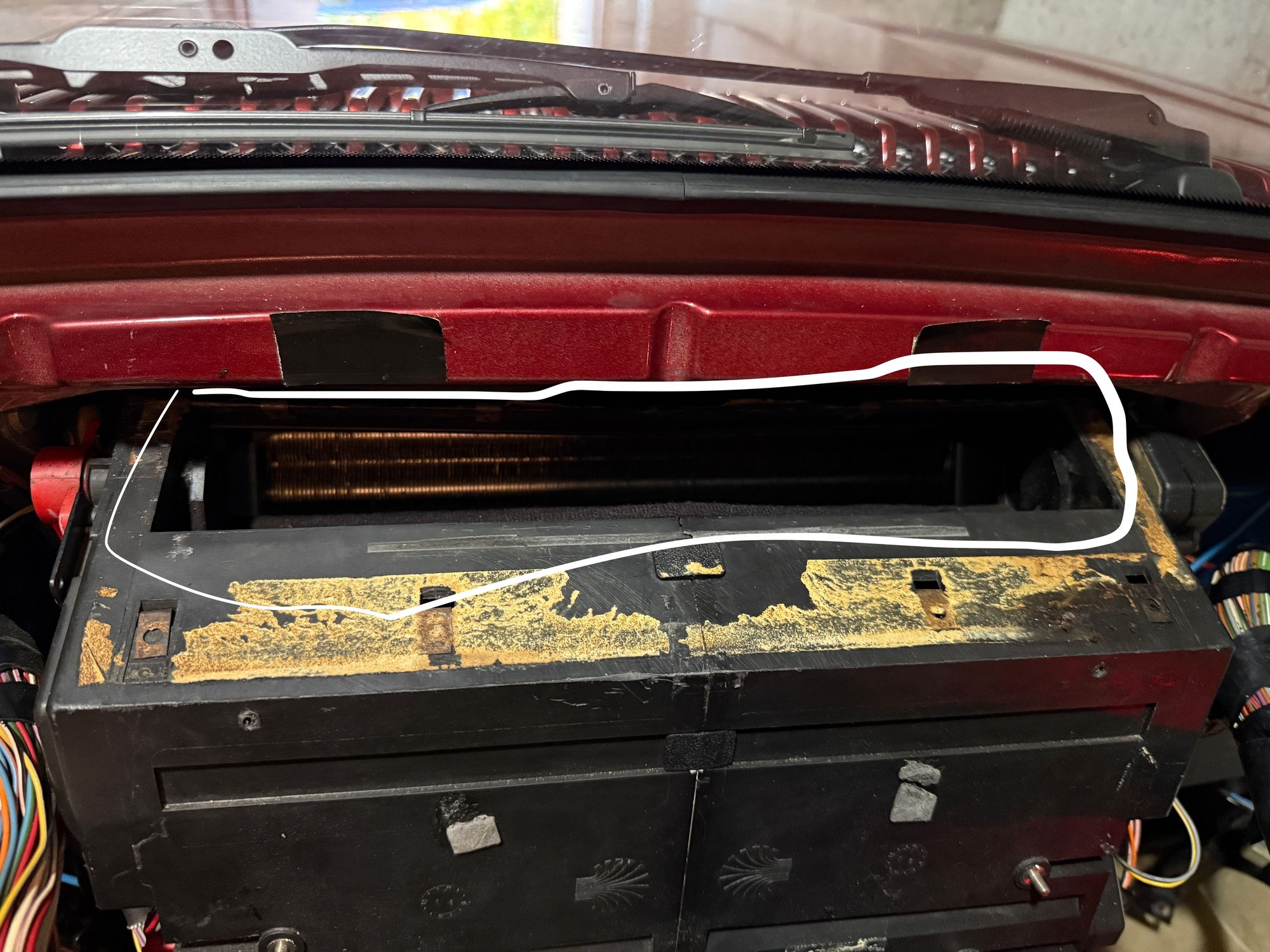

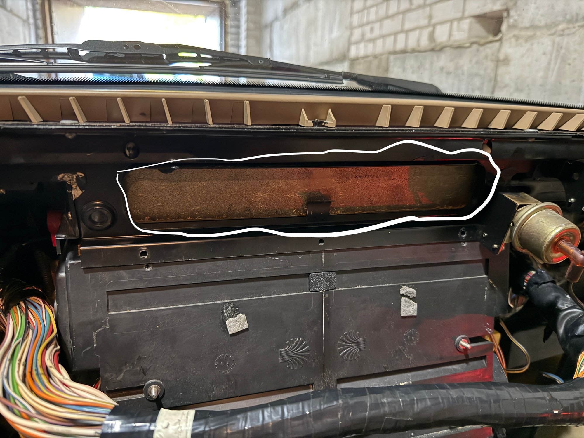

Guys, maybe we have Late 1994 delanair system pro's here.
Upper part of blower seems not be operative as it should - nor internal blower regulator motor is working (Although itself it's working separately) nor upper blower flap is opening and closing correctly (physically/mechanically works fine).
It seems like the system is not controlling upper part at all.
Blending on footwell part works absolutely perfect - cold or hot if required comes as requested.
Any help?

dear @Jagboi64 and @baxtor - air circulation went is always in COLD position (open only for cold air). I've checked the motor separately - it's working. But it's not working while connected in the car.
All foam is cleaned.
Center air went is not opening as well.
Seems more like electric problem...
Although as mentioned - bottom air circulation (Footwell) is working absolutely fine.

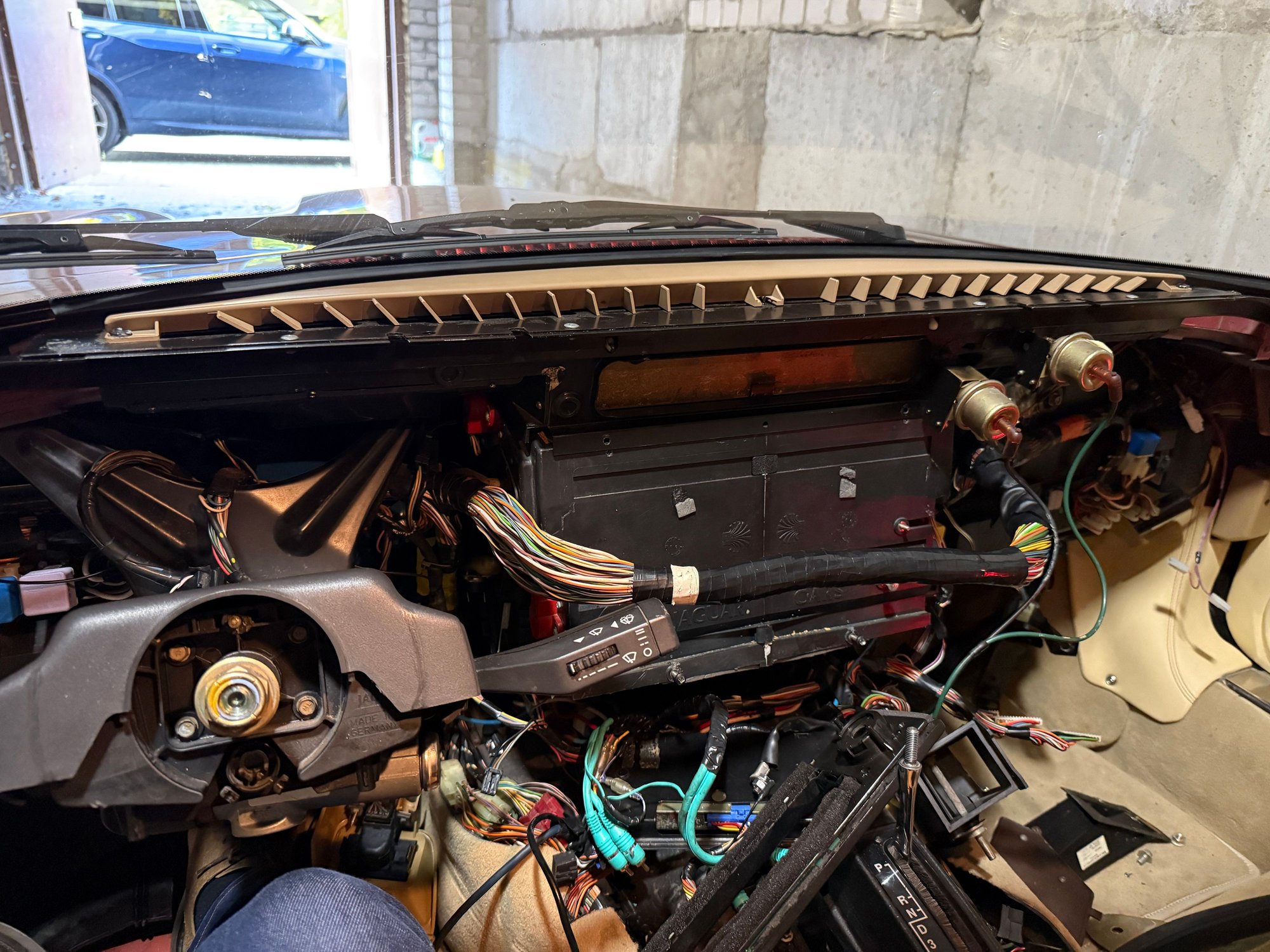

Previously i've fully rebuild this box - new AC condenser + new heater matrix. Maybe during assembly i've wrongly installed the upper flap and thus it's working incorrectly.
