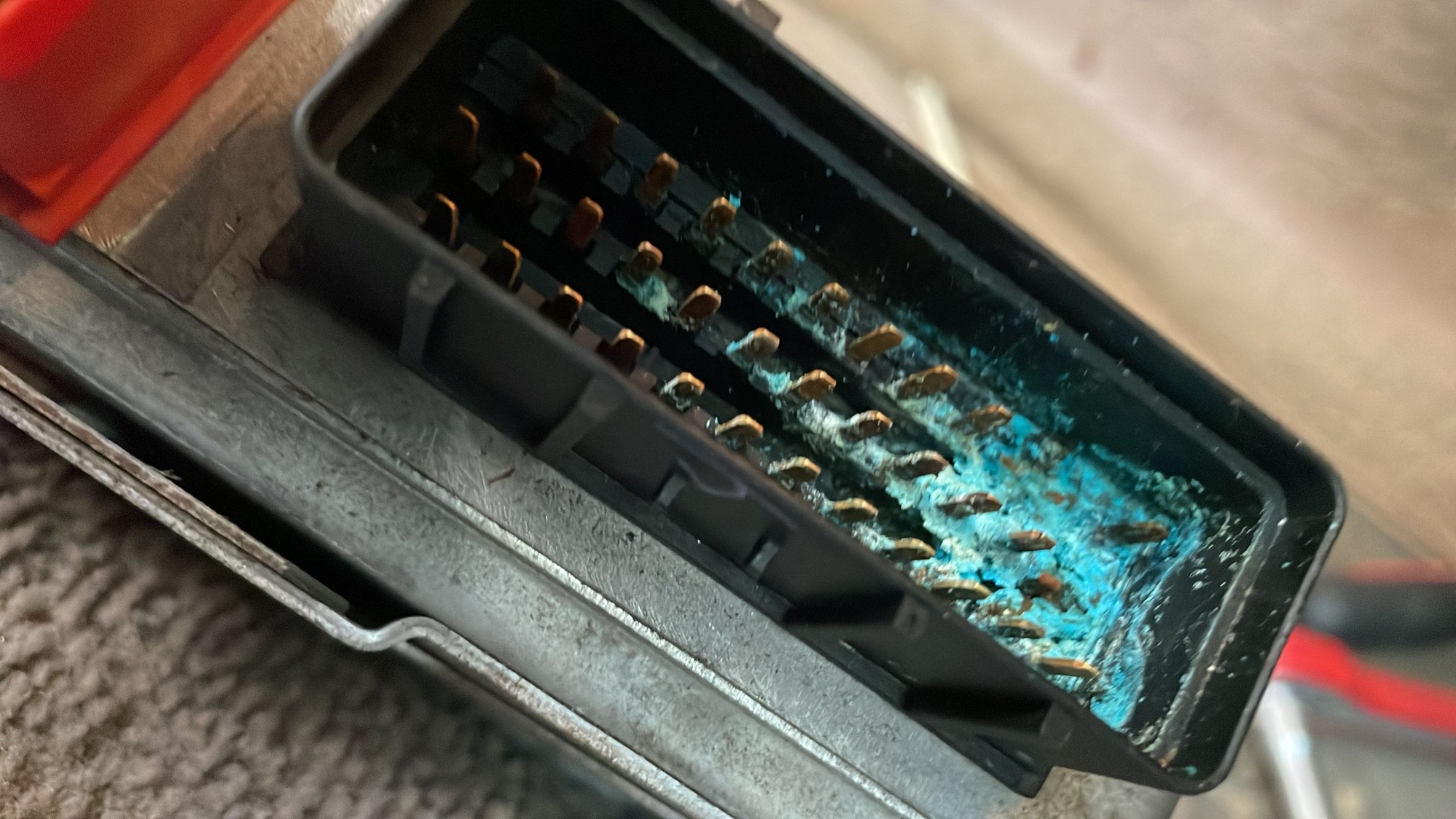

Thanks a lot all! I have found the problem…badly corroded pond on the ecu.. some pins are broken so I have to look how to fix it.

Great to hear, but also my connector has the broken pins in it....how can i get those out? I can't sent you the whole car ;-)

As for the problem with the pins, I believe you can buy that part. You'd have to find someone that is proficient with soldering to get the part on. You are looking for Econoseal 344108-1
Look here: https://www.corsa-technic.com/catego...ategory_id=119
(no relations with this retailer)
It can be done. I think what you are going to look for is someone that works on computers and knows how to solder motherboards and such....or maybe it's a hell of a lot simpler?

Thanks a lot! That can help repairing. Just have to find out how to remove the broken pins from the connector, is there a tool to remove the wires from te connector?

I believe you’re going to have to open the metal ECU box to expose both sides of that male connector. Once opened, you’ll most likely need someone skilled at soldering. Like I said before, someone proficient in customizing computers would probably make easy work of this.
You’re more replacing individual pins, but the entire 36 pin male connector.

Yes, that's the plan for the male connector but some male pins are stuck into the female connector (at the car side) and also this female plug is corroded. So i like to disensemble this female plug to get rid of the pins and clean the connections....will this work with a tool like this?

I can't be sure. I forgot what I used to release the pins on the female side...which is part number 344111-1 (if you're interested in replacing that part)
See these parts. You can reuse the plastic plug and only swap out the female connectors!
https://www.corsa-technic.com/item.php?item_id=623
https://www.corsa-technic.com/item.php?item_id=620
I think all I used was a small jewelers flat headed screwdriver.
You would need to buy a crimping tool for the female connectors. But that wouldn't be expensive. I can recommend one if you're interested.
