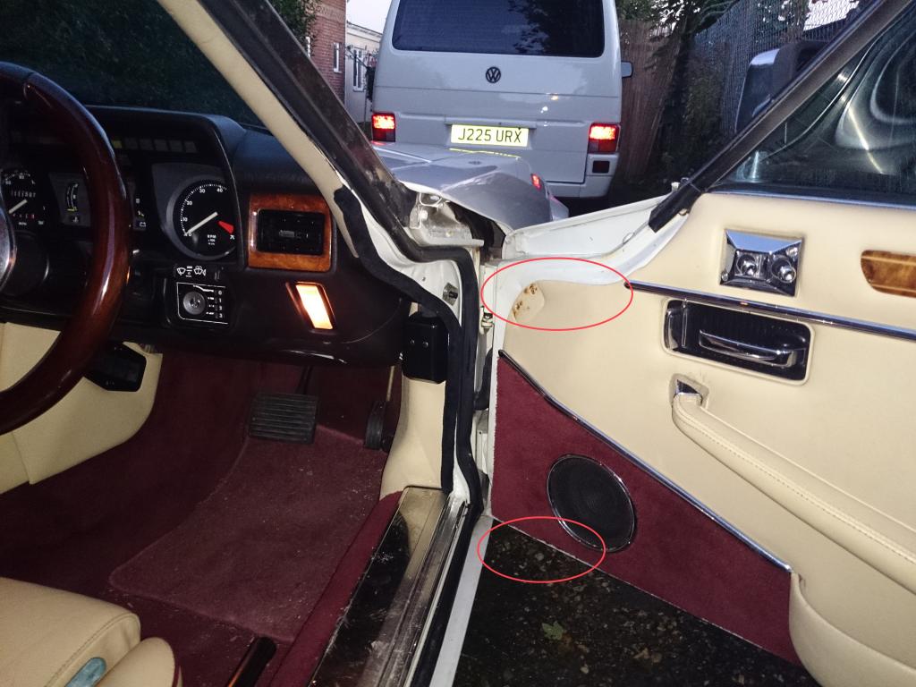

Ok, I started taking the door card off and found that a lot of it was soaked in the places ringed on the photo. It was very wet on the ground and needed help supporting the card so ended up putting it back on but is this a known issue? Any ideas where the water could be getting in?
Many thanks for any help!

The water will be coming in through the quarter window or the door seal. My quater window was quite rusty where the large screws are just in front of the mirror control. I removed my windows and the area was full of silicone so the water could not drain directly through the door.
Solution - was to remove the silicone re-fit the windows with new rubbers. I also have new door cards as these are water damaged. I will be varnishing the new door cards and installing plastic to keep water from the speaker and door card.

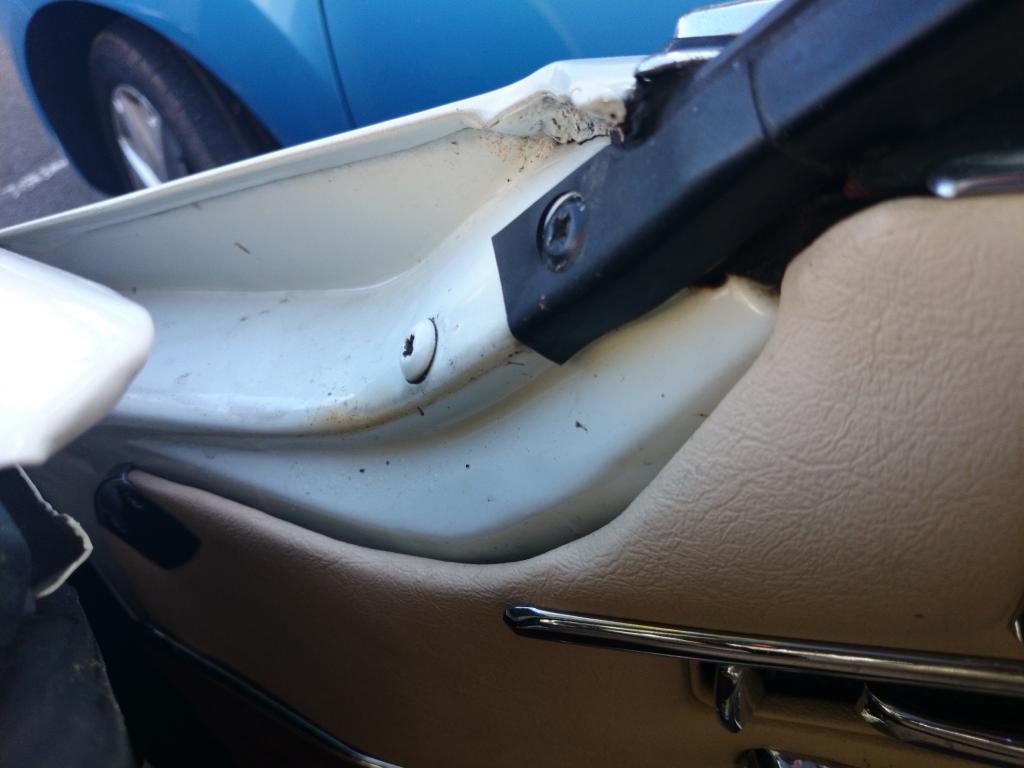

I had a similar issue. I would like to see a close up photo of the area on the door just after the gasket ends. Right in the area where that white button appears at the top of your door.

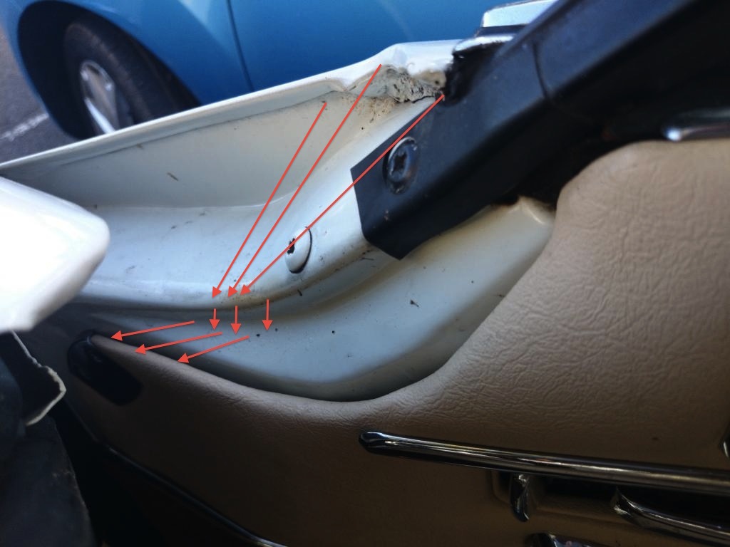

I have a newer model, so my door looks different, but I think you are missing an essential piece to help keep the water routed away from this inside of the door. I've attached arrows that show where I suspect water is going.
Unfortunately water should hug the outer side of the door, it shouldn't mosey on over to the seal, or inner side of the door.

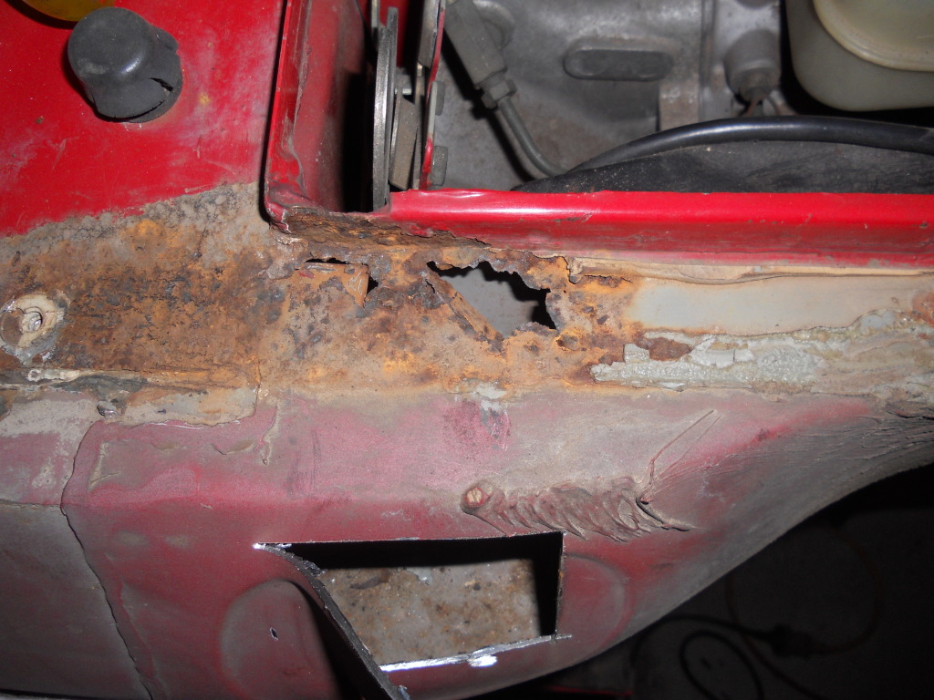

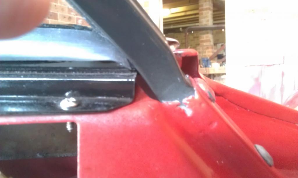

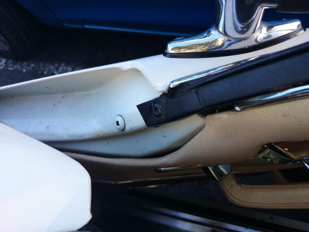

Is the carpet in the footwell or the drivers side kick panel wet? There are a few places it could be coming from. If the door seal in the area is good and well sealed the only other places are between the quarter window and chrome trim on the outside of the door, or through the front scuttle, water comes in the vent where the wipers are and if the drains are blocked can overflow into the footwell and the bottom of the A pillar.
I know this area well as mine had a bit of rust here and I had to rebuild this area on the RH side.
Does not look too bad, but once I opened it up the rust was bad and caused water leaks into the driverside lower A pillar and bottom of door. My door cards both sides are TOAST.
In the second pic you can see foam, remove this and you can see down the into the car in the lower A pillar
I used builders plastic to line the door in behind the window motor to keep any water away.

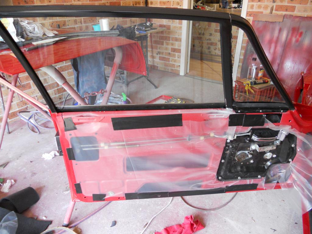

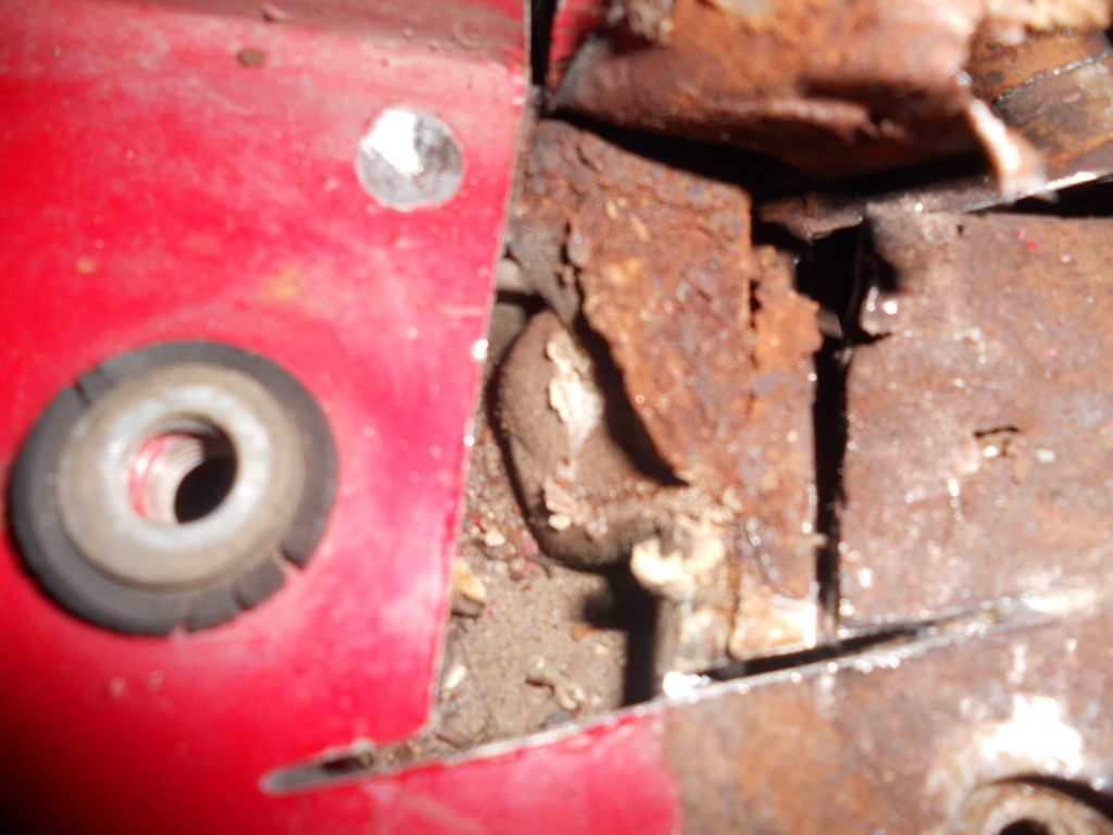

This is where the water is coming from. You can see where it has rusted the door. My door cards have been wet in exactly the same place as where you indicated on your photo. This area was full of silicone and the water had nowhere to go but down the door card. I have removed all of the silicone and will cover this with plastic and tape.

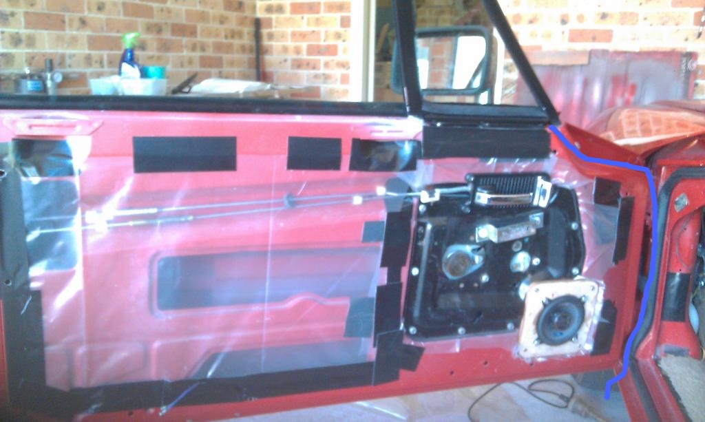

Thanks for the pictures Warren, I understand yours was blocked with silicone but where should the water be draining? Should it be roughly where I've crudely drawn a blue line?!
Attached Thumbnails 2 new problems this morning, stereo and window!-door_zps258729eb.jpg
Old Oct 28, 2013 | 05:42 AM
warrjon's Avatar
Posts: 4,638
Likes: 2,583
From: Vic Australia
No, I think that is where mine was draining when the bottom of the quarter window was full of sealer. My door cards are water damaged right down the front where you have drawn the blue line.
All I have done is seal up the small holes, you can see one where the top of your blue line is. The water can now drain directly through the door. It can not get on the window motor or the speaker as the plastic is behind them.
My theory is to allow the water direct access to the ground. If it can drain through the door and there is plenty of ventilation, it will also dry quickly and not stay moist and rust.
