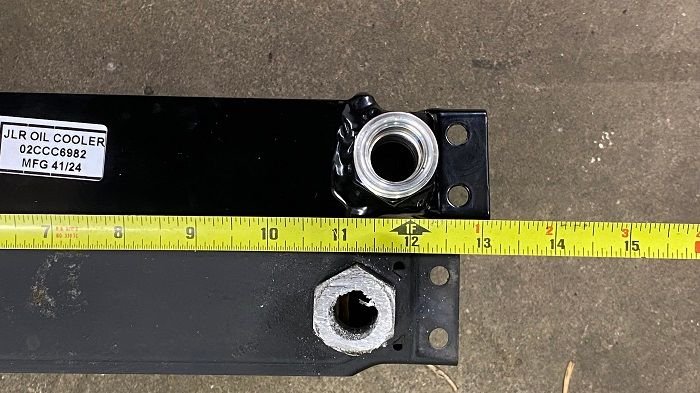

It started as the usual leaking oil cooler hoses on my 6.0 V12. I tried to take the cooler line to cooler nuts off and of course they were corroded together and I cut the cooler ports off to get it out of the car. I ordered a new Genuine Jaguar cooler from SNG Barratt, and when it came it's not the same dimensions as the original cooler - mainly the centre to centre distance of the cooler ports is 3/4" further apart. Searching further, it appears they are made by NAR for Jaguar.
I have found another one made by Think Auto, who is the UK distributor for Mocal coolers. They list one for the 3.6 XJS, but not for the 6.0. Of the dimensions they do list it looks the same, but of course they don't specify the centre-centre distance. I have asked the question using their contact form, but no response so far
Would anyone happen to have an OEM XJS 3.6 cooler they could measure? I need the distance to be 250mm.

Jagboi64,
If your car is a standard US car post VIN 188415, then the documentation says it would have an oil cooler part number CCC6982. I'm not sure why a genuine Jaguar one would now have different dimensions. Is that the part number that SNG supplied?
The same part number was apparently fitted to all 4 litre cars post that VIN as well. So maybe search for that?
Yes, CCC6982 is what the car had and what SNG supplied. Looks like sloppy QC on the suppliers part. SNG were quite frustrated with the response they got from JLR, which was really non responsive.
If you go down to OC5191-12 it looks the same as CCC6982, so I'm wondering if it will fit https://www.thinkauto.com/cgi-bin/sh...l#aOC5161_2d12
Old flat black, new is the shiny black. They were aligned on the left side.

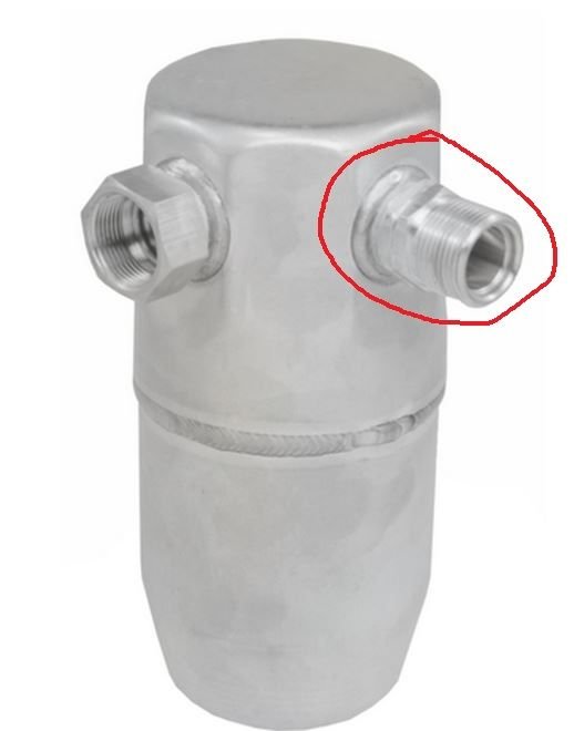

Well, yes and no. What happened to mine was the cooler was fine, but I needed to replace the hoses that attached to it and the steel nuts of the hose had completely corroded to the cooler. The cooler itself was fine and wasn't leaking.
In the end, I sawed off the stubs off the aluminum cooler and removed then to be able to get the hoses out. I dissolved the ends out by hanging the ends of the hoses with the stub ends in a container of 36% hydrochloric acid and the aluminum dissolved. It took a week, but the aluminum fizzed and turned to hydrogen. I bought the acid from a commercial janitorial supply, it's intended as toilet bowl cleaner. Look at the MSDS before you buy, some cleaners are sulphuric acid and that doesn't touch aluminum.
By coincidence, I found that a size 12 AC fitting for R12 is exactly the same end as the original cooler end. This was used on plenty of GM cars up to 1993. The later R134 fittings look the same, but the thread count is slightly different and will not work. I went to the junkyard with my sawsall and cut the male ends off of the receiver dryer on a few GM cars and then machined the ends flat and did the same to my cooler. Then a friend aluminum welded the AC fitting to the cooler and I was back in business.I also used a #12 AC O ring, and no leaks so far.
You could order 2 of these for a 92 Buick Century and cut the male fitting off. https://www.rockauto.com/en/moreinfo...choice=0-0-1-1
This is the fitting you want:
