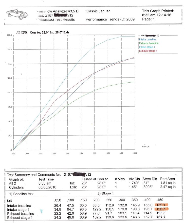

Hey I want to build a 500hp V12 ��. I had expected to find a few modern (not Group 44 vintage) proven recipes for high hp V12s easily accessible on the internet but no such luck. I’m watching and learning. It’s facinating reading all the information here including the computer modeling. My thanks to Warren and all contributors.
Below is a flow chart for heads from a shop is Austin, TX showing flow for stock and modified pre HE heads. I was surprised they used such small valves. Intake 1.74 and exhaust 1.45. Also shows cam lift above 0.400” not doing much on the modified intake whilst above 0.400” has a significant effect on the exhaust.

Below is a flow chart for heads from a shop is Austin, TX showing flow for stock and modified pre HE heads. I was surprised they used such small valves. Intake 1.74 and exhaust 1.45. Also shows cam lift about 0.400” not doing much on the modified intake whilst above 0.400” has a significant effect on the exhaust.
longjoun; because the JAG V 12 is not a performance engine, its a docile street engine, that does not lend itself well to performance mods.
may i ask who in Austin TX, has done those flow charts??

Ron, Classic Jaguar in Austin. 5k per head but you may get a discount if you order two... Are you now Austin based?

The base line flow in those head does not look right to me. When I flowed my heads flow dropped away after 10mm 0.400" lift due to port sizing so the increasing flow to 0.450" lift looks wrong, unless the heads already had larger ports.
If you want 500hp talk to Norm, he has built many 500+hp NA V12's and knows what is needed. You will need flat heads as the valve diameter is limited in the HE.
Basically the biggest intake valve you squeeze into the head 95mm, bore also increases the max valve diameter. You will need to rev to 7500rpm to make 500hp.

Could the difference with your heads be because these are flat heads?

I wouldn't have thought the intake port and bowl were too much different from the flat head but as I've not measured them I am not 100% sure.
The intake runners are the same diameter and the pinch point at the valve guide is what restricts flow. Ideally you want flow to peak just above max valve lift which is what my heads do.
In fact they flow the almost the same at max lift as they do with no valve. I did this just to see what happened.
You can make +500hp with HE if you go FI, otherwise you will need flat heads and BIG valves. A 5.3L will make 500hp with twin turbos and very smooth power delivery.
