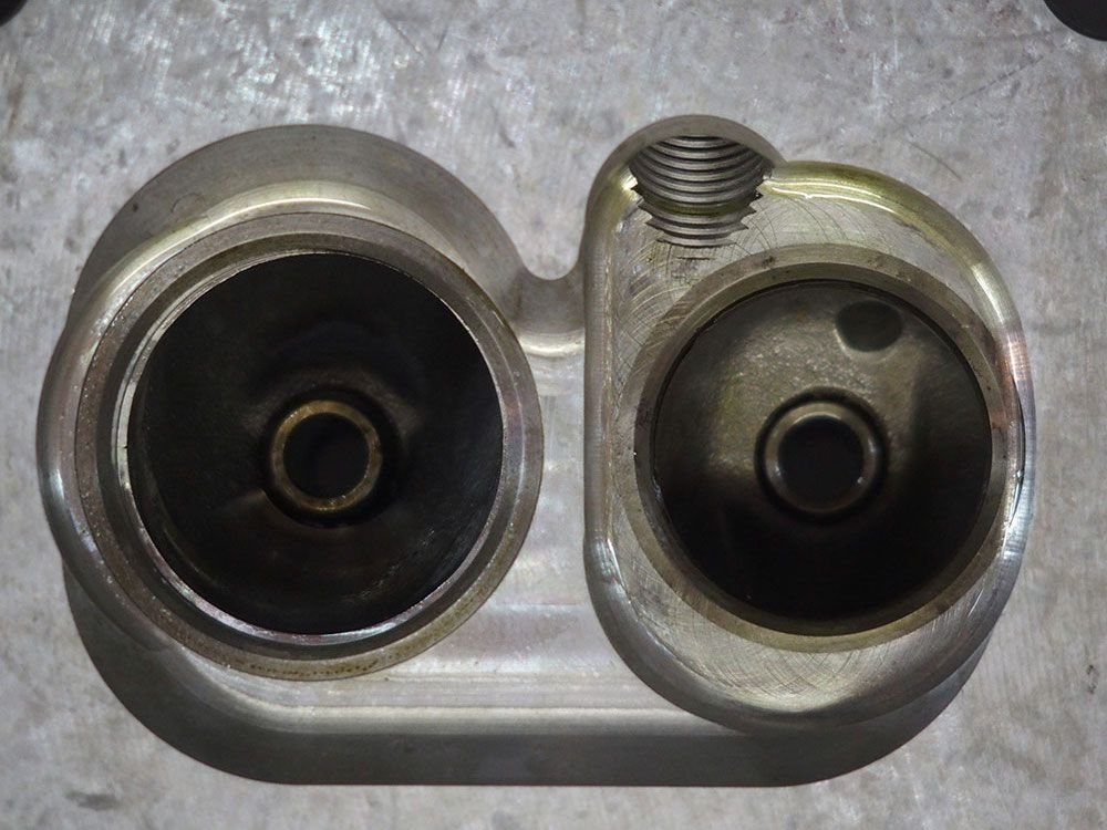

Evidently widened out to unshroud the valves some
