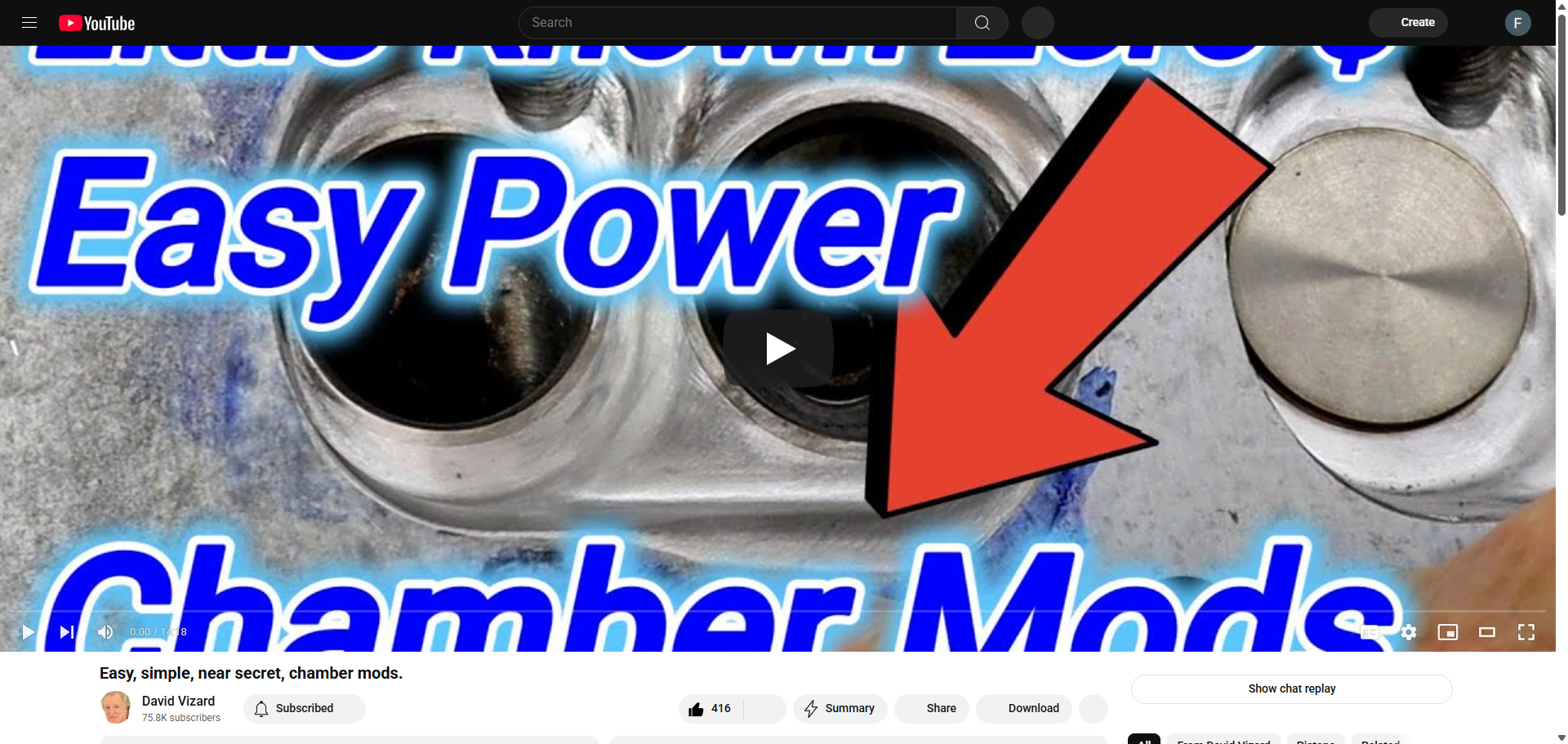

Seems like the right old threat as a place to drop this:
Never thought Id' see David Vizard tackle the V12 combustion chamber, but there it is:
~PK
https://youtu.be/Nz4cmBbzowQ
~PK
Great! I'll have to take a look for sure. His work is very respectable with a lot of out of the box thinking that goes against the norm. Did his spark plug mod on my 6.0l and had to adjust the idle down 50 rpm. Thanks for the post.
Do tell on the spark plug mod.
