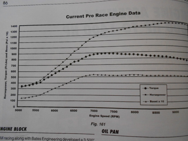

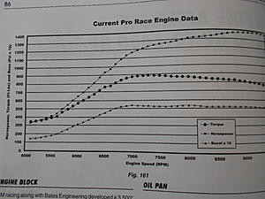

LongJohn, here is an XJS , with a 4cylinder turbo engine, it has traction problems tho!
also dyno graph , engines are available from GM performance !
