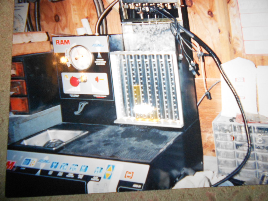

that is true, but cold hi boost air is much more dense, so friction of the injected fuel breaks up into smaller spheres.
which is good , but we are not having any boosted air!
a little known fact is fuel when injected at a certain pressure, for each full bar pressure increase the size of droplets reduces around 50% .
imagine the size droplet for a DI engine with 2000+ psi FP!!
pic of my injector test bench , Amazing what you can learn ,when you have time and patience, to PLAY with things.
