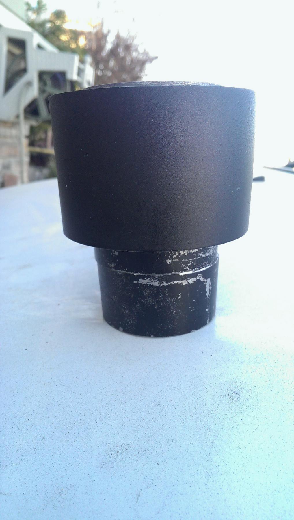

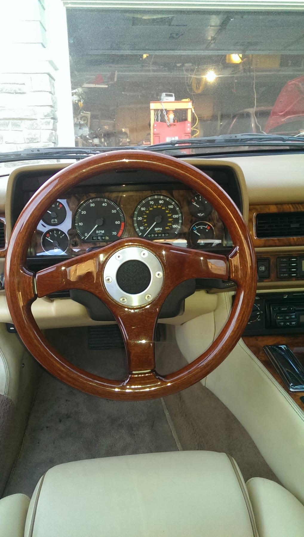

Well what do you know, the 76 spline was already adapted from the shaft so is the same as an earlier XJS shaft. I was able to cut the early hub adapter down and it fitted on to the 95 shaft fine.
I added a turn cancel block on the side of the hub for the cancel function and shaved the console size to fit the hub
The only thing is that I have not yet worked out a horn wiring as the original had a sliding slip ring.
This Nardi wheel can be set with either a wooden Center or Metal spoke
