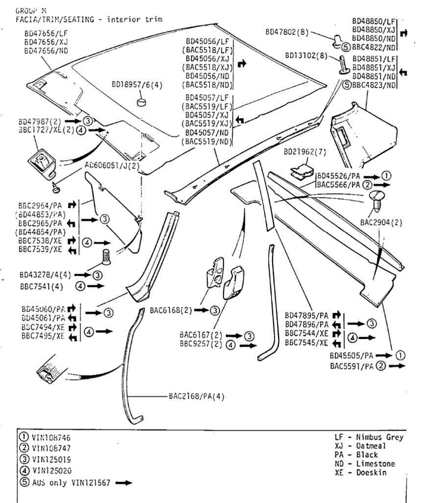

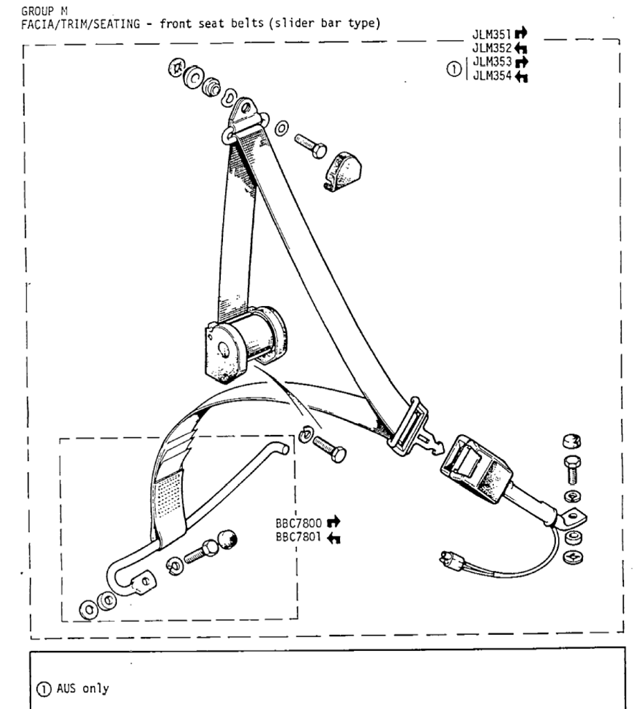

I can take some pics tomorrow but it is too dark right now. Perhaps if you get some pics of your install we to the East may be able to provide a list - I suspect it would be new cant rails and roof lining but I'm not seeing anything that would confirm, my parts book does show the different belts though. In addition you'd need the belts of course, I don't think you would need the belt clasp in the centre of the car and there are several trims so the trim code of the car would help. When I replaced my roof lining I got all the sundries as a package so the cant rails, rear pillars ('C' pillar) all came with the lining - I think the A pillars did also but can't remember.
You would need the rail that mounts at the bottom of the car nr the floor too.

OK, I now have the A and B post finishers, the cantrails, the seat belts, the coat hooks for the B pillars.
If possible, please post a picture of the lower anchor point in the lower back seat wall. I've looked around online but found no decent photos. My suspicion is that I need some kind of rear trim piece that hides the retraction mechanism that gets attached to the lower B post which has a slot from which the seat belt feeds.

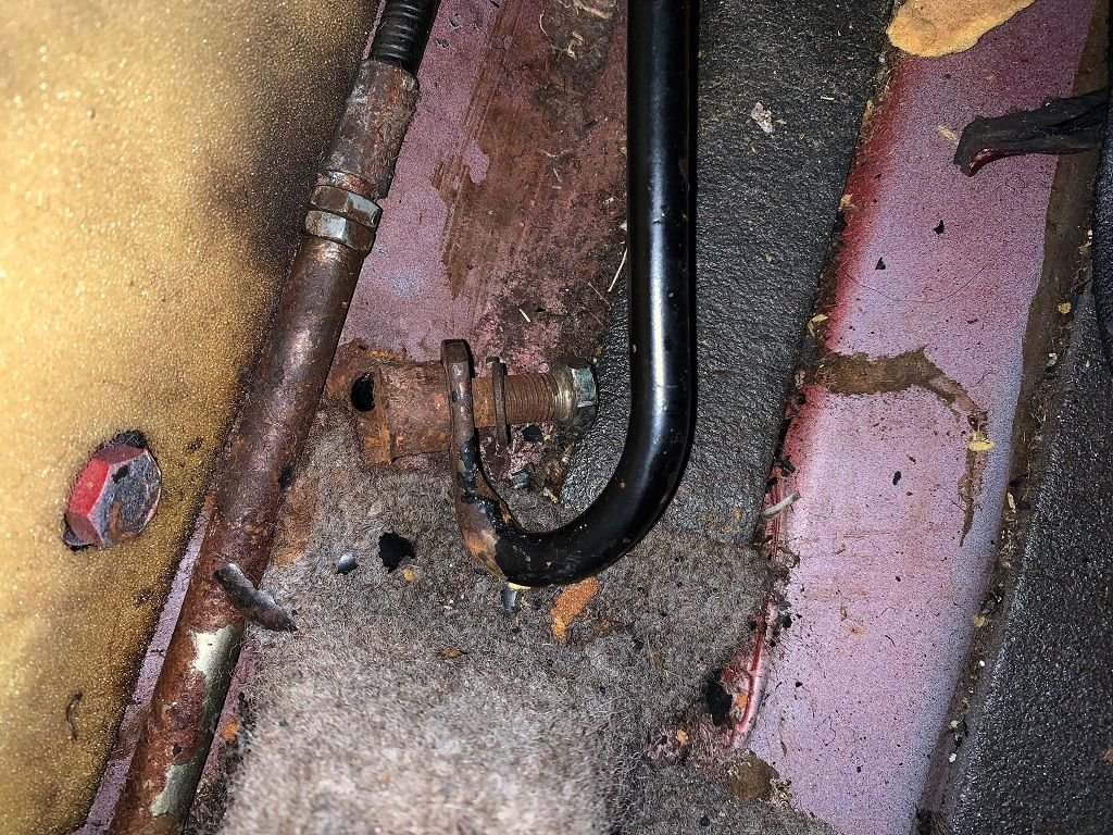

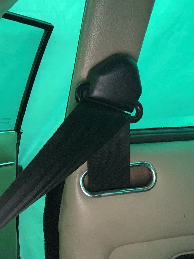

I am not terribly sure what you mean by the rear back seat wall. I wouldn't have expected the lower mounts of your belt to be significantly different - I don't know if these help.
B Pillar into the rear trim. There will be the autolock spool in there retained by one large bolt, there should also be a spacer - there should be a spacer on the bolt for the B pillar too.

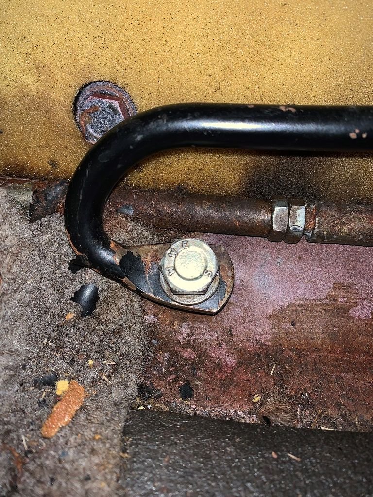

This is where the lower brace bolts to the floor, it too has a large spacer under it
This is said bolt and spacer. There is no rear bolt, the bar just slides into a hole beneath the seat - I can't easily get in there presently but if that's what you need to see let me know ( I've destroyed one too many decent shirts grovelling around this car )

Perfect and thank you for taking the time to post pictures.
It looks like I continue the search for parts as my back seat armrest panels do not have that finished chrome piece from which the seat belt spools. I may just source that chrome slot and cut the holes in my existing panels (since they are still in great shape). Finding panels in their conditions would be tough.
