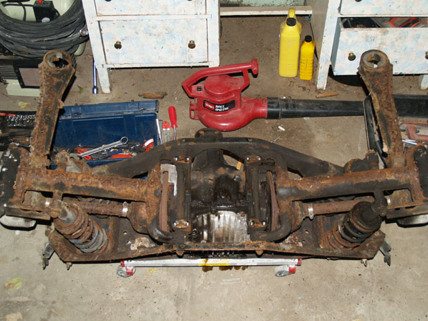

Well guys, The cage is out finally.
Young John & I are going to dis-assemble the cage this evening.
I have pictures of the cage from last night so as soon as I get my camera hooked up to this thing I will post them.
Peace
Neil

a big turtle.
