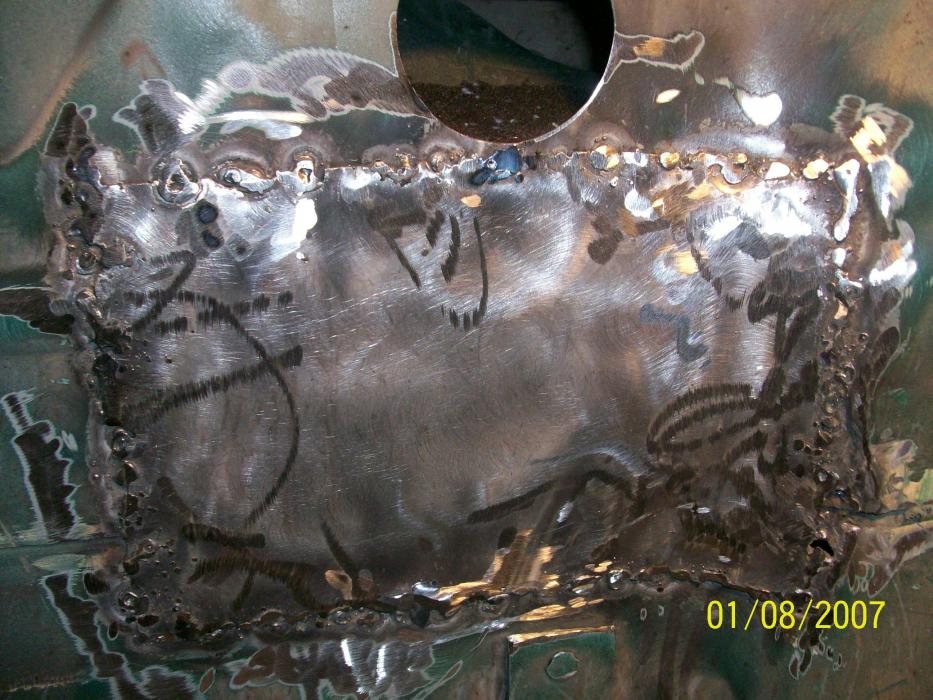

finally managed to remove the gast tank...
I have attached some pics showing the welding (amateur - spll?) and the piece with the first coat of primer...
I think I will apply 2 more coats, then some seam-sealer and finally some paint...
While I have the tank out.... what should I check for? the top-end connection of the fuel lines look kinda rusty, but the rest look ok.....
