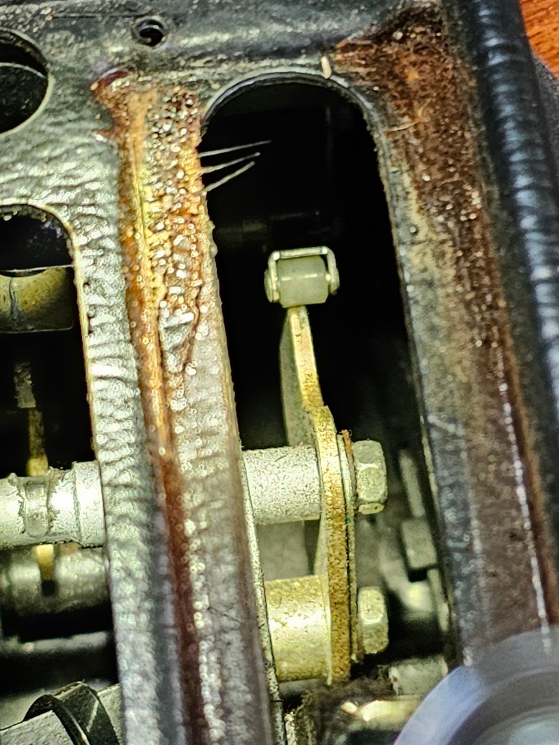

Originally Posted by equiprx
Try giggling the Shifter, there is a neutral safety switch.
I am going to hazard a guess that the white roller is part of the nuetral switch. I stuck a screwdriver in the opening and activated the switch a few times. The car did start finally, but I don't have 100% confidence that I found the root cause.
It appears switch replacement is a bit of a nightmare, disassembly of the whole console

When i bought my 93 it wouldn't turn over or start. Long story short, it turned out that the trace in the transmission rotary switch had fried, making it to where the car never knew it was in park or neutral. I soldered a bridge, and it has worked perfectly ever since!
