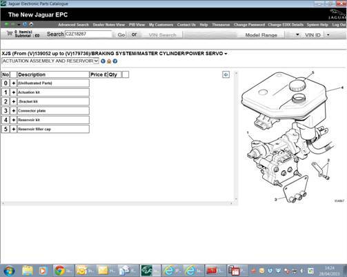

Hi I've just been through the same problem myself and was unable to locate any Spare Parts for the Valve Block in the UK, as what I wanted was the Flat Rubber 'O' Rings.
In the very unlikely event that you find a repair Kit it would probably set you back £300-£500 (UK)
While a complete ABS Actuator, IF you could find one would be about £2,000!

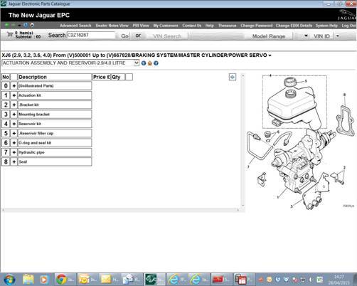

The Valve Block from an XJ6 may be exactly the same in which case it may well use the same Valves.
But as I do not know for sure, its best to check with a Dealer.
ABS on an XJS

ABS on an XJ6

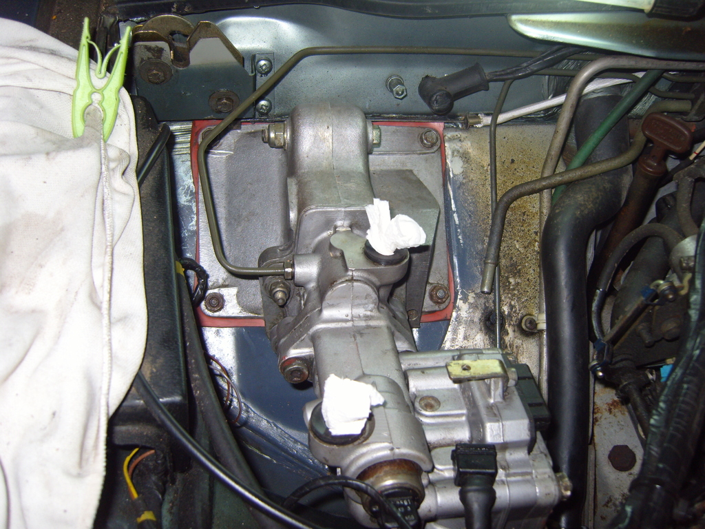

Instead I reused the old ones as they looked in pretty good condition but as for whether I've managed to fix it, there is only one way to find out!
Its all back in the Car now, so apart from putting the Reservoir on, which is a very easy job which I'm leaving to last minute, all that's really left to do is to jack her up and bleed the brakes.
