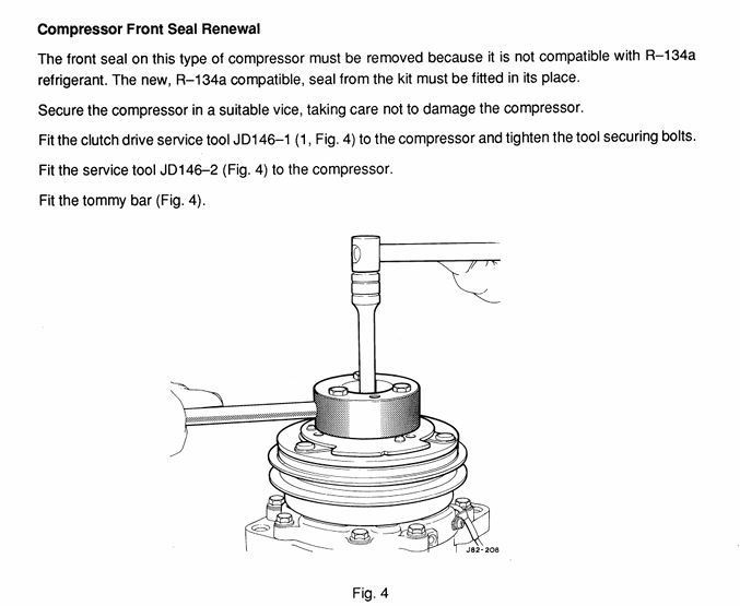

There is oil on the air con compressor pulley, it gets slightly wet. After looking at the air con info just posted I noticed that the front seal can be changed... and this is likley to be the reason?

From the TSB 82-39a
It is necessary to replace the
input shaft seal of the Sanden compressor with a seal compatible
with the R-134a refrigerant and oil as described in the Technical
Guide. Harrison compressors do not require replacement of the
shaft seal.

I wonder if I remove the compressor and take it to a Jag shop who have the tools, how much they would charge to change the seal?
Looks to hard for the average home mechanic without special tools....
