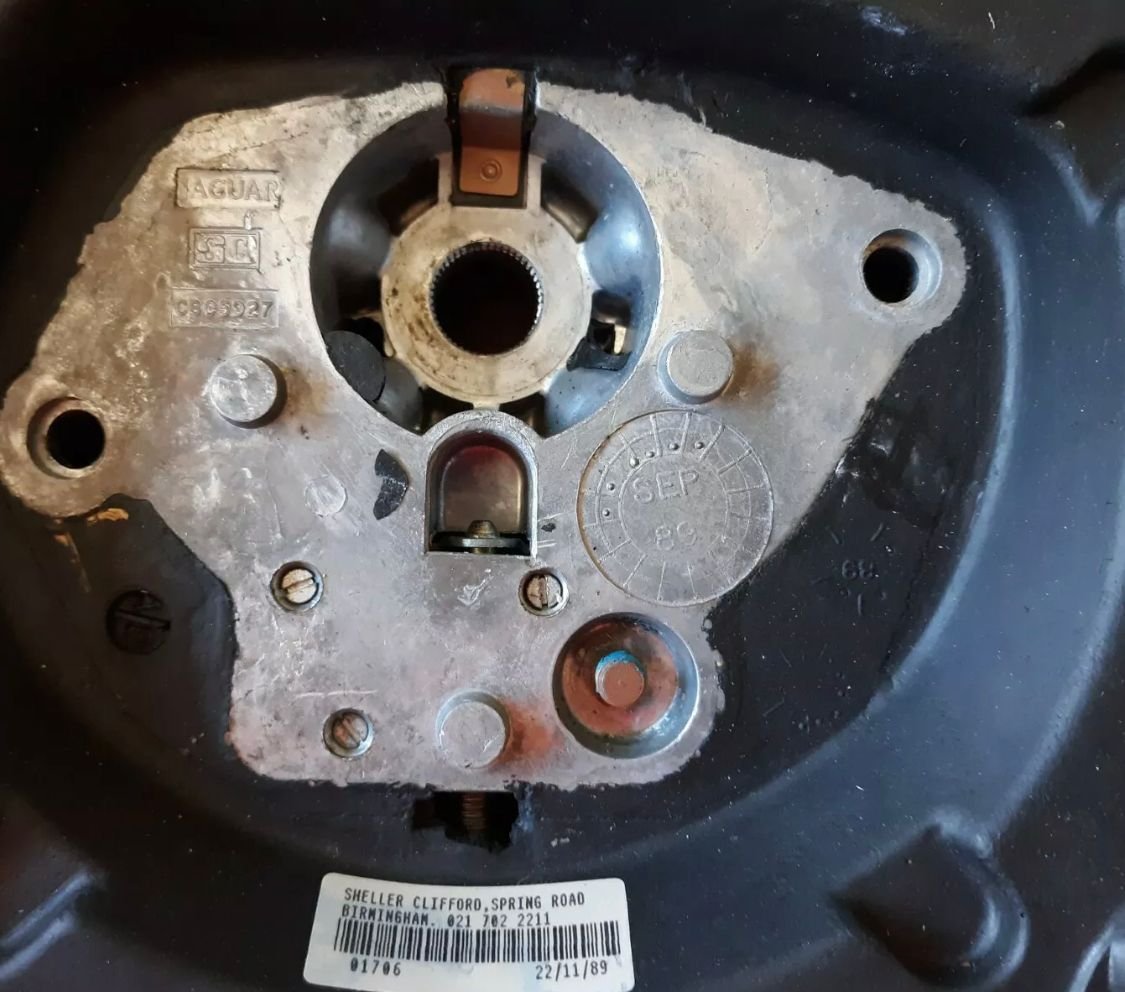

Can you show us a pic of the inside face of the wheel with the absence of the spline number?

Thanks Paul:
this is a photo-

aMArk,
Now that is interesting!
It does seem to have only about 52ish splines! And it is a US Airbag wheel (position of top right bolt hole). Perhaps Jaguar didn't use the 76 spline adapter when airbags were first mandated in the US? And maybe they only did it when we got airbags in the UK in order to further differentiate UK and US cars (as well as the airbag bolt holes)?
So, it seems like you might need a different adapter or alternatively the top part of a 1989 steering column. I also notice that the revised Jaguar parts website seems to have "lost" the 76 & 86 adapters from their parts diagrams!? I'll contact them and investigate.

oh, that’s no good!
I though I counted 50- something splines. I was hoping this would be a drop in.......

Here is a photo from the famous auction site, you see what I mean about the "76" cast into the metal in the top right.

yes I saw. I thought they only came in the 76/86 configurations, but I am clearly wrong. Well, for 30 bucks at least I get new horn buttons. Mine are faded and ugly. I hope at least those work

Looking at the wheel and the size of the hole its possible the first us airbag wheels fitted direct to the column. I'll have a look at a spare adapter and measure hole size and internal spines.

Got the wheel today. Definitely not 76. It’s a shame because the leather is in excellent shape
