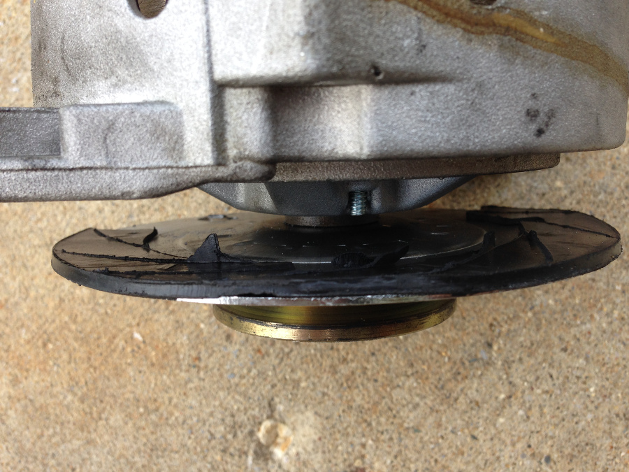

Ok, so my "new" (rebuilt) Delco 94 amp alternator gives up the ghost after less than 3 months. After pulling it out, I can see why. The entire cooling fan assembly on the front was gone. Apparently something didn't have enough clearance and obliterated the fan, thus overheating the diodes...which, on examination, I find that one of the three is bad.
So, looking towards the future, I now have another Delco 94 amp to replace it. And, I will be very careful about clearances.

I went ahead and pulled the old alternator apart, and can now see where it would be fairly easy to relocate the diode pack. See pictures.
Looks like it would just be a matter of running the connections from the diode pack out through the cooling vent holes to wherever the diode was to be relocated. Again, just don't know where in the engine bay would be any cooler.
Of more concern is why the plastic fan assembly self-destructed. I really didn't see any obvious contact points when I removed it, and the new one seems to have plenty of clearance too.
At this point I'll just assume it was a freak failure, or that it was cracked when I put it on.
