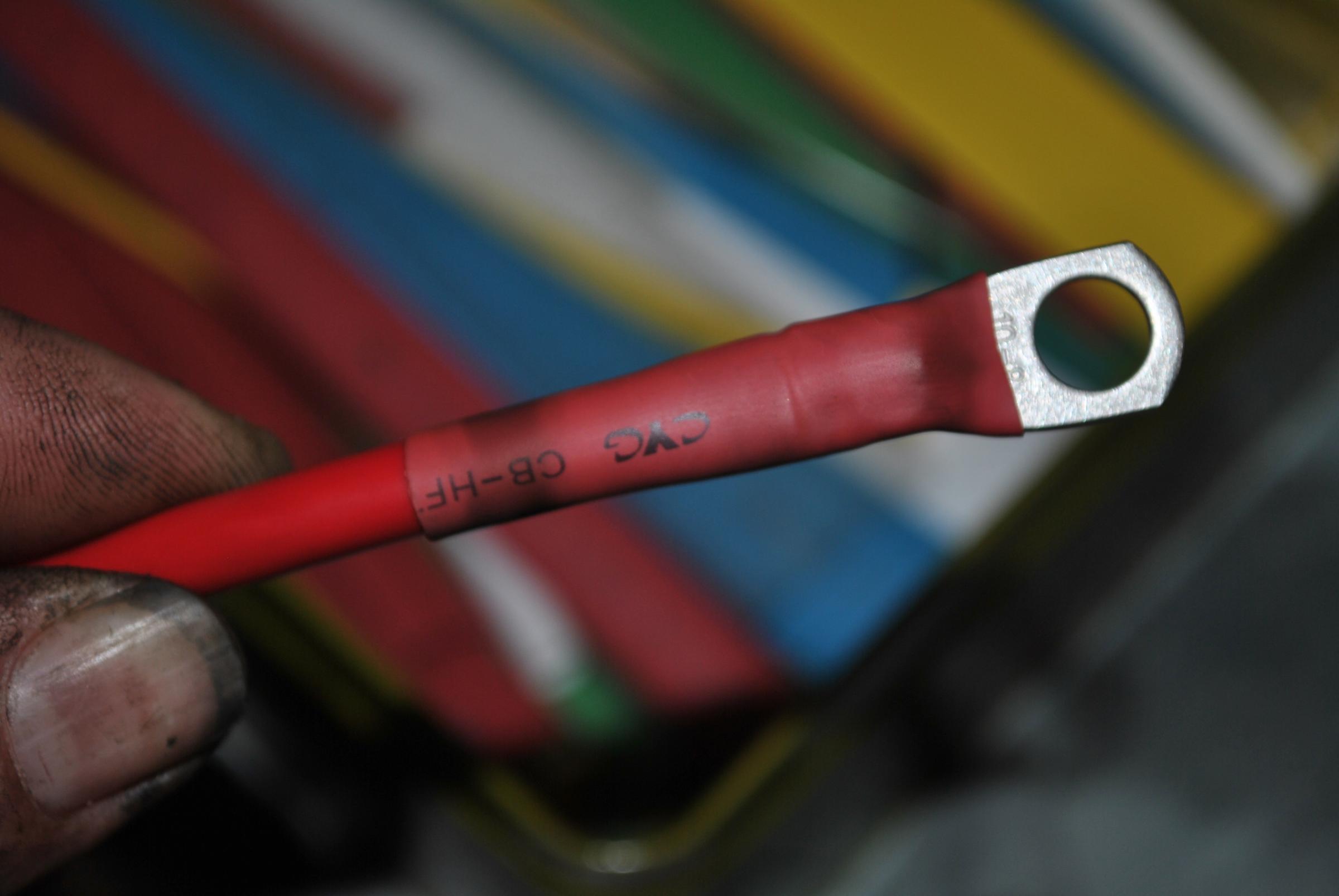

I went from 65 amp to 80 amp alternator yesterday and added the extra +ve wire. Crimped and soldered then shrink wrapped.
I bought 2 metres of cable for $7.20 (WH3060)
and 8-10mm connectors for $3.45 for 10 pack (PT4936) from Jaycar
They also have a duel black/red cable if you want to run a -ve as well.
Store Locator | Jaycar Electronics.
